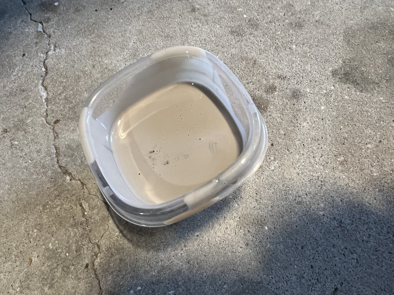

This is what I know so far he did not have a snorkel on it but that being said the engine oil had no water in it and the neither filter had that milky oil in it I do think he may have gotten it above the seats though I think he may have some how got water into the vent line going to sub trans I have changed the fluid and am going to run it for a few days see how it dose then check fluids again and flush again if nessesarry at this point it’s a done deal so worst case imma have to learn how to rebuild a trans or replace it I’m new to the sxs game I didn’t no what to look for I just trusted that my friend when he said it was a good deal I guess you can say I learn the hard way on everything lol 😂 also I just ordered the depth finder snorkel kit from super atv which has the new vent lines so excited about that I’ll post pics of the install when it comes in

I'm no expert on sunk machines (a few guys on here are, to be sure) but looking at your pic, that's not a little bit of water getting into your subtrans, that's a full sink. I don't know how you can get to there without taking water into the motor.
Are you 100% sure there wasn't any water in the oil change you did? From what I've seen around here, guys do 3-4 oil changes to clean it out.
I'd also be going thru all the steps to assure there's no water in your fuel.
Sorry, not trying to scare you or bust your balls, I just dont want to see you get hosed.
