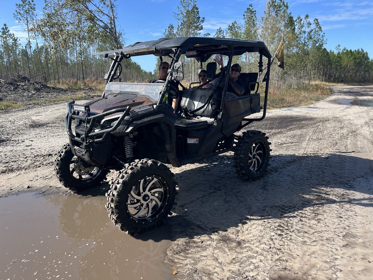

The TCP fits in the stock location. Here's a pic with the radiator relocate and a new pic now with the relocate removed and the new TCP radiator inside the stock location. (looks goofy with the small tires but I threw them on vs. big mud tires for the hatfield mccoy trip last week) I didn't try any other fans in the stock location, but the relocate kit had a new fan that it came with and it didn't change anything. I know for a fact the TCP radiator with the new fan solved my OH issues.
