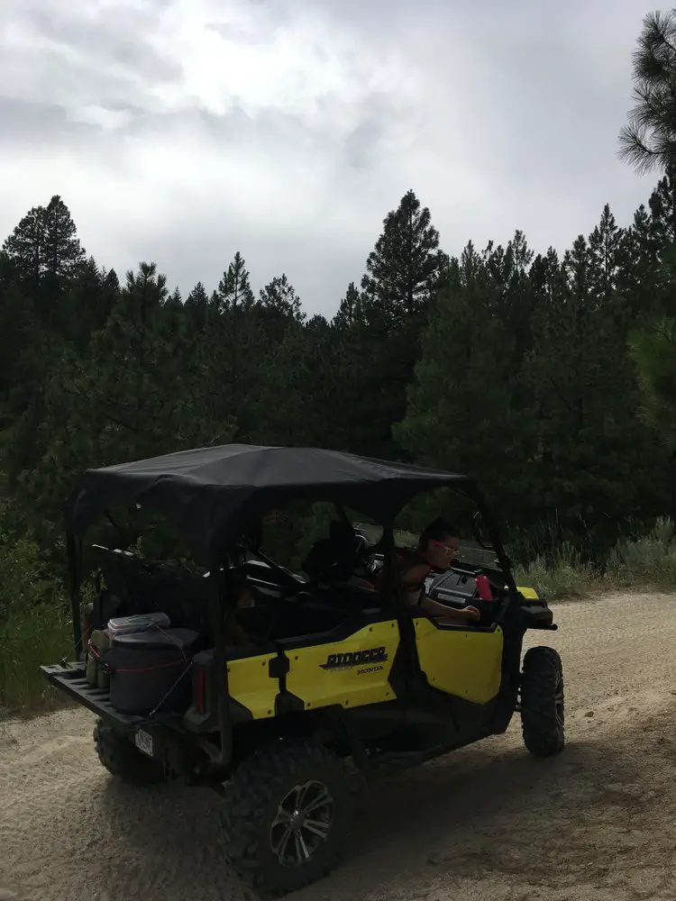

Just had this happen today. Honestly a little embarrassing, riding with a crew today and everyone was impressed with her... until this happened. This was a hot, slow ride so I know that didn’t help but damn!? I noticed the fan wasn’t on when I stopped after the light came on. Is there a fix for this!? Please help I don’t want the dealer touching my Magic School Bus anymore! She has 110 miles. Going to do a full service this week. Really look into the fan. Maybe hook it to a switch also for manual control? Does putting fans down around the motor help? That’s this winters project. Still hot in the 2018’s.....
At least we had good scenery while we waited for her to cool down.

View attachment 81107 View attachment 81108 View attachment 81109
I’m another satisfied customer again.. burped the system which wasn’t a lot of bubbles but a few. I’m thinking when I boiled over we were on a severe incline, maybe it burped there? Anyways. Took her camping this week and tried to purposely overheat her. No luck, didn’t budge off of two bars. Fan was working like mad. Cab heat was almost unbearable(motor plus 95 degree weather). Climbing uphill slow, rough and in low. 4x4 in places. Everything just worked like the Honda’s I know of. Also before this trip I did the 100mile service. Replaced diffs with 75w-140 purple and the motor, DCT, and sub-trans to 10w-40. I didn’t hear the Pioneer clatter once, at all! Everything ran tighter and smoother. We rode her hard, mostly dusty dry.. she ate it up.
Side note: I was trying to take a picture of the wife without her knowing.. she wasn’t having it lol.
