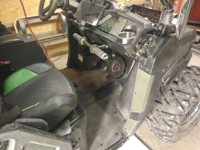

Yes the P500 is short on storage. I did the glove compartment thing which worked out well. I also added a storage box under the dash on the passenger side. It measures about 11"w x 7" dp x 3" h and the lid is screw thru some 3/4 inch spacers into the underside of the dash. The spacers were necessary to give clearance for your fingers to be able to open and close the box using the built-in swing clips. Never any complaints from passengers on clearance.

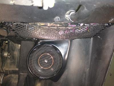

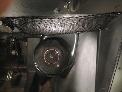

Interior storage in the 500 has always been a challenge. Cargo bag, glove box, console, even that under seat sh** :rolleyes: they all help with small items but still aren't enough. Found myself filling those with stuff and no place to put personal items when going on a ride, wallet, 2 phones, keys, cheater glasses, EDC, these are things I want right next to me and to have access to while rolling. Read in another thread where there was no room for any under dash storage in a P5 and that it would certainly hinder leg room or encroach on the passenger. So that was the goal going in, place to put stuff without confining the riders anymore than they are already. I'd call this out of the way, what do ya think? You can't even see it in this shot.
Here it is...
View attachment 238222 View attachment 238226

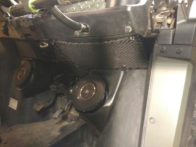

Used 1/4" rod, cut and bent to fit this area. 1/4" rubber insulated hose clamps to attach, didn't want any rattling. Four holes and four 1/4" bolts was all it took. Everything is aluminum or stainless but all got painted anyway so it won't rust. The only unknown is how the net will hold up. Bought the best stuff I could find at the time but stumbled onto, what I think is, better stuff yesterday so I ordered it. Now that this one is in it would probably hold up fine, pretty stout but if I can get better stuff, quality takes precedence.

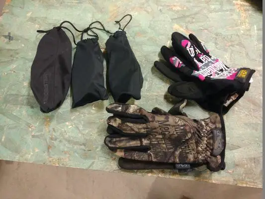

As for the amount of room, this ended up being about 15" wide and about 7" tall. It's not just a flat wall behind it either, there is a void and with the angle of the net gives about 3 1/2" at its deepest point. Here's a pic of what I've put in there already.
Three pairs of glasses and a couple pairs of gloves are fitting comfortably, the net's barely flexing.
No doubt more could be stuffed in there if needed. I don't plan to carry anything very heavy or sharp in there, don't want to cut the net or stretch it out too bad over time. What started out as an adventure in working with plastic and it going horribly wrong, turned out to be a fairly simple mod. Decent amount of storage without taking up any useful cab space.
