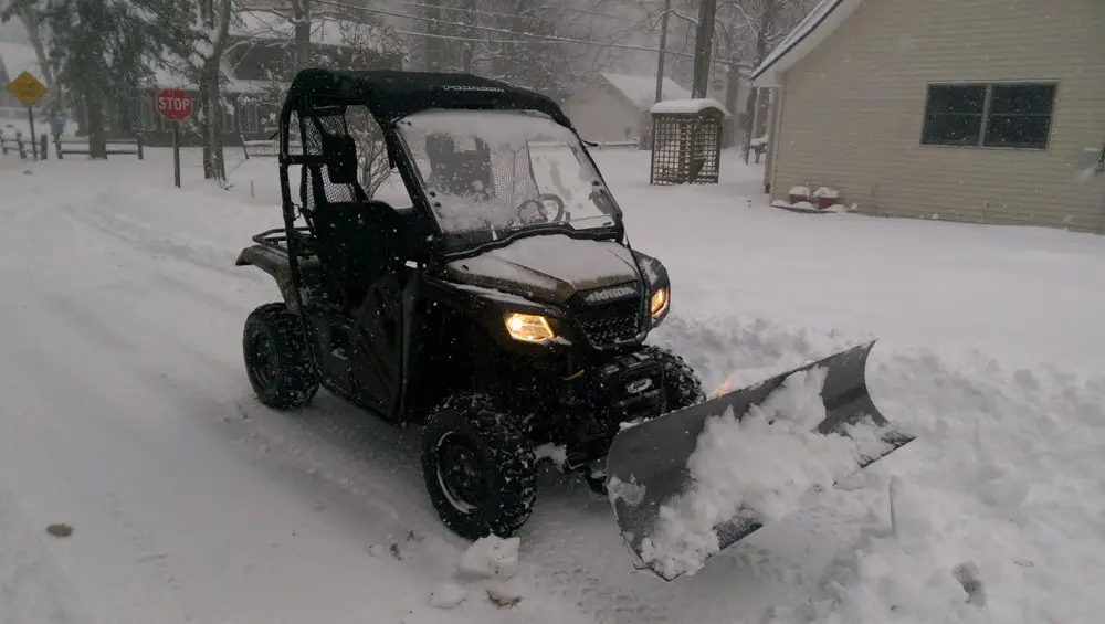

I run the full KFI 60" plow setup with a Kolpin 3500# synthetic winch. Stock tires, stock lift. I push snow with ease and my wife plows with it when I'm on the road. It's so easy she does the street too... so the city plow doesn't fill our driveway with all of its crap.Weight of the plow is no factor and 60" is wide enough to clear the path for my tires. It comes off with two pins... takes about a minute. Maybe two minutes to put it back on.

Nice. I think I read an older post about your setup. That's why I've been leaning toward KFI. Only hearing good things about the KFI's.

Can't speak for the 72, but my 66" works great and additional 3" per side I can't see causing a problem. The power is there due to low gearing, it's just the weight of the machine is light when trying to pushing a large windrow of snow over with angled blade can shift machine laterally. This is if you're pushing against a bank of snow. In deep snow say deeper than floor boards I've made two passes. The hydro angle sounds like a nice option and angling on the fly would be cool. I'm very pleased with my KFI set up and surprised at how quick it can move snow.
