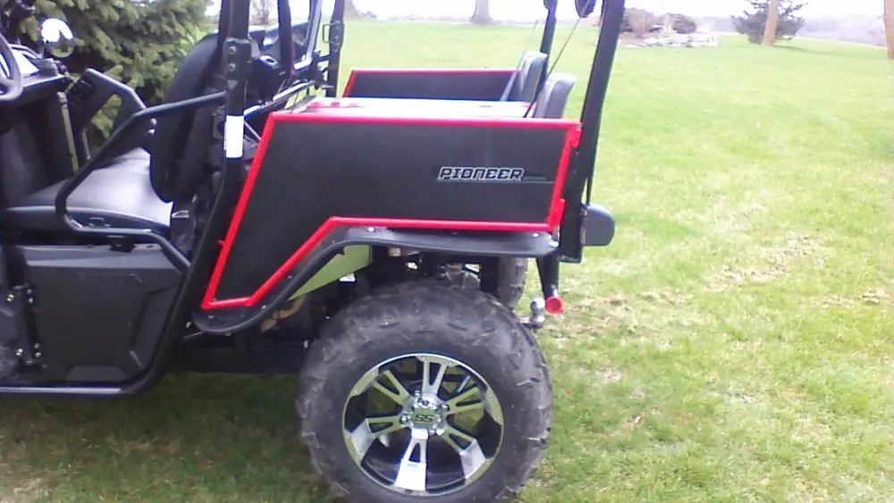

Gave it the finishing touch today, added a few stickers

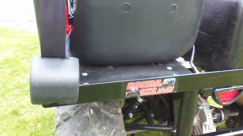

When I added the backseat I had to move the air cleaner intake out of the way ,I used a zip to pull it up to the cage cross bar
WIN 20160405 180204
, when I put the rear panel on it is on the inside of the panel ,I'm sure it is breathing cleaner air, this is something others could do as well
