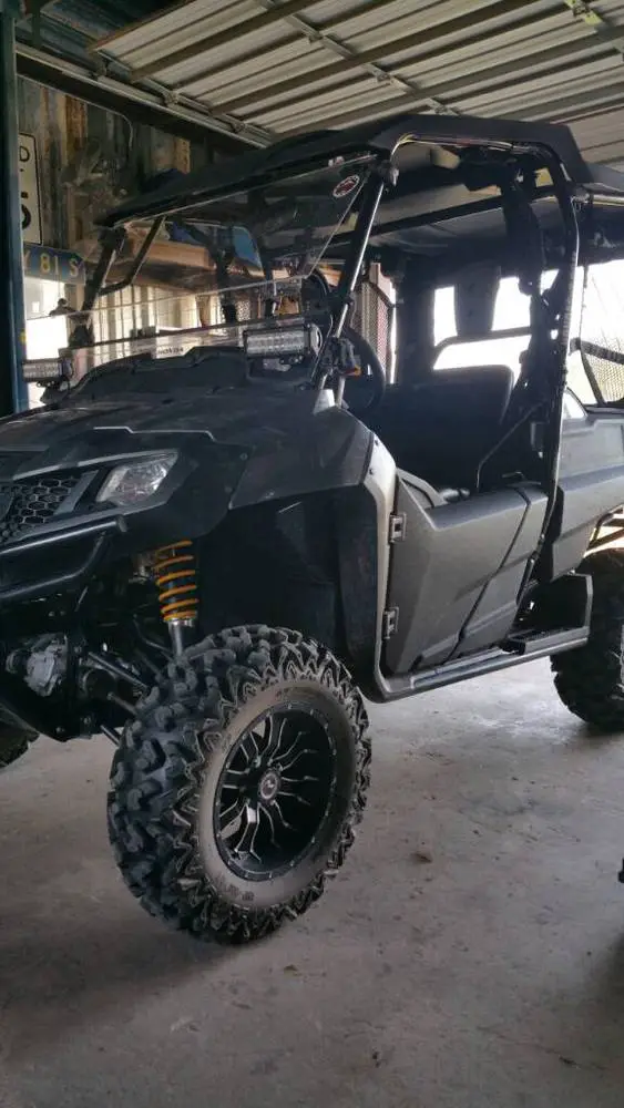

I think im going to order some new replacement shocks for the rear of my 700. Have one thats weeping and dont want to have a problem at the 2017 Takeover. Thinking about painting them to match the Pioneers body color.
What you guys think? Leave yellow or gray? Ec36cdea5efd9e7d7c3fd03e62f6638b
What you guys think? Leave yellow or gray?View attachment 30470
The cheapest I could find was from gearhead but they come out of idaho so I would have to pay sales tax. I know on the fronts they used the French word for shock so it was confusing. Good luck.

The yellow is kind of growing on me though. I haven't got mine on yeah but I was dreading the yellow springs. But they look pretty cool on your ride.

I know another item I found on ebay was shock covers so that might be another option instead of painting them.

I also kind if like the yellow. I just normally like everything to look factory.
