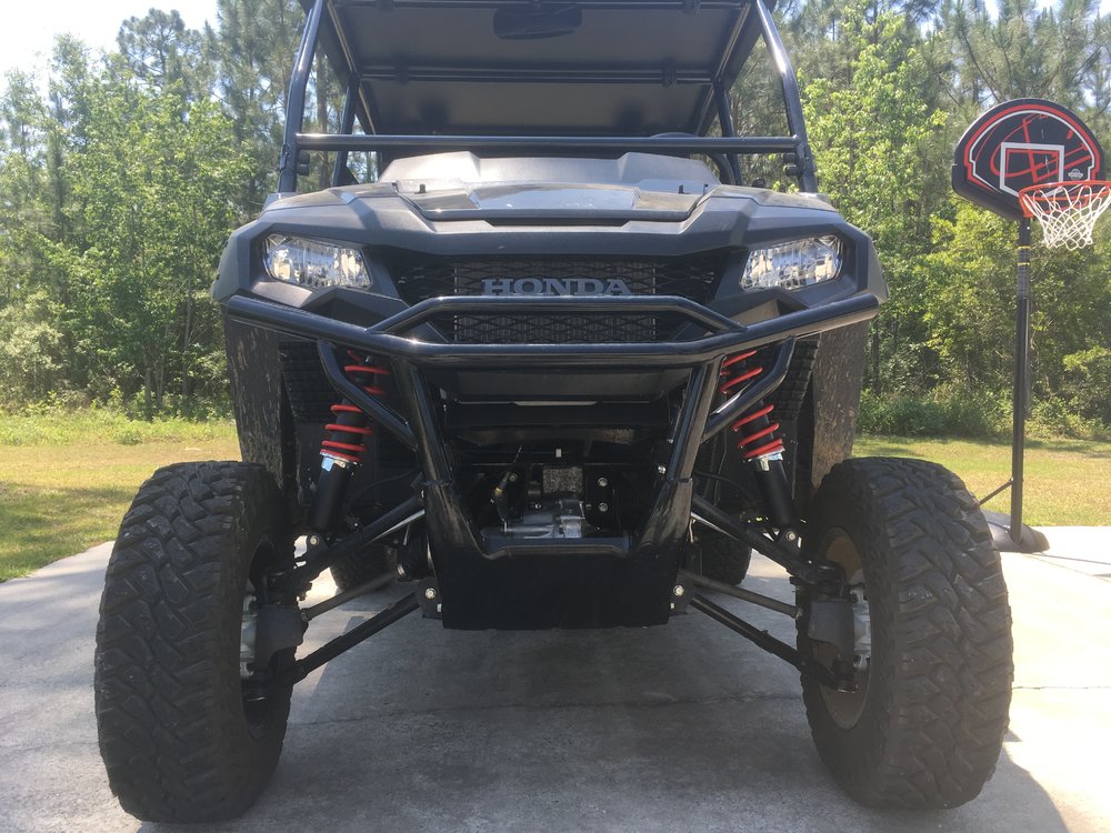

It's amazing what happens when you put the right part into the right spot. Got the front Commander springs onto the front shocks and installed. Clearance measured at the center of the front skid plate unloaded went fromt 9.5" to 12". Ride is pretty good so far. I also put a rear 2" coilover spacer on the back rear shocks to lift up the back a bit to level out the pre runner look you get with the fronts. The real test will be tomorrow when I'm out chasing coyotes..

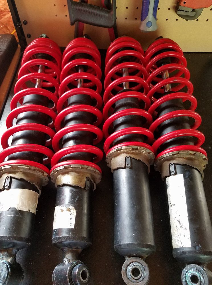

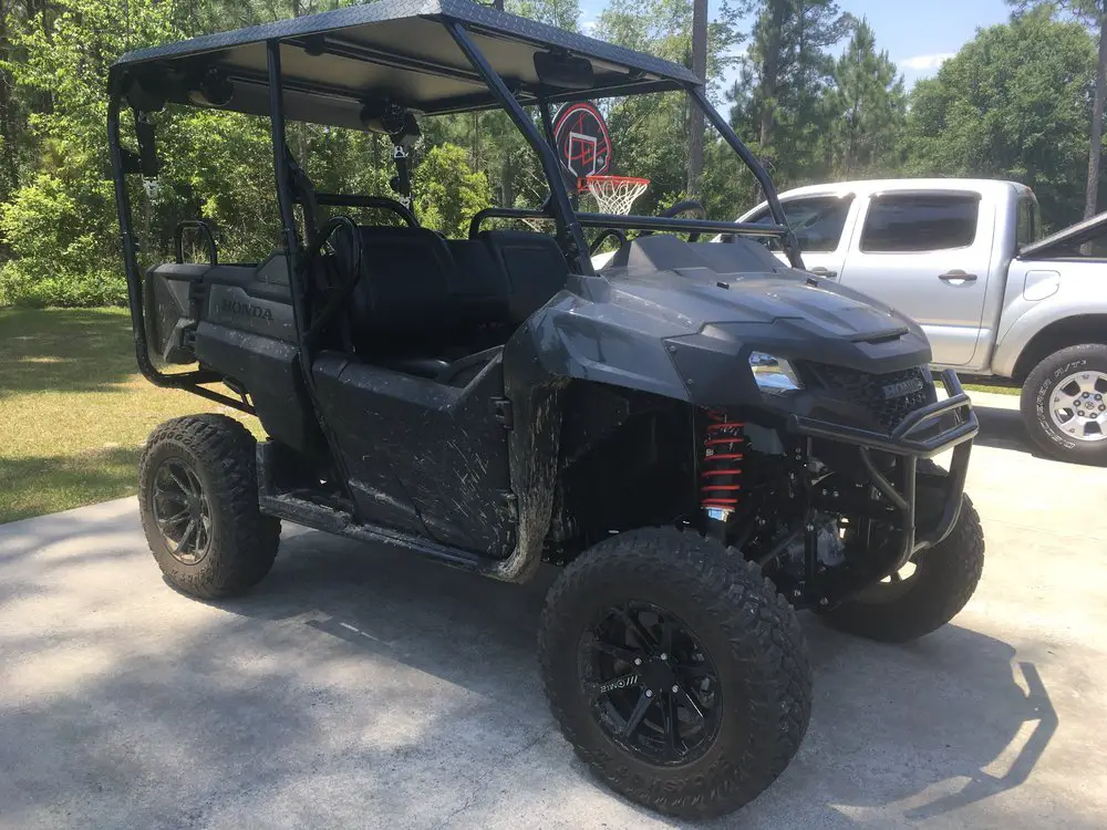

I have been looking for about a year for some commander shocks and finally found a pair of the red colored ones I like. They have 2 miles on them. They are labeled
Front shocks: 706200782
Front springs: 706201367
Rear shock: 706000615
Rear spring: 706001043
The seller stated they came off a 2016 commander 800 dps, which from my understanding still has the same springs as a xt. (Maybe not now) what do y'all think?

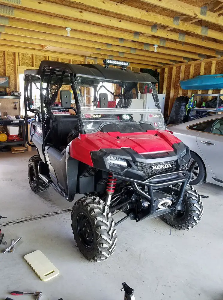

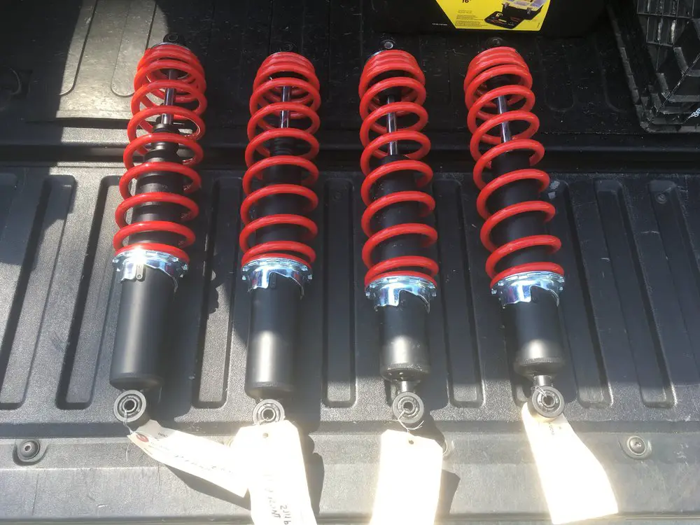

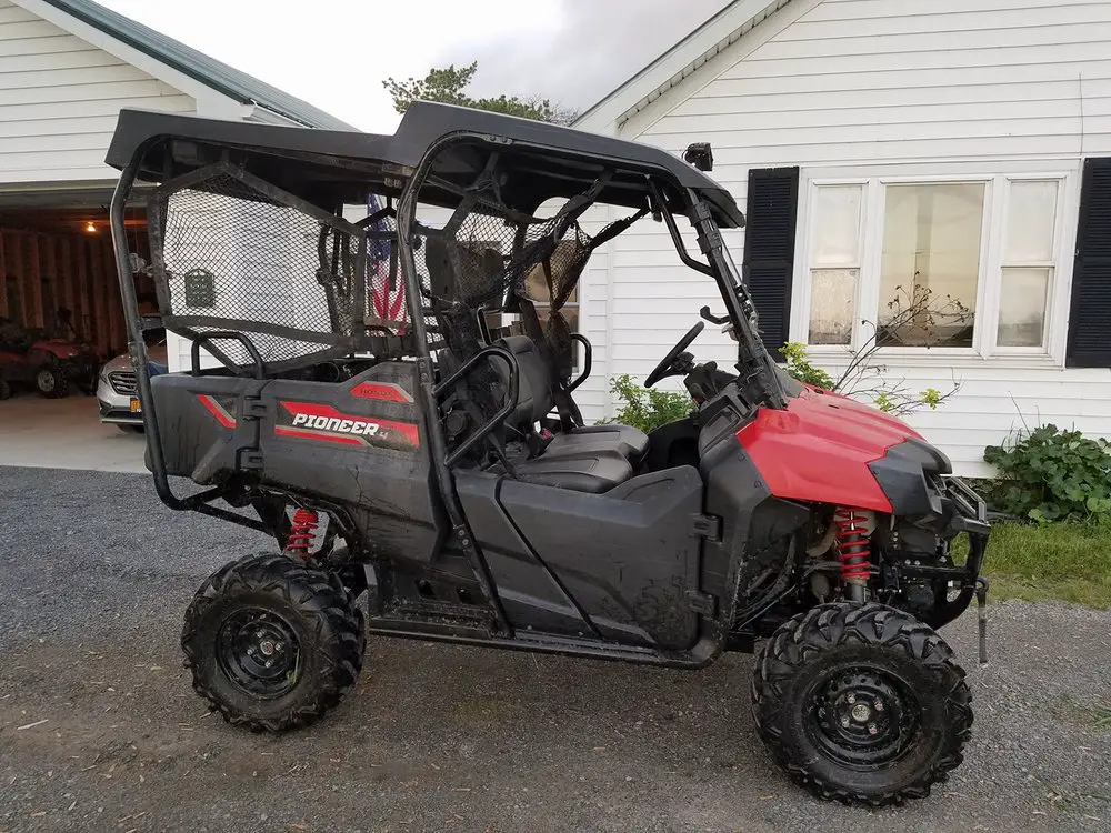

So I got my commander shocks put on tonight. I got a set from a 2012 Commander XT 1000. I found them by browsing craigslist, when I'd see a newer model Commander XT with aftermarket shocks, I replied asking if they still had the stock shocks, I scored and found a set of 4 with the black springs.
Ordered the bushings and British metal tube from ebay, then came across a good deal on a set of red springs from a commander, so I scooped them up as well. Only issue we ran into was the British metal tubing, I had to ream it out a little with a drill bit to make the Honda bolts go in. Might be a change in bolt size on the 2017's?
Front install was a breeze, I did that myself before my buddy got here. Rears were tougher, had to disconnect the sway links, and we used ratchet straps to compress the spring to get the whole shock in, but once we figured that out, the other side went in much easier.
We took a quick ride and it seems like a better ride, but we're going on a poker run Saturday so that'll be the real judge of ride quality. I forgot to measure before, but there's definitely a slight lift. Overall, looks like money and time well spent! Thanks to all the starters of this thread that did the research and testing to make this easier for the rest of us!

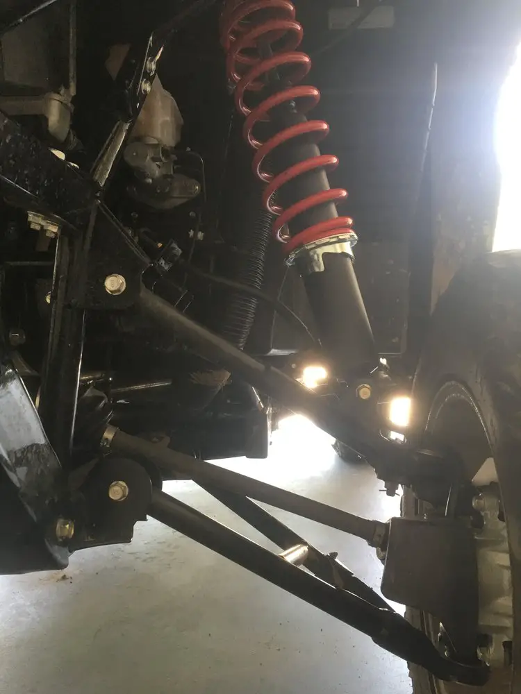

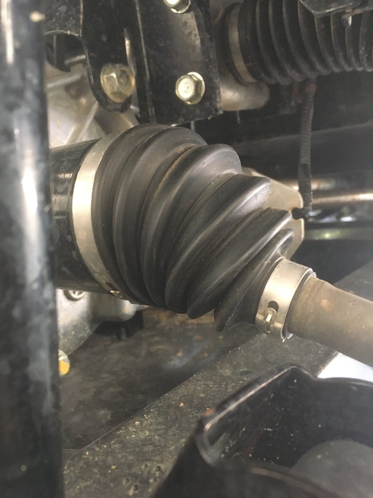

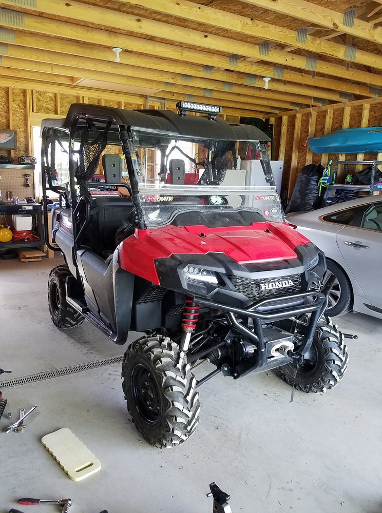

View attachment 74878 View attachment 74879 View attachment 74880 View attachment 74881 View attachment 74882 Alright something ain't right. I installed the fronts and it rides like crap. I'm pretty sure I can hear my cvs binding.
I went from 11.75 ground clearance to just shy of 15 inches .
