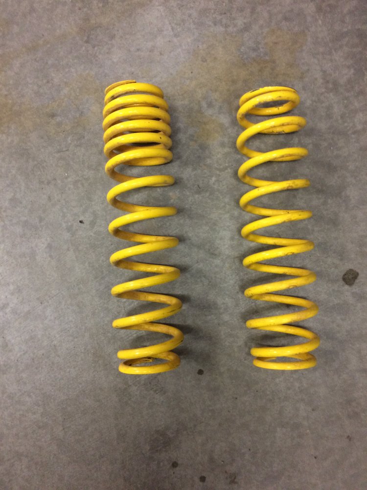

Spent the day installing Commander springs and shocks on the front of my 700-4. Went through two spring compressors before finally just using the four ratchet strap method. What a pain. I'm not sure what I did wrong but I ended up with about 4" of lift on the front. Since I don't have the rears yet, I put spring spacers on the rear to lift it about 2.25". Took it out for a ride and now am thinking what the heck did I do wrong. My fairly smooth ride has turned in to a clunky, junky, rough, Clampett mobile. Steering feels loose as all get out, bumps transfer straight to the steering wheel. Any ideas?

Pictures of the shocks before and after install please.

I'll have to get pics tomorrow. I'm wondering if I have the preload adjusted way too high.

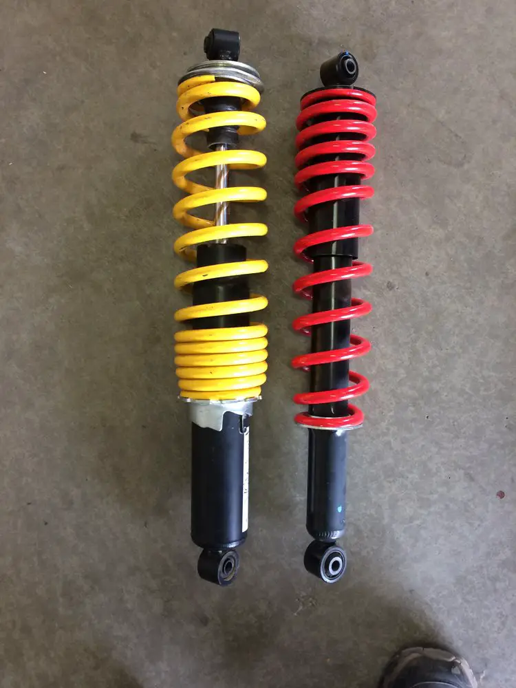

Here are mine before install.
Yours spring's look a little different!

Is it possible that I put the rear springs up front?
C
Cazadore
Apr 22, 2017
26
19
Az
I can’t see the numbers on the installed ones. I’ll pull them tonight and check. The back Springs, I think, are 706201124.
Okay, problem solved, the part number shows "yellow front spring". I knew something was wrong. Well at least I know how to break down the springs now.
