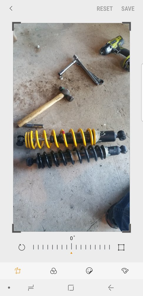

Here' what I did on the rears.
Screenshot 20171011 105601
Reactions: Offroad407

Screenshot 20171011 105806
Only need bushings for rear upper and lower eyes because of the steel sleeve being changed
