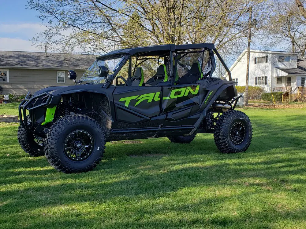

New tires and wheels are on. What a difference. View attachment 266872

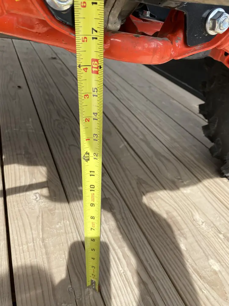

Monty if you have 16+ inches of ground clearance on 30 inch tires than your suspension is cranked up to high and that is why you rub so easily. The higher you go with suspension and stock a-arms the closer it puts the wheels at normal ride height. The more down angle on the a-arms the closer it is to the wheel well. I have 32s that measure more like 31.3 and virtual never rub. But I have more like 14+" of ground clearance. Hope that makes sense. And/or you have a really wide tire....which is a factor too.
@Montecresto do you have aftermarket springs?
34,174
Hmmm, it’s not wide tires because I went with 10’s on all four corners. And haven’t messed with the suspension.....🤔

Was that settled or just off the jack? Also l.v. has different springs ect, may just be a little stiffer sitting there.
It was settled on the trailer. Yeah I know it’s suspension is different and I’m not sure even adjustable???
Reactions: Plumber32
34,174
If it ain't broke don't fix it!
I totally agree, unless Hometeam is right and my suspension is cranked up too high??? Apparently I shouldn’t have any rubbing with 30’s....

My 30’s, which are a true 30.5 rub on the drivers side at full turn, without even going fast and taking a hard dip to the left. Not sure what will happen then...but the rubbing at slow speed on the level, just turning around in the driveway even, isn’t bad, and certainly not anything that will wear the tire or inner fender well.
A friend has the same machine with stock 28’s on it and he has 13.25” where I have 16.25” and this is at the rear right below the receiver hitch area in the middle.
I’m guessing that stocks might be a true 27.5”.....🤔

Btw, what do you think about my 16+ clearance. Do you think there’s something with my suspension?
Sorry @Plumber32 not meaning to step on your thread...🙄
13,512
70,111
Doubt it. Live valve may set to stiff when your turned off for trailering, thought I read that somewhere. You may be able to take some preload out. But I would not over think it.
34,174
Ok lol. I’ll check the alignment like snuff said and keep riding...😂
You can't check ride height that way. You should find a level spot, make sure you are in "Normal" mode and approach the flat spot from about 50 feet away real slow and let the machine stop on its own on the flat spot without touching the brakes. Put in park and leave it running and slowly get out and re-measure.
Get someone with the same machine to measure from the shock body top to the preload nut and see how they compare. The LV also has crossover rings so make sure there is some clearance between the ring and plastic spring divider at ride height.
34,174
Will do, thanks!
