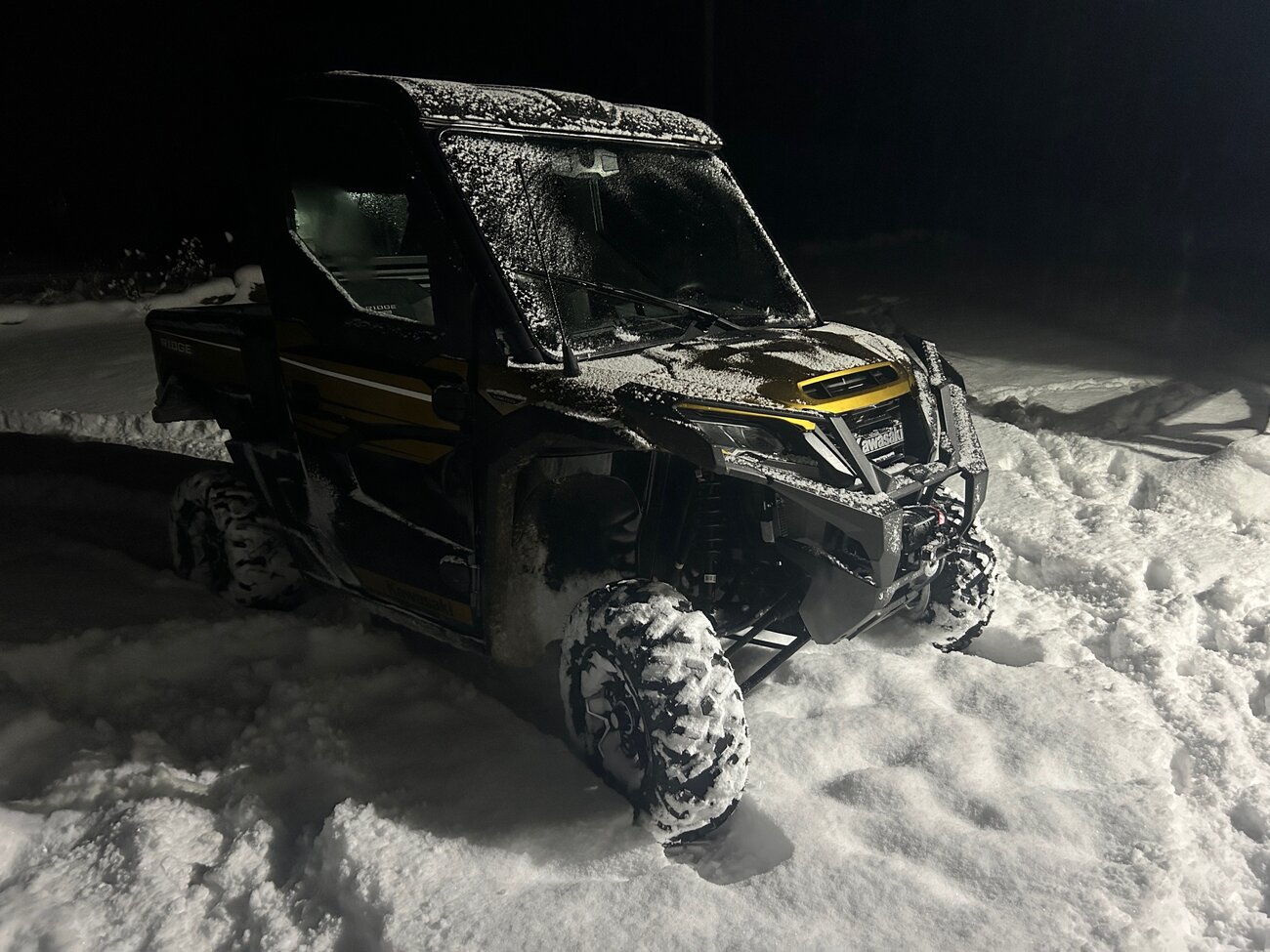

Little snow storm going on the past couple days. Started getting a bit heavy last night so I went for a ride with one of my pups. The HVAC did it's job, kept warm and the defrost and wiper kept the windows clear enough. I believe all HVAC buggies have a little bit of an issue keeping the coolant temp up high enough to make good heat. The coolant temp would get below 150 at times but it stayed warm enough. I may try a piece of cardboard in front of the radiator. I have my complaints about the machine, but there's no denying that the cab is very nice and comfortable, especially when the weather is bad. Still waiting on my snow plow bracket to come in - then the mission will be making a Tusk snow plow work with a KFI snow plow mount. Hopefully no big deal

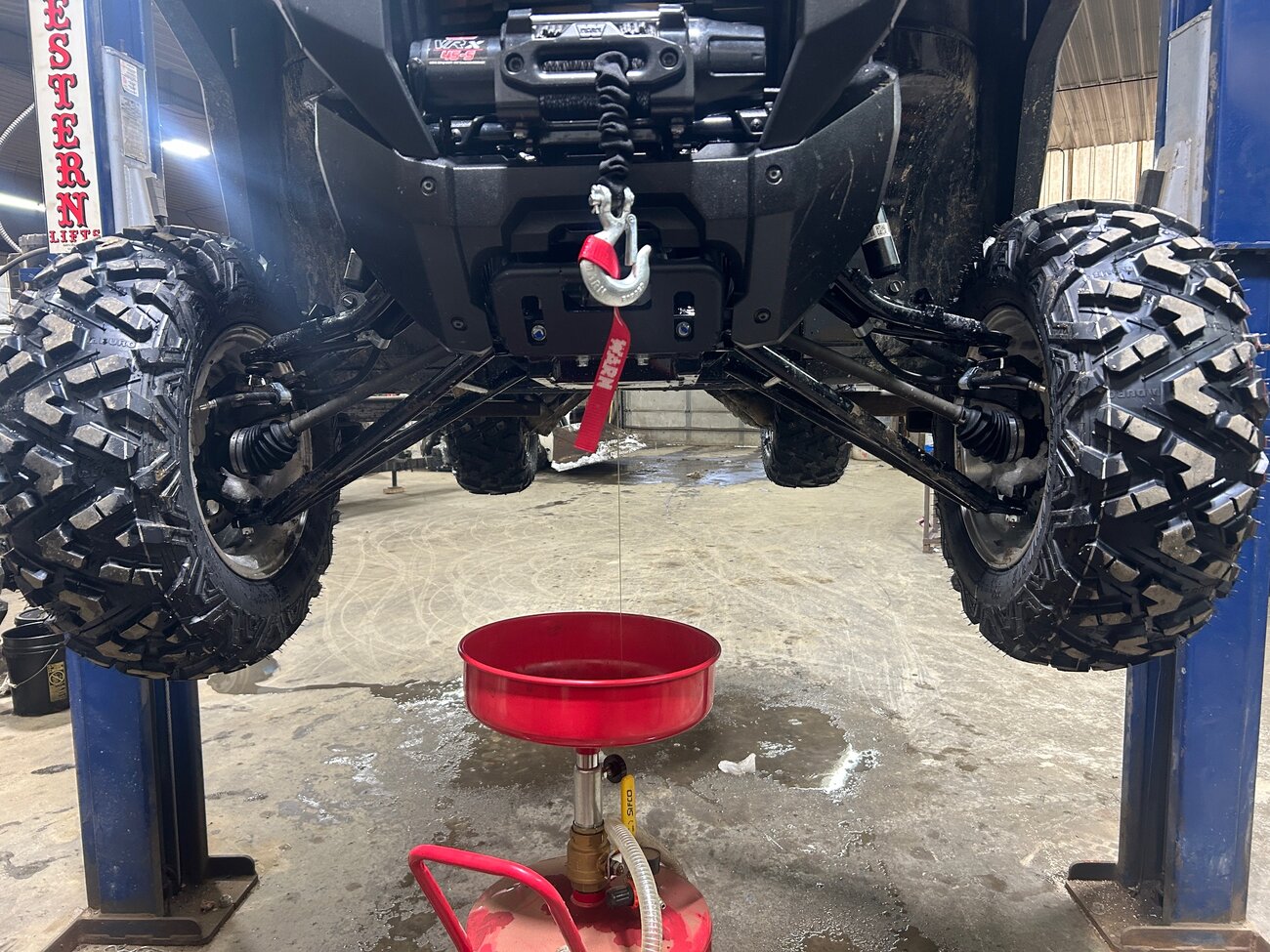

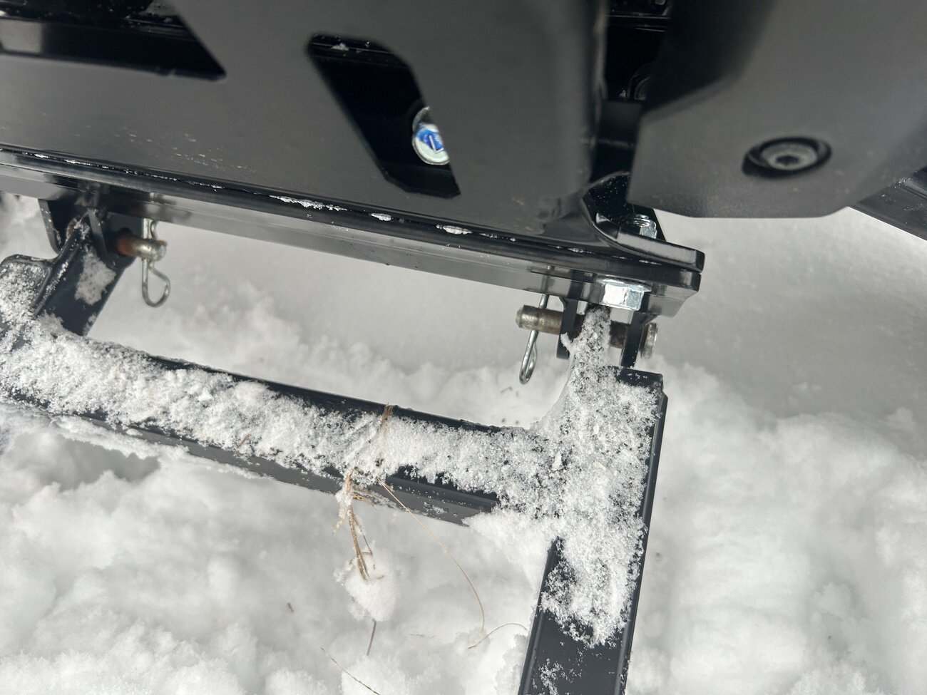

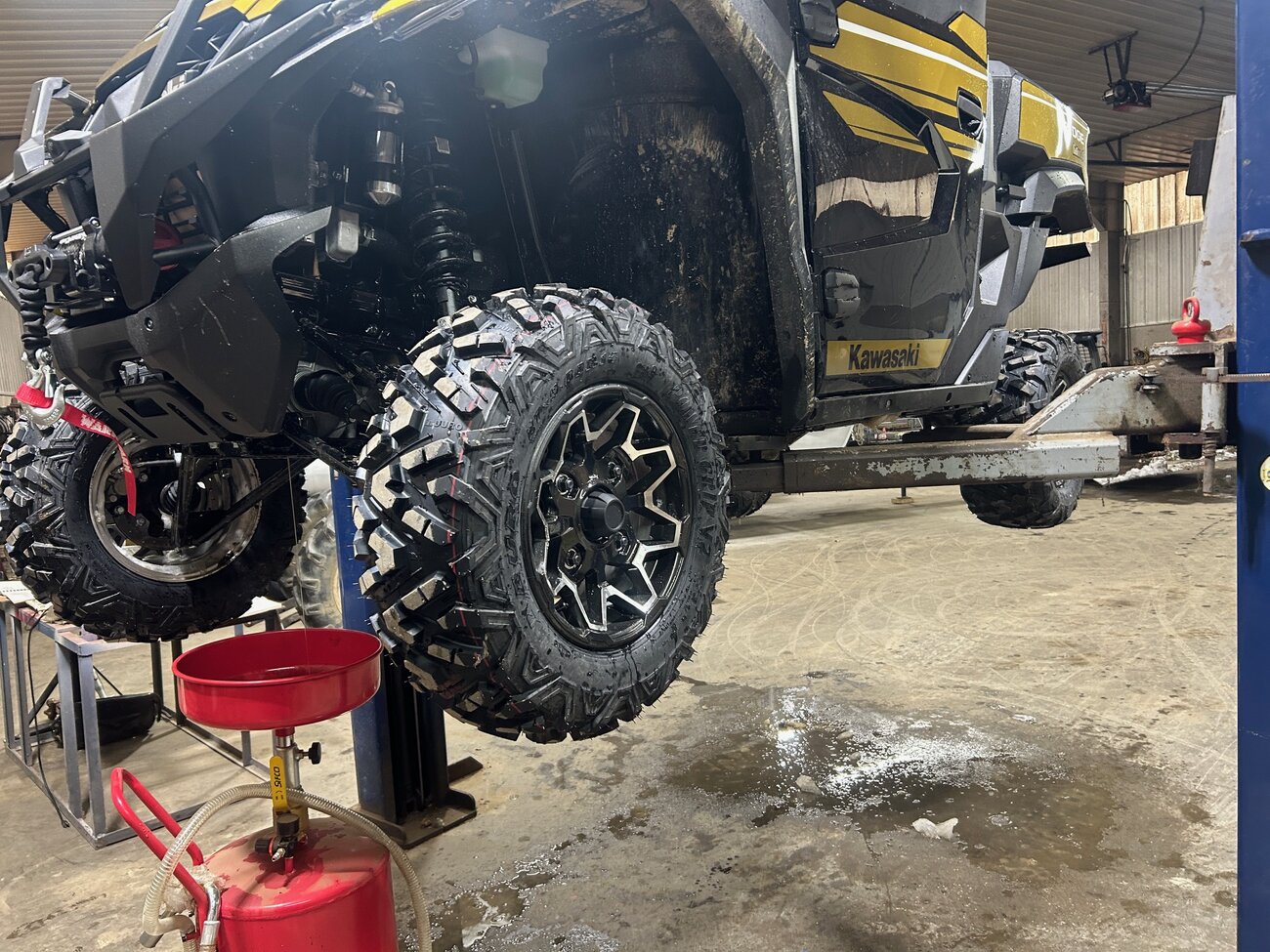

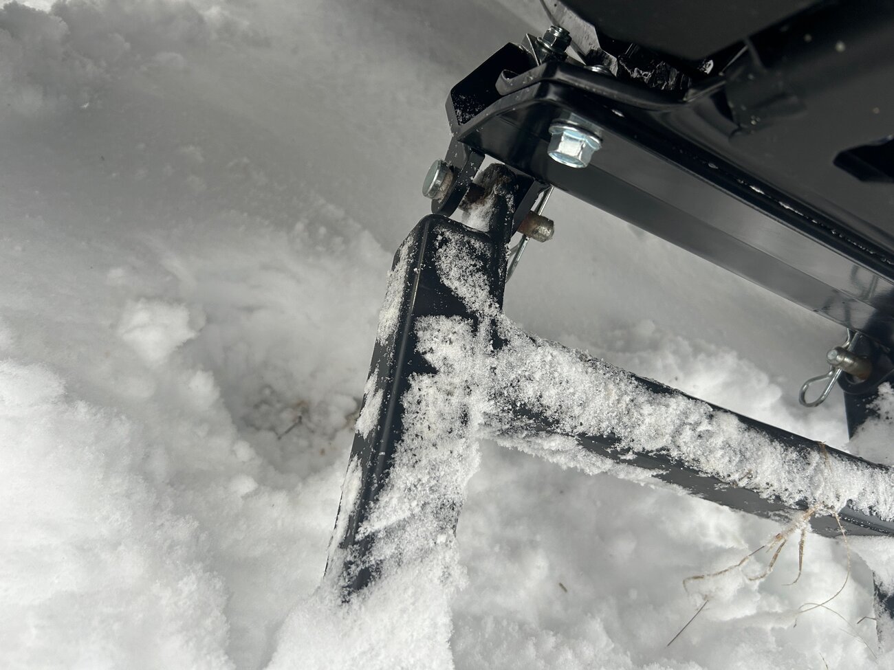

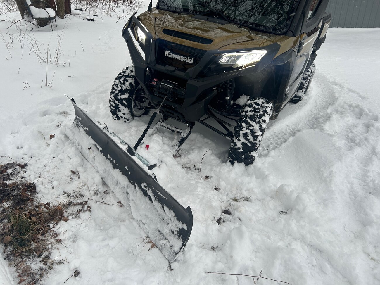

Did the first service. Super easy. Guess what guys... SPIN ON FILTER! Trans and front diff are super easy too. Didn't have to use a piece of tube or a pump to refill.
Really happy the KFI plow mount works with my old Tusk snow plow that I had on my Pioneer. The only thing I need to do is drill out the plow for larger pins - the KFI mounts use larger pins than the Tusk so it's a little sloppy. But it went right on no problem!

If your rig is similar to my Teryx4 the fluid changes are really easy. When I purchased my first service kit EVERYTHING was in a single box designed for my rig. It included a disposable cardboard funnel and a pair of rubber gloves. I bought mine from the dealer at time of purchase. I felt like it was cheap considering what it came with. I think I paid $90.

I got all my stuff from a local independent shop. Used Honda GN4 engine oil and used amsoil in the diff and transmission. I paid $190 for all that and the snow plow attachment plate so it was very reasonable considering the plate was over $100 by itself
