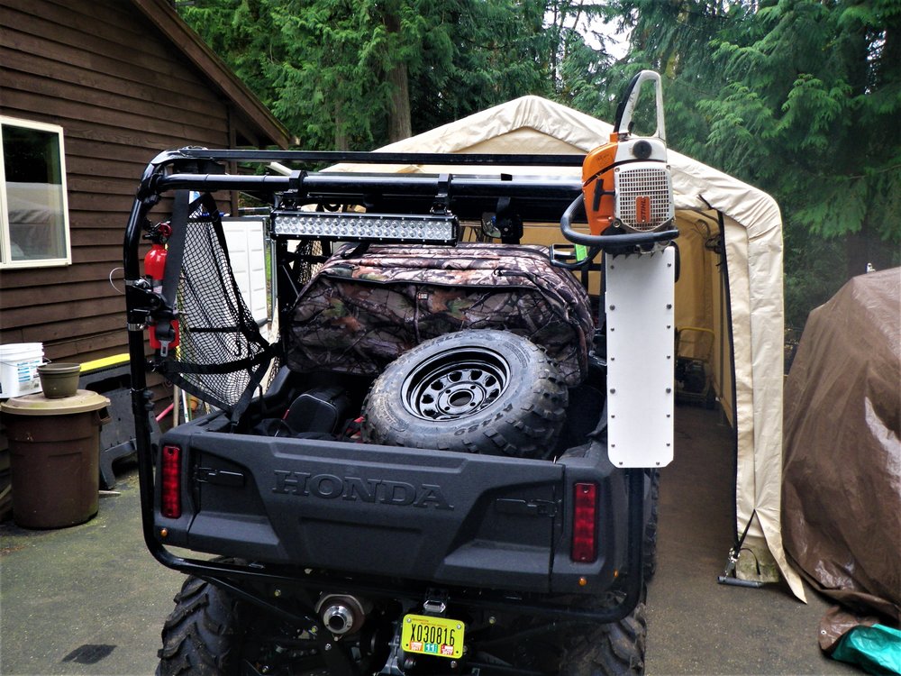

snowcat100
Apr 4, 2017
7
10
Issaquah, Wa

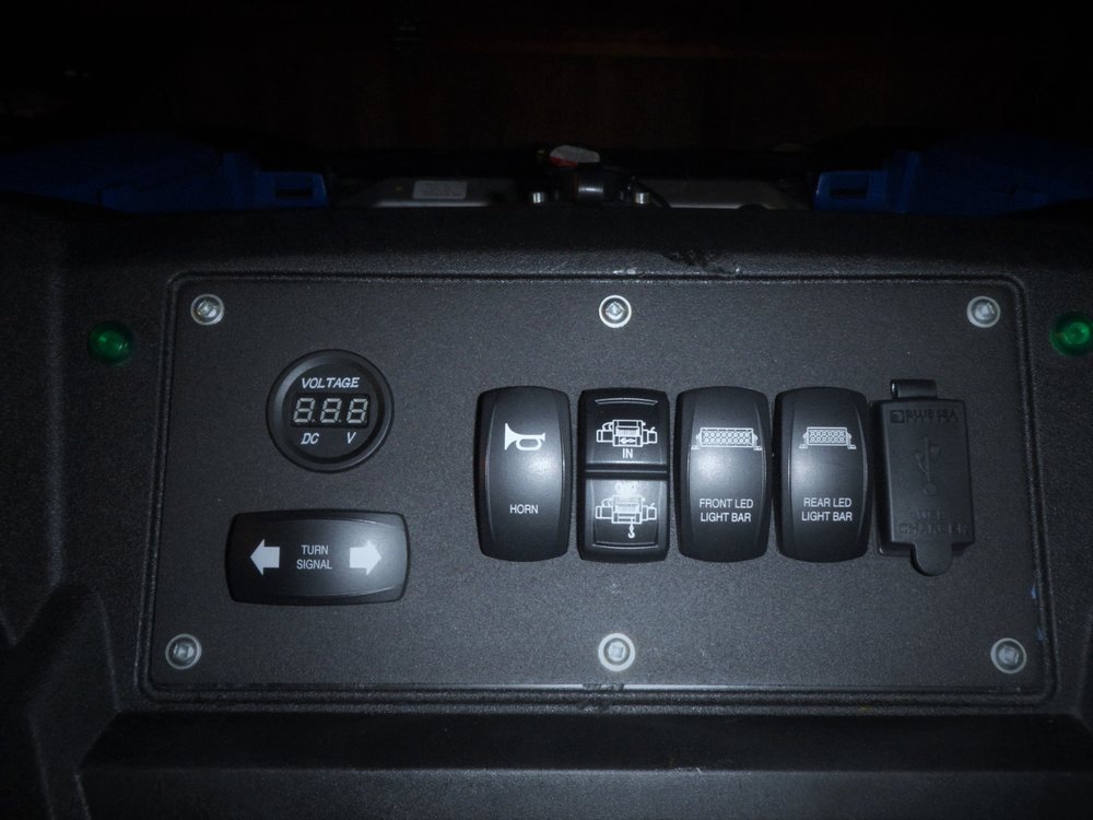

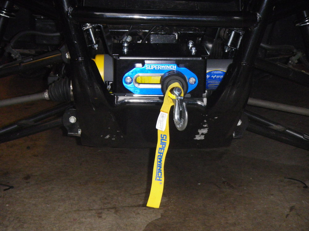

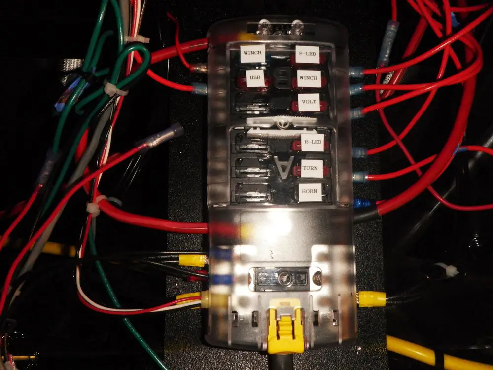

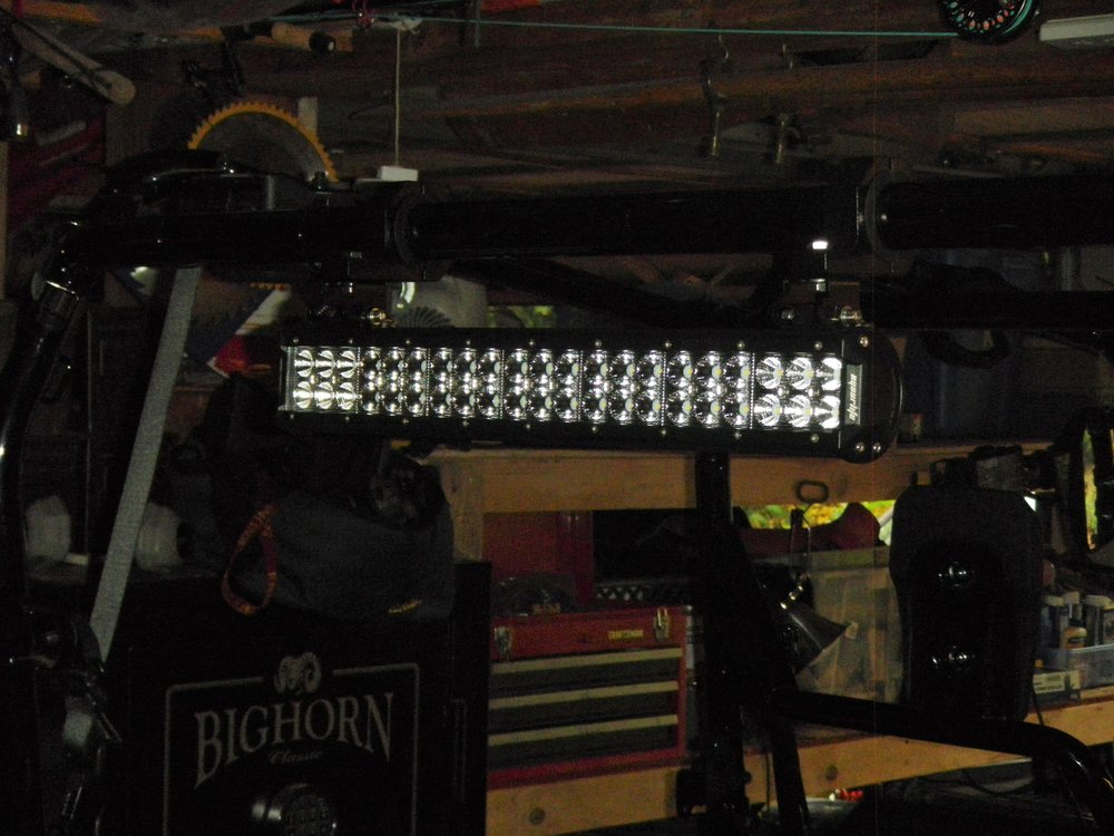

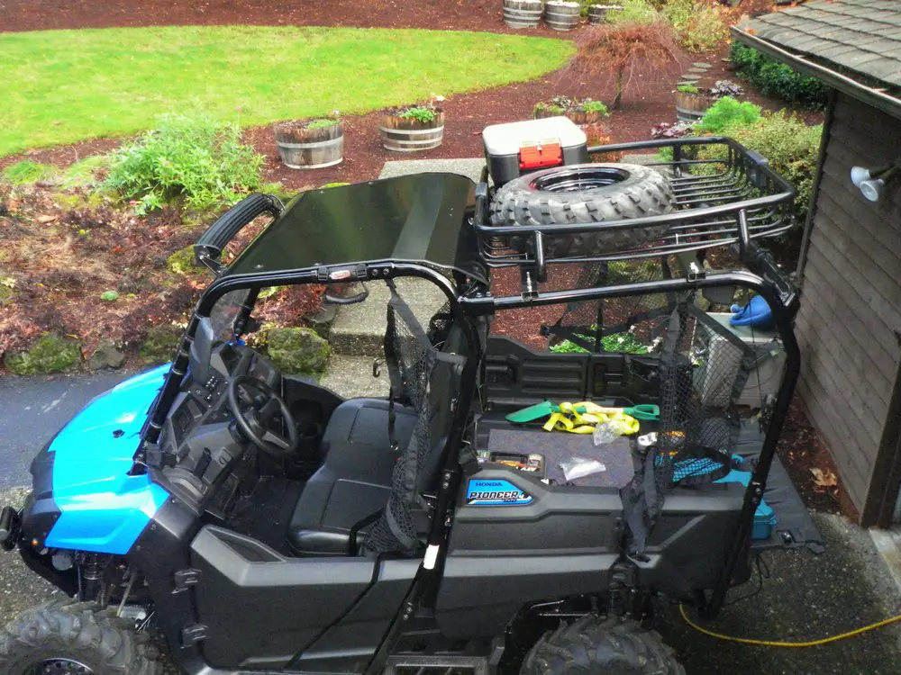

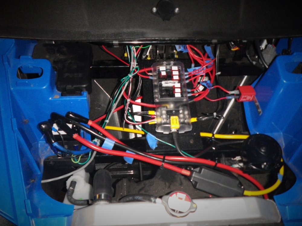

I think it is almost required if you plan on adding very much. I have included pictures of my build to give you some ideas and fuse block install.
2010 05 13 022134 2010 05 13 204930 2010 05 13 022323 Scabbard on SxS 2010 05 13 205152 2010 05 13 205254 2010 05 22 233559 2010 05 22 234304
Reactions: EastTN700
