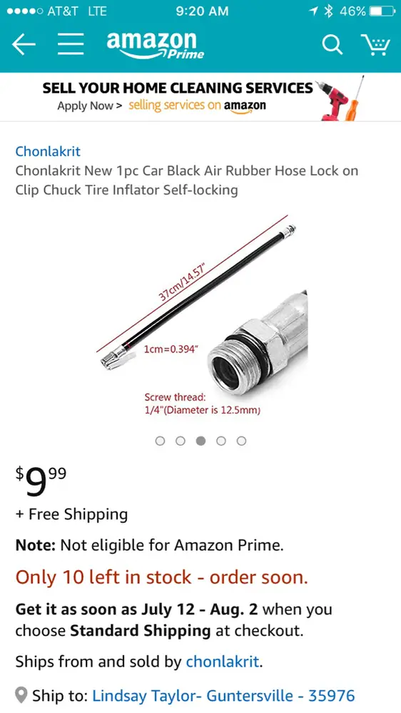

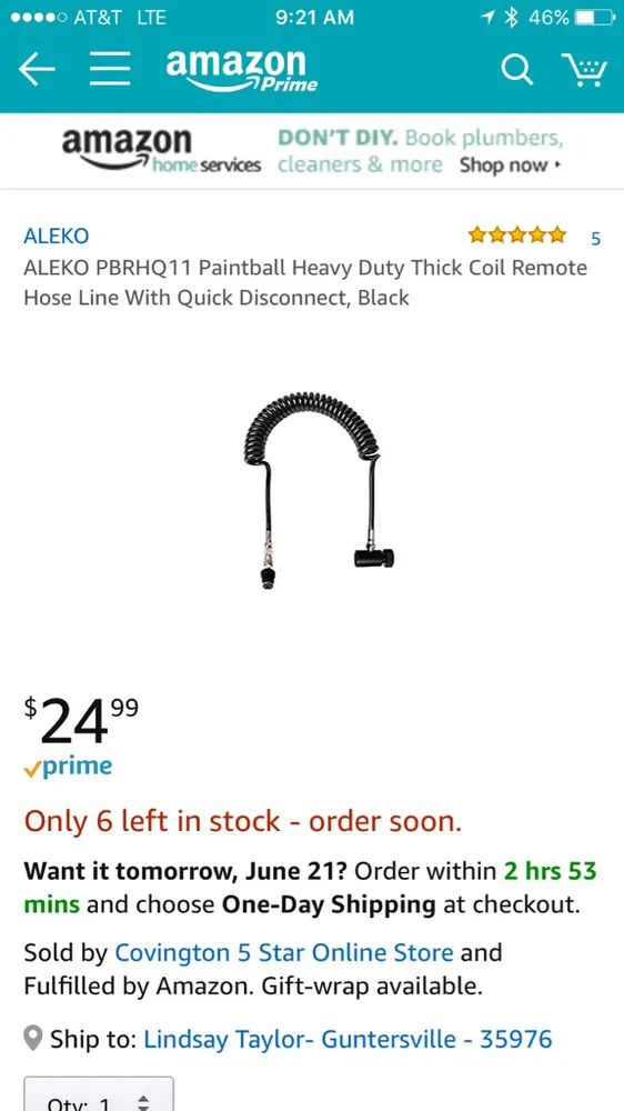

You'll need a hose to go from the tank to the air chuck. There are several options here. You can use a coiled hose meant for paintball or you can use a grease gun hose because they are the same threads or you can use one of these fancy air chucks with the hose made onto it. Some of the paintball coiled hoses already come with the valve you need to open and close the tank.

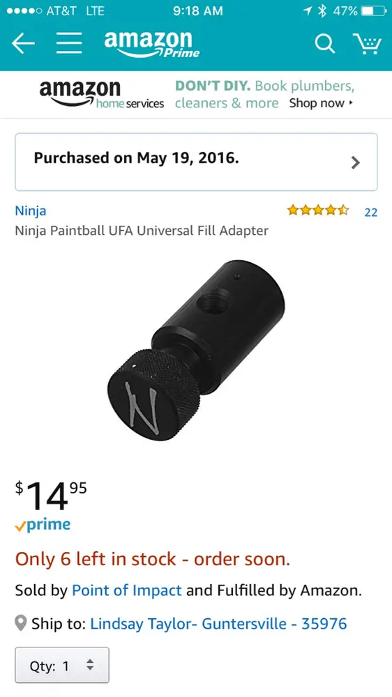

If you choose to use a grease gun hose, here's the valve that you'll need for opening and closing the CO2 supply.
