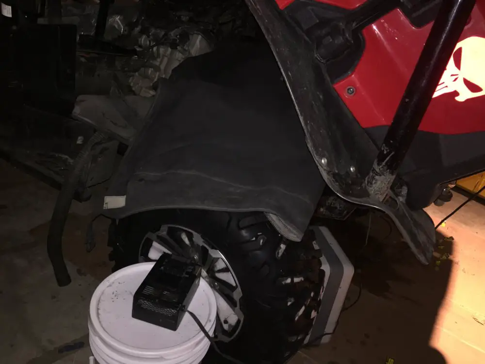

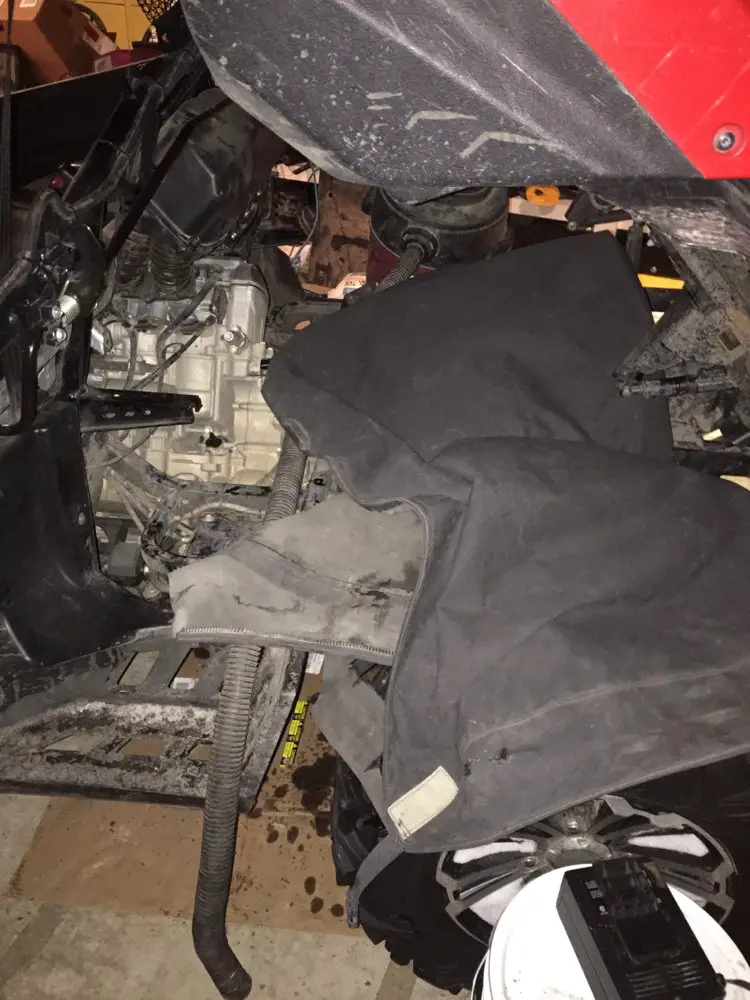

Had it warming up over night...
IMG 6291 IMG 6292
The engine was warm to work on in my garage that was probably 30 above temp

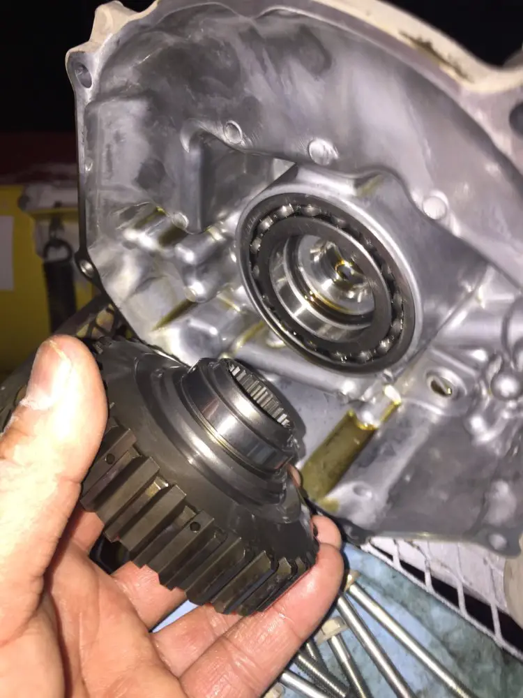

At this point I was supposed to take a break and grab a cold one but on my lunch break and in a hurry at this point
IMG 6341
IMG 6342
Old O-rings removed and new installed ensuring no debris and oiled. With clutch pack still in the same position carefully lined up new soaked clutch pack with splines on shaft. With the palms of both hands applied equal downforce while holding underside of gear with both hands and slid new pack on! Again without the use of hammer and socketo_O
IMG 6343
This pic shows different gaps on each side of the visible gear. The lower & larger gap faces outside;)
