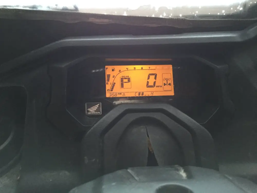

Test successful! Still no U
IMG 6359
@JACKAL @CumminsPusher Can you tell me why my gauge did not appear as your did and whether or not I will need to reset?
Also, all gears work great, auto & manual, including sport mode all work! No issues
42,062
322,676
Mine made me do it every time. I'm not positive why yours didn't but I'd sure reset it
42,062
322,676
Thanks, all credit to @CumminsPusher i studied his Thread Religiously!
