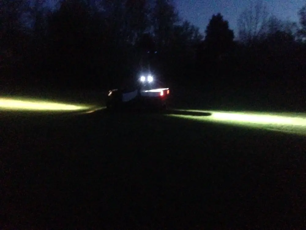

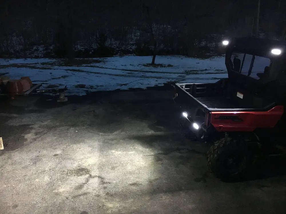

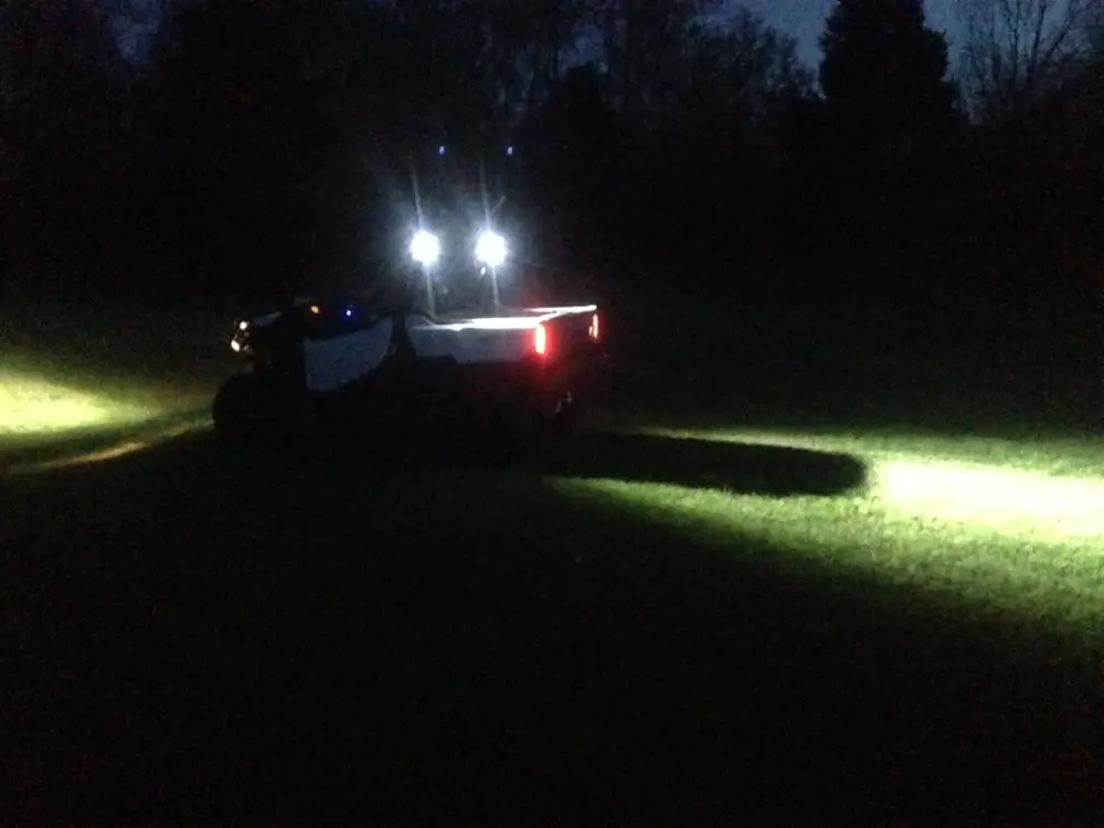

I have one set down low on the reverse trigger and another set on switch.IMG 20160903 115057172 HDRIMG 20170318 144557979

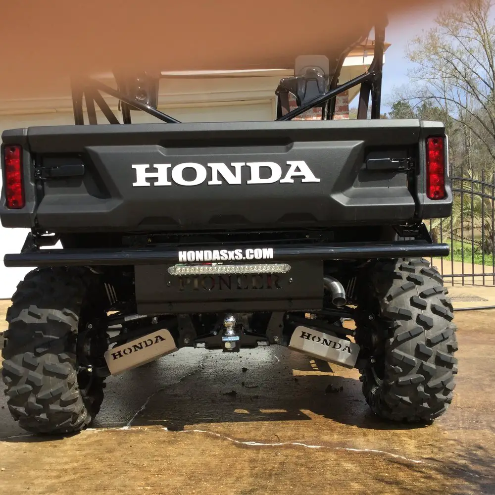

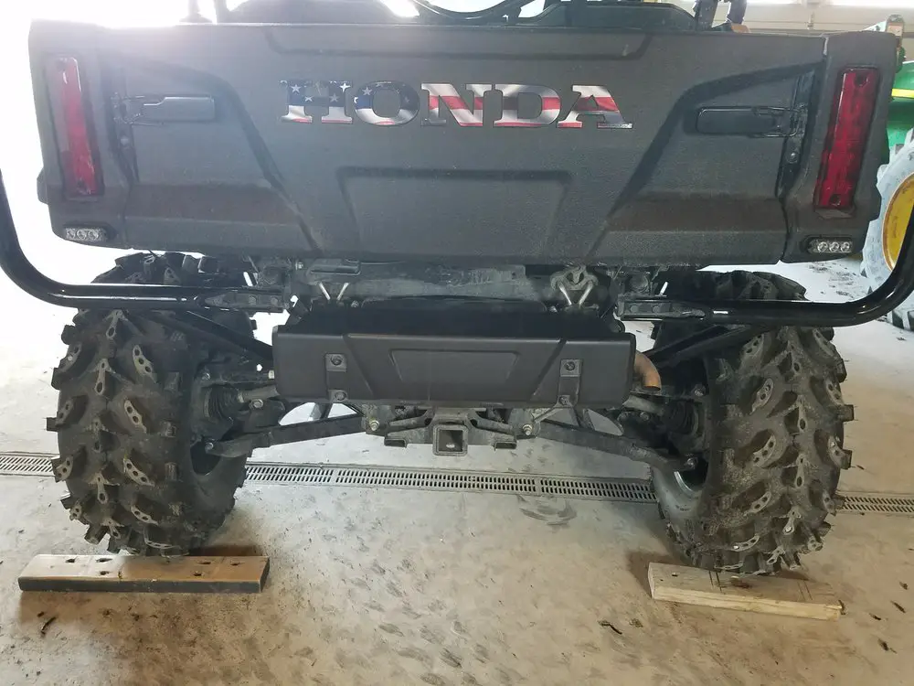

Mine is mounted to the reverse alarm connector and only comes on in reverse. It is a 21 light, 17 inch light bar I got off of ebay. It is mounted to an S&S fabrication muffler guard.

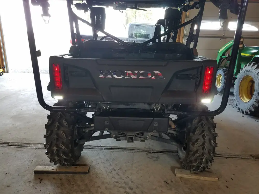

I used a white set of grill lights for mine, easy wiring with the backup alarm harness. Work great and brighter than you'd think.

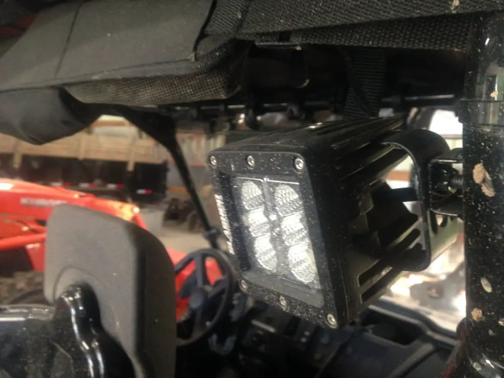

Depending on width you can use a 3” long piece of ¼” thick flatbar UNDERNEATH the plastic to stabilize the bar
That’s about as close up as I have of my old machine.
