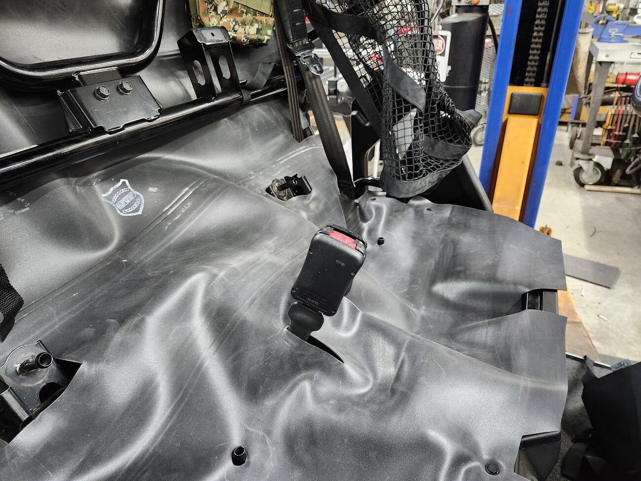

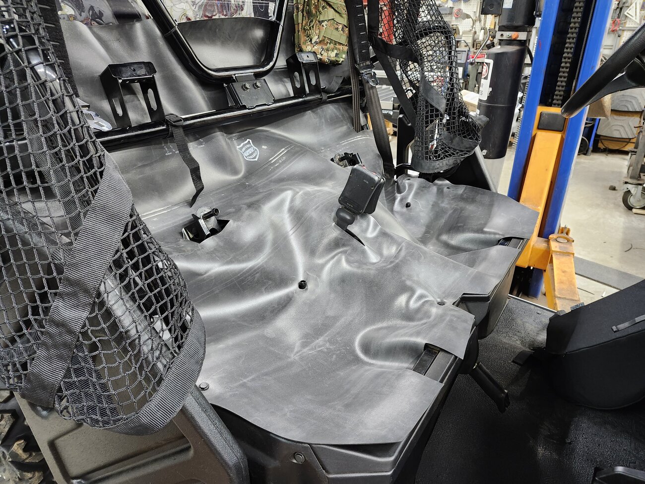

Front housing removed, man that was easy, no problems.
for thoe of you that have no lift in your shop, i feel bad for ya. I cant work on knees like that anymore.
Locker ahould be here in the morning, and mud busters too. Getting close to the base line of ready

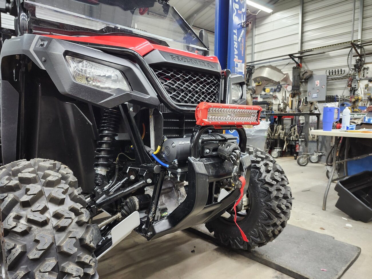

I made that fat fawker squeal! Air freight suppose to be before noon there piggy!
Back together ! Now time for a big swig of the good stuff. Mud busters next, shocks be here who knows when, hopefully before Honda invasion!
shot some wd40 in diff housing, who needs gear oil, conspiracy!
