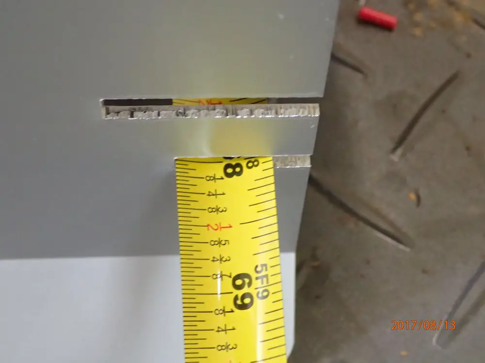

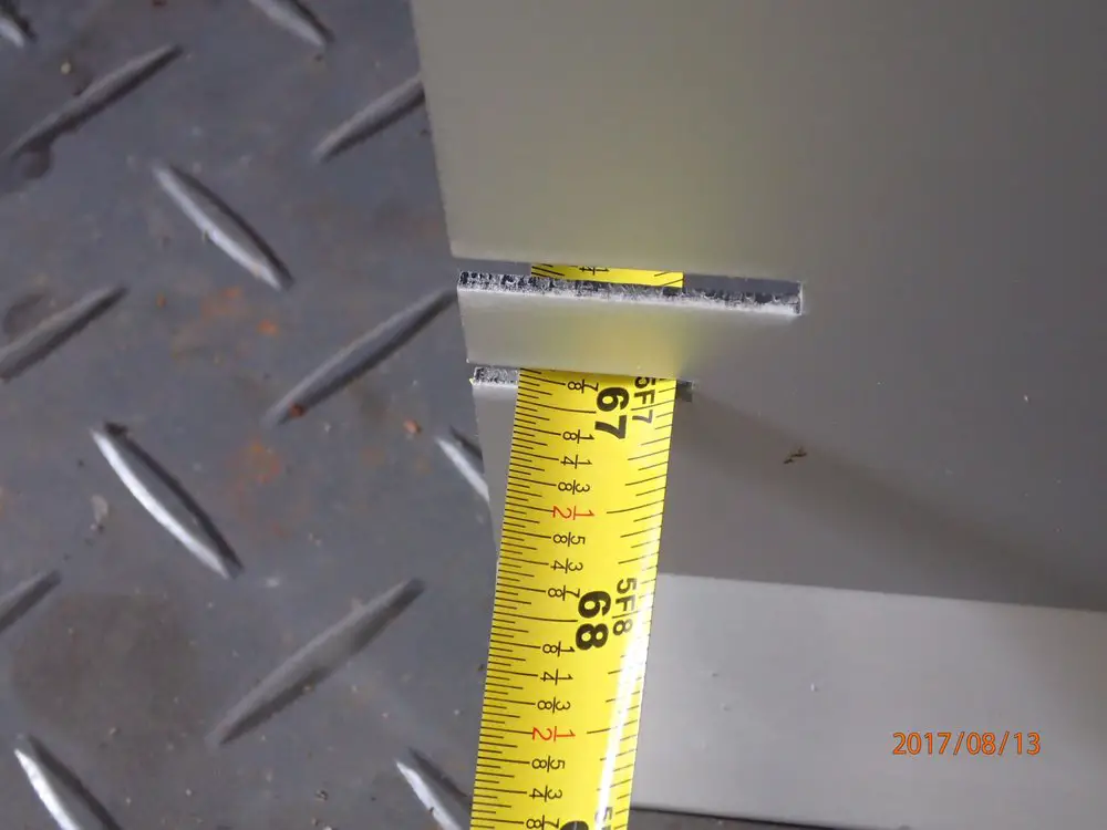

Got out the toe plates today. I knew the front end looked toed out, but I had to take pictures or nobody would believe me .... toed out 1 1/8 inch. Now toed in 3/8"
Measurement at rear of tires.

Front measurement

Ow yes I would, mine was toed out 1 1/2 niches, now 1/16 toe in, don't drive on pavement much or I would have more
