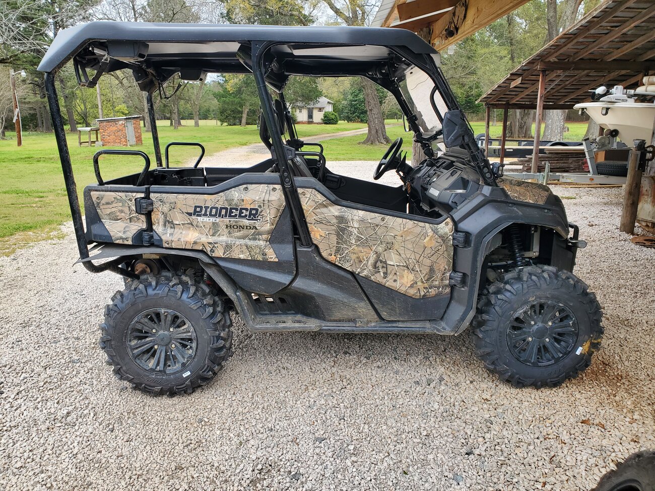

Been very pleased with the 15" wheels and the Forceum MT tires so far. They worked well at the TO this year.

What's the height of the tires your running in the picture? Also, will the go good in mud? I have the 12" wheels and was thinking I'd keep them but theres not a lot of choices with the 12" like the 14 and 15". Also, how many miles can you get out of a set if you rotate them?

235-75-15 on system 3 8x15 wheels.
Did well in the mud at Takeover this year, only have 300 miles or so on them. I will say that the machine rides MUCH better on gravel roads and pavement.

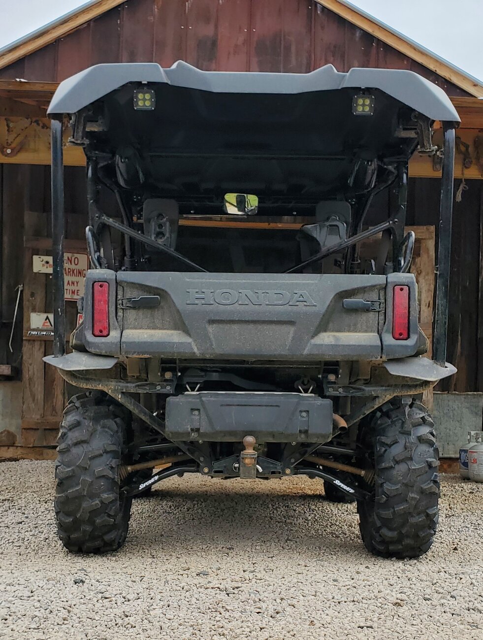

I just put itp blackwaters on my stock 14" wheels. 28x9 up front and 28x11 on the rear. I didn't want to buy new wheels either. The back tires rubbed the roll bar(the one at a 45° angle that goes down toward the hitch) when hitting a pretty good bump. After that I adjusted the preload on my fox shocks and installed some wheel spacers. I now have SuperATV a arms front and back. In these pics I had SuperATV arms on the back and the stock arms still on the front. No rubbing on the front with the stock arms.
To answer your question I would stay 9 on front and 11 on back. Unless you want to rotate tires but then you need new rims that are all the same size. If you put 10s front and back on your stock wheels then the front tires are gonna stick out further to the sides than the back tires.
View attachment 348004View attachment 348005

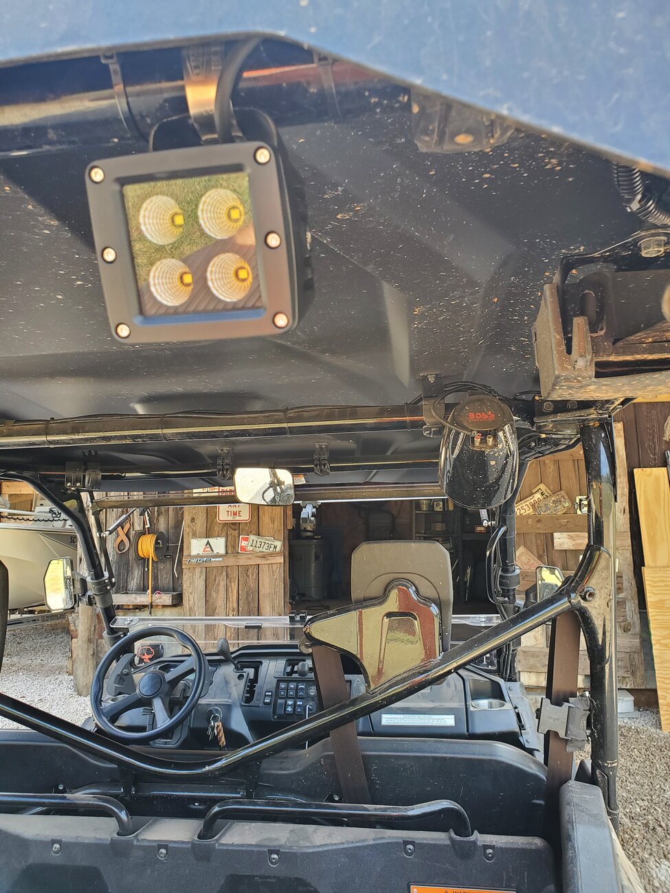

Here's a closer pic of the rear pods. I used stainless hose clamps and the mounts that came with the lights. The kind of clamp with the actual bolt and nut.
Hope this helps. Post up some pics of your rig!
