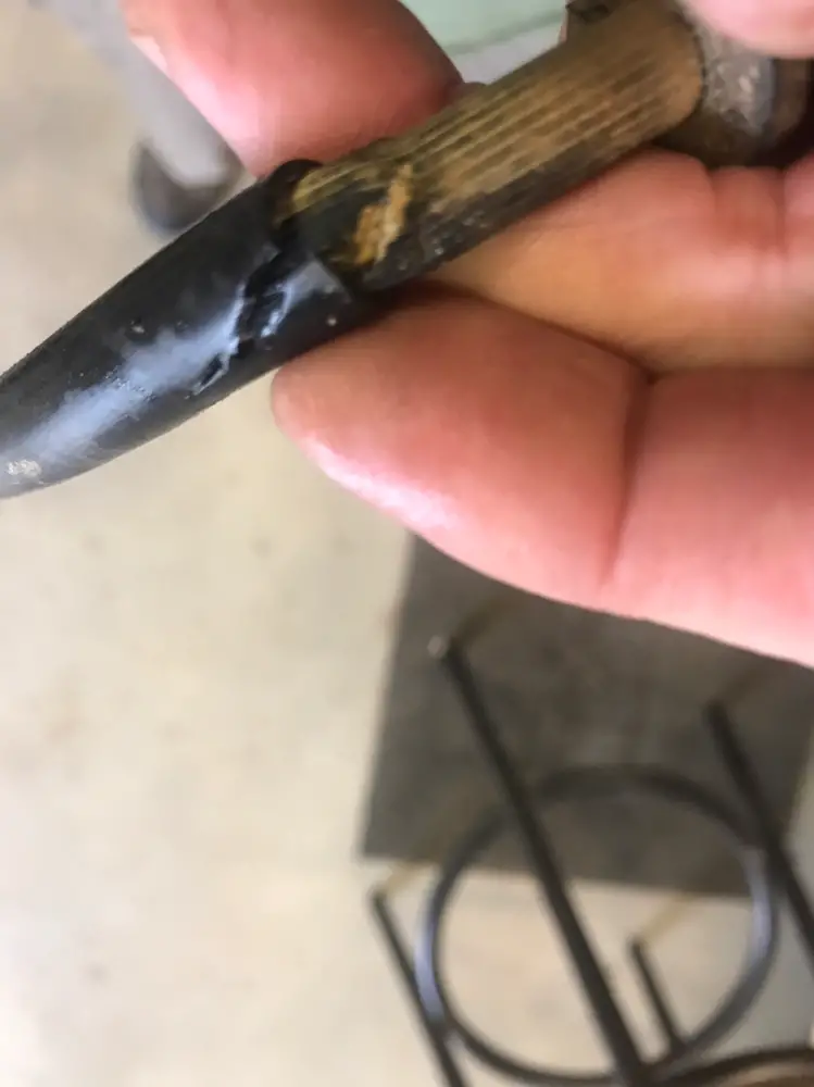

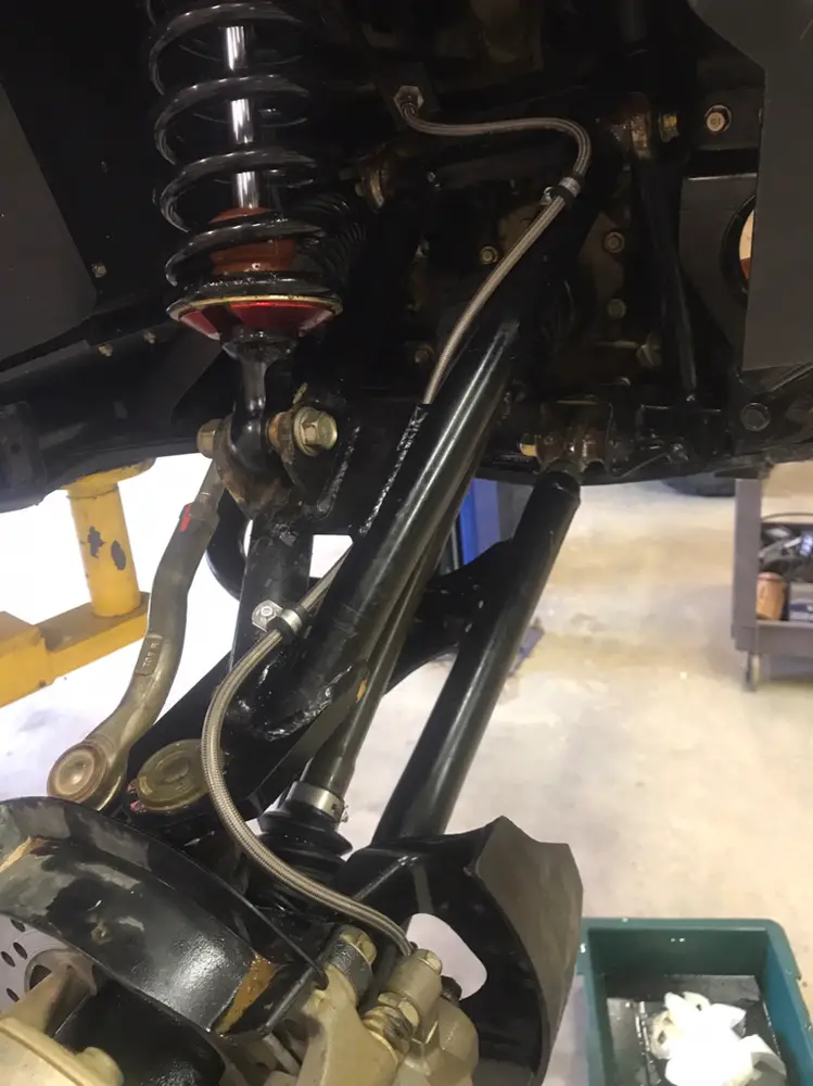

Then I finally got around to installing the SS brake lines from @jak9922. Really nice kit. It came with everything needed. Easy to change.
I upgraded because of recent failures at the Takeover. Those had me worried. Then I saw this cut in one of my lines...
D38ce8346a134b30a35e2f0f897c3e88
No need to worry anymore, these lines are stronger, moved to a new location so they don't get pinched by the tie rod, and they're a little longer. Longer is better as the stock lines were stretching a little with the lift kit.
44e2c5228eea85b718e55e13cdb889bf
It's just an added bonus that the brakes feel tighter now. They are great!
