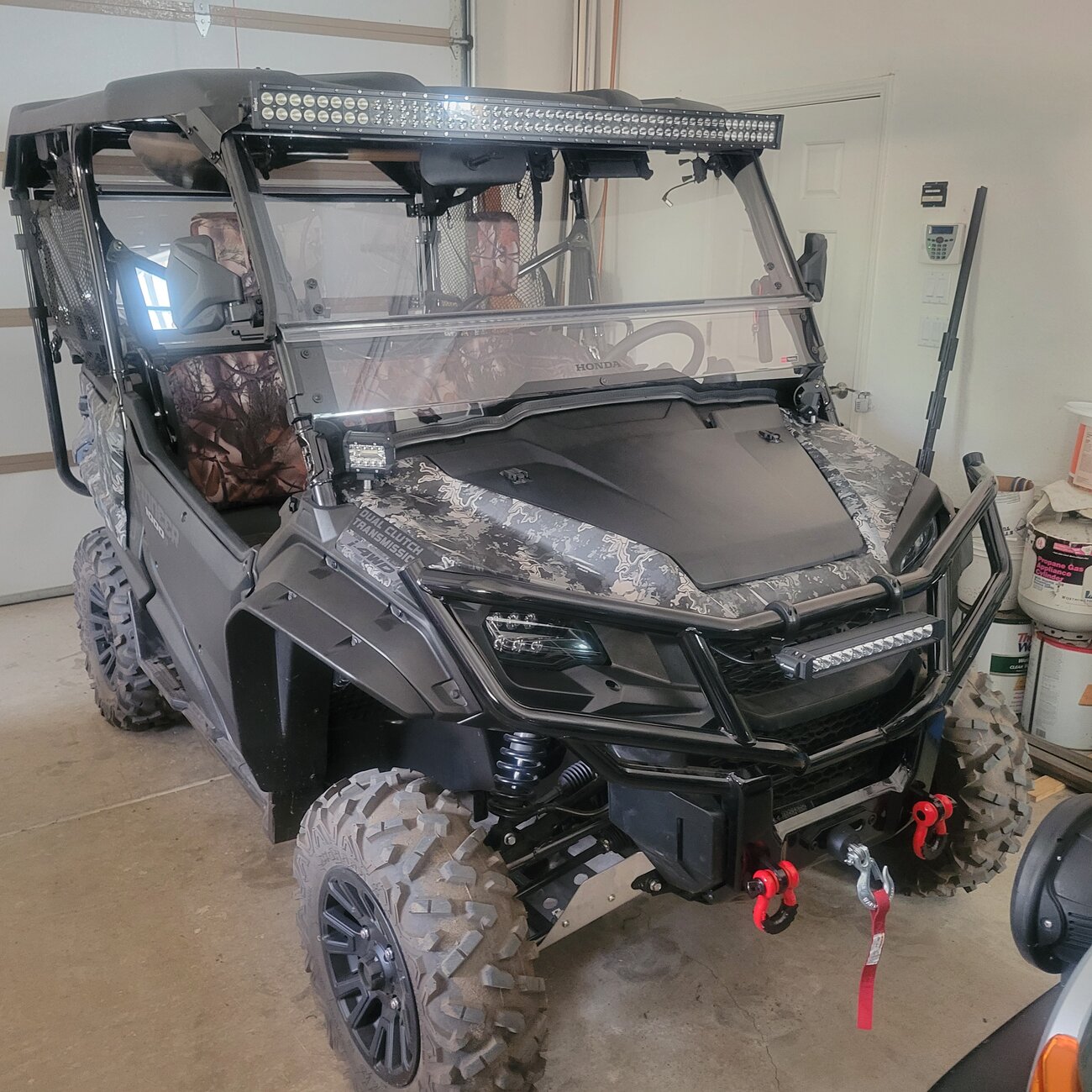

The 54" Nilight light bar is advertised as 312 watts which would be 26 amps at 12 volts. I measured at 16.5 amps or 198 watts. Still, a very bright light.

The 54" Nilight light bar is advertised as 312 watts which would be 26 amps at 12 volts. I measured at 16.5 amps or 198 watts. Still, a very bright light. View attachment 328844
That's surprising and interesting.
I would have guessed the manufacturer, distributor, or retailer would claim lower than actual current draw.

Yes, but what it's turned into is a "watts" advertising race. Most consumers have not a clue that lumens per watt (or efficiency) is a more relevant metric than simply the power consumed in watts.
It used to be, that 100 lumens per watt was considered by some to be the benchmark for efficient LED lighting for aircraft landing lights etc. In recent years, Phillips and probably others (I'm not really up on this field) have exceeded 200 lumens per watt - astonishing - at least to me anyway.

Actually, accurate voltage readings are *very* helpful, IMO. That my 54" light bar is drawing 16.5 amps is nice to know, no question there. If my voltage is falling below 13.5 or so while running, I know that switching that big light off will likely make the difference I'm looking for. But having a panel mount ammeter, while nice, for sure isn't critical - system voltage is.
At rest, 12.6 volts is good. While cranking, staying above 10.5 is good. While running, voltage in the 13.5 to 14.7 range is good. If the voltage stays above 13.5 while running with accessories on, then the electrical system is keeping up with load demand.
