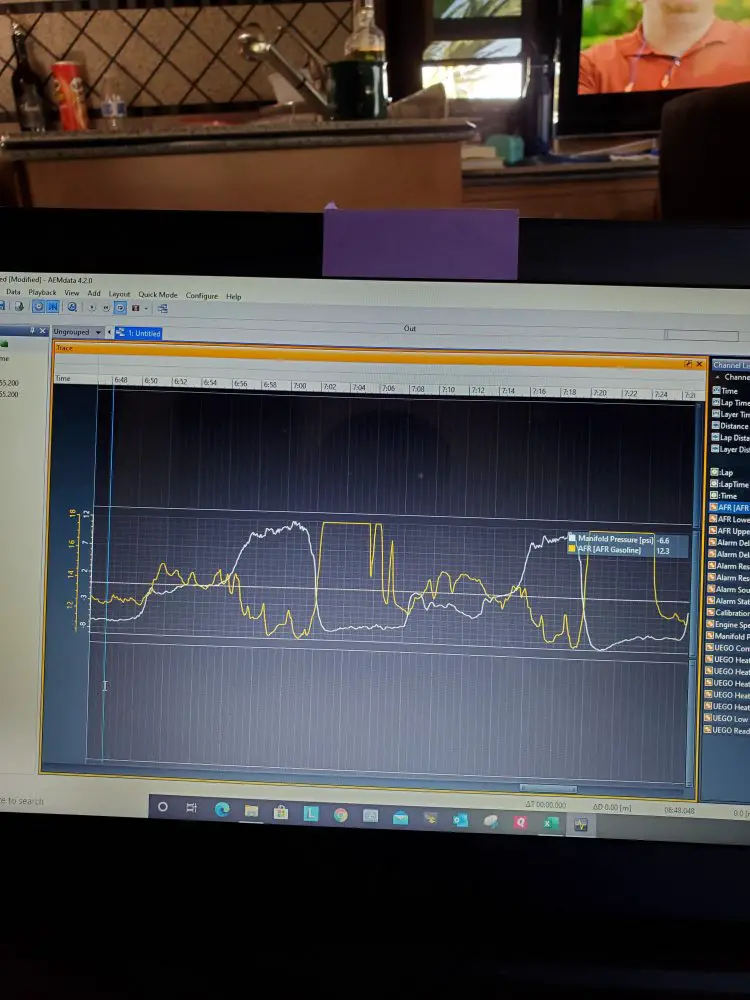

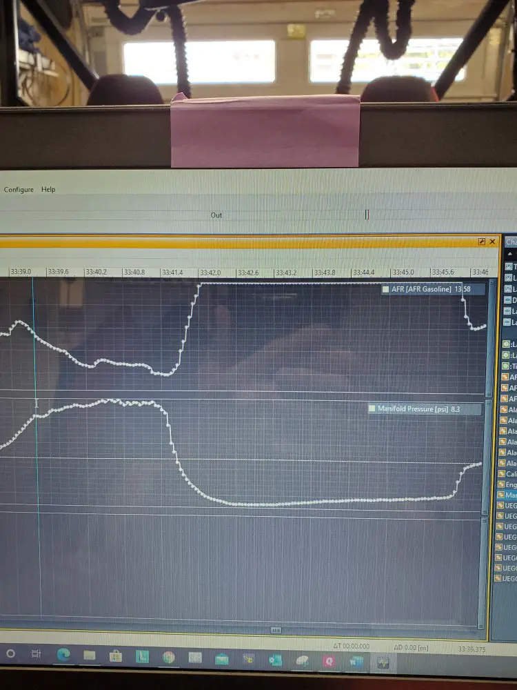

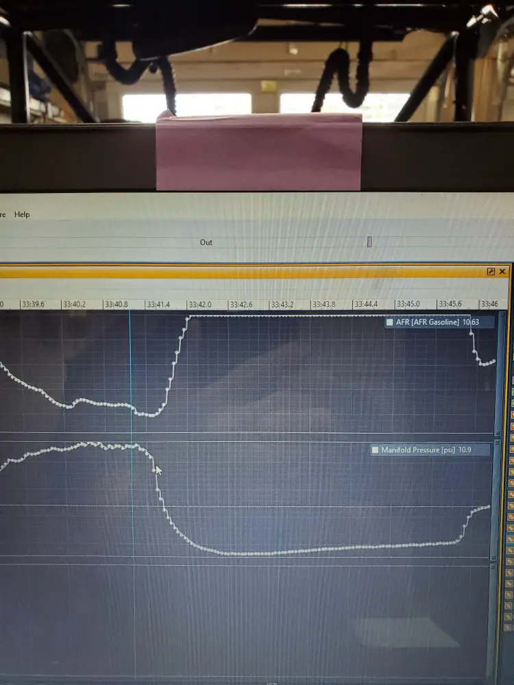

Here is a trend off my AFR/ Boost gauge, as you can see while building boost the afr is all over the place. After talking to someone that knows much more than me his opinion on the afr fluctuation is throttle input related due to foot moving on the pedal over bumps. I will post a few more graphs and it does go rich enough Probably over rich but takes a bit as it looks on the graph but the snapshot in time is only about 3 seconds.

From my simple observation, it looks like the fuel tables need to be smoothed out some in the lower boosted sections. The first part of the graph looks good but the second part where the boost looks to build faster than the first part is when AFRs look high.

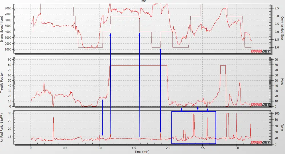

If you are expecting to see what you see from dyno runs, you won't unless you test on a dyno. You are going to be hard pressed to get a smooth log without a dyno. What you posted there looks somewhat normal (although a little rich in my opinion), especially if you are on a rough road or otherwise not able to hold steady throttle pressure. It shows more fuel during more boost and vise versa but you should evaluate more data in a controlled environment.
In the absence of a dyno, find a nice, smooth, steep PAVED hill. Start at the bottom, in manual shift to 3rd or 4th (lugging the engine as much as the DCT programming will allow) then steadily (but quickly) go to full throttle and accelerate to the rev limiter. Lather/rinse/repeat at least 5 times and average the results.
Also, you need more data. You don't have the entire picture there because you are missing data like TPS, RPM and Gear. Here is an example of a steep sand hill pull at full throttle on a stock tune. Notice choppy throttle = erratic AFR. Wide open the AFR is much smoother but there are still some blips in it and they correspond to shifts. Then there is a block of erratic AFR and the TPS is jumpy. This is normal and expected when not in a controlled environment...
^^^ this guy.
my turbo sled can have huge fueling issues if my clutching is off.
the load on the motor dictates usage.
