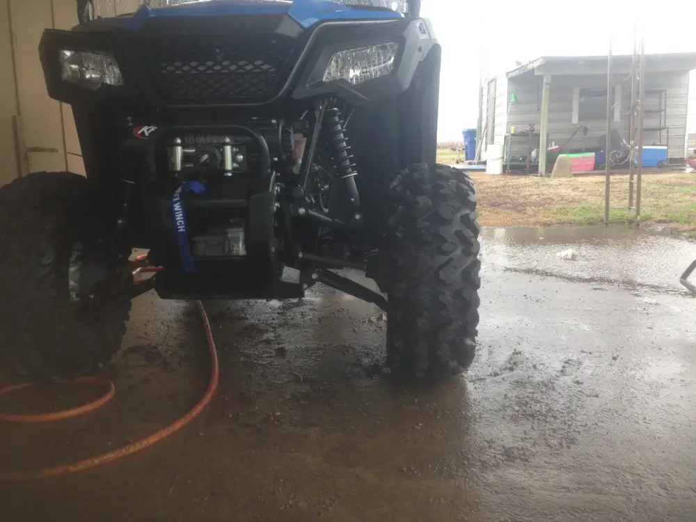

Well guys I need some help. Long story short is I found a ditch hidden by snow. Ever sense my steering wheel is off slightly. My driver side wheel appears to be towed in slightly. The bike steel drives straight and doesn't pull but my steering wheel is slightly off center. I've never heard of bending a ball joint but that's what I'm thanking. I can take more pics if needed but with my lighting a good pic was hard to get.
Jshell3
You may not have bent anything. For starters, you can pop the center cap off the steering wheel and pull the steering wheel nut and re align the steering wheel splines so it lines up and tracks straight again.
I would also say many Honda ATV's have a wide towed stance in the front. At least a look of being towed out. The larger the tires, the more the it seems to appear.

Measure each side axle center to axle center front to rear, if only side is shorter than the other you may have tweaked your A-arms on that side. Also inspect your tie rod for being bent. Either one of those can happen from what you described.

I know how to realign the steering wheel. Just wanted some advice first. If the weather would clear up i could check it out more. I might try the measurements also.

View attachment 31135 View attachment 31136 Well guys I need some help. Long story short is I found a ditch hidden by snow. Ever sense my steering wheel is off slightly. My driver side wheel appears to be towed in slightly. The bike steel drives straight and doesn't pull but my steering wheel is slightly off center. I've never heard of bending a ball joint but that's what I'm thanking. I can take more pics if needed but with my lighting a good pic was hard to get.
You didn't give us a straight on photo, and I read the previous posts, but I also think something is bent.

If the sun ever comes back out I'll get some better pics. The measurement of both sides are pretty much the same. My winch is a KFI 4500lb wide and I've never had to use it.
