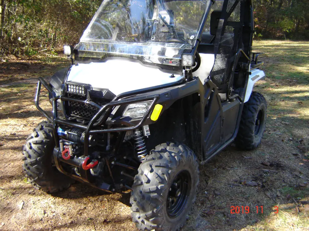

I added Walker Evans shocks today.It was not a bolt on deal for me.The WE shocks are about 1 inch longer than stock.This caused a problem on the front right.At full droop.the CV joint was binding a bit.[no problem at the other three corners].I assume this is because this is the shortest of the four shafts.I cut the front lower shock mounts off and moved them 1/2 inch out on the A-arms and re=welded.Not much of a change,but it freed up everything.Anyone else check for binding CV joints with the WE shocks?Now,the good part.These shocks are NICE!View attachment 164445
Wow, looks NICE. Love you tire/wheel setup! (like mine ;)

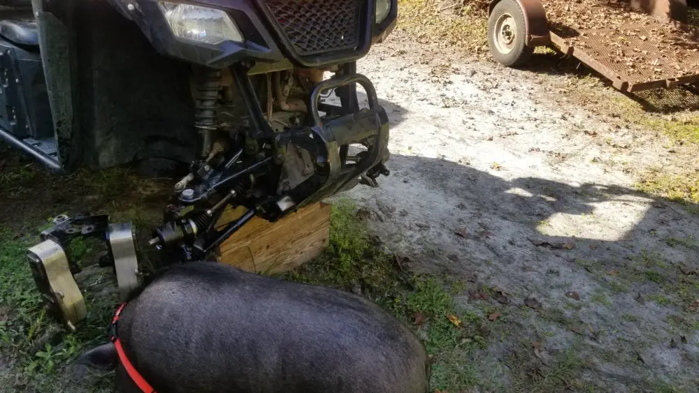

What did I do with mine today? Well I stripped the front portals off and pressed new balljoints in the upper a-arms, and cleaned up the stock knuckles and installed them back on in preperation for putting my 30s back on and putting it up for sale a month or so down the road. Gonna keep the portals and 35s for a possible monster P7 build at some point down the road, or if I get a hankerin for something different I may sell the portals and 35s for down payment money on something. Who knows. Mr. Wiggies was no help at all by the way. He just liked licking the grass where the brake fluid spilled out of the calipers. :)

Why you selling the p5? Just time for something different? Seems like a lot of 700's in your vids...so maybe a low geared 700 is the key.
