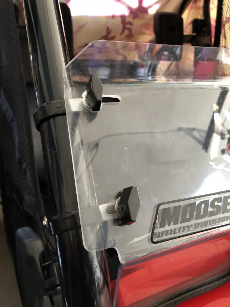

If you bolt on the Moose windshield it is not practical to unbolt it when you want to access under the hood. I bolted the straps to the cage then added some knobs for easy removal. Easy fix, it just always bugged me. That’s what I did!
I have the same issue with the Kolpin half (more like 1/3) windshield. Do those knobs have a stud attached?
