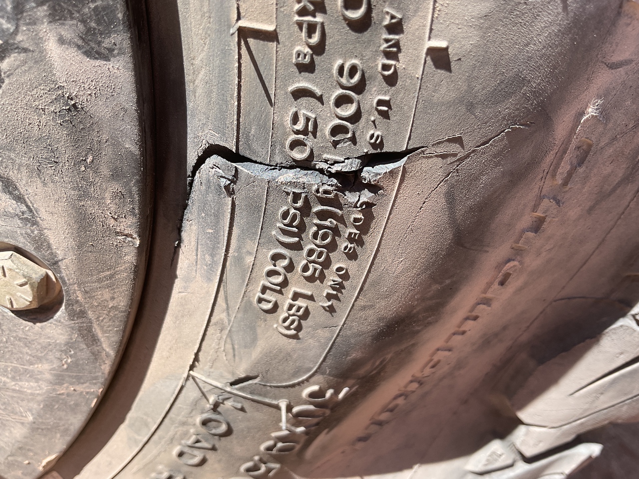

I'm comfortable with 9 fronts, 10 rears. Rode with some guys in Moab and they run even less. But that depends a lot on your speeds.
I did this on a front with 9 lbs, but it was a hard hit on a sharp rock hiding on the edge of the trail. 😢 It's not a pinch flat, the rock cut right through the sidewall.

I've never done anything remotely close to that, maybe scrubbed some tire black off. You are a maniac!

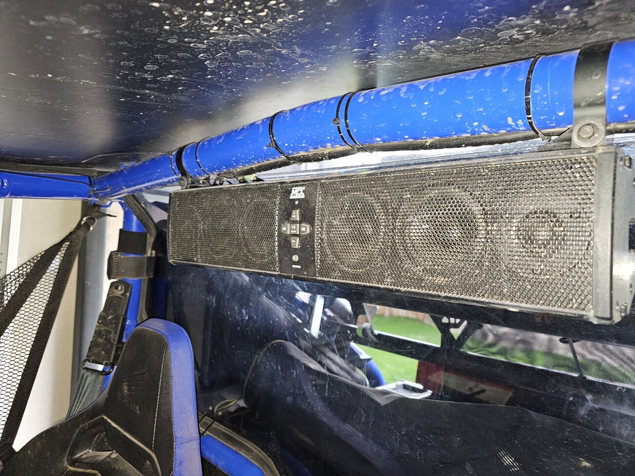

I also installed a MTX AWBTSW controller to run my sound bar so I don't have to turn around to adjust volume. The sound bar works fine with Bluetooth from my phone but I wanted easier control. The phone runs via BT to the controller which is hardwired to the sound bar. Unfortunately it picks up a growl from an electronic source somewhere in the Talon. Any suggestions how to address that? The soundbar is powered directly from the battery by the previous owner and I have the power to the controller running off a common switched/ignition bus back to a common ground bus.

AWBTSW controller on the left.
20230608 184044
I swear I have a windshield and rear window! Not sure how the speaker gets this dirty.

I also installed a MTX AWBTSW controller to run my sound bar so I don't have to turn around to adjust volume. The sound bar works fine with Bluetooth from my phone but I wanted easier control. The phone runs via BT to the controller which is hardwired to the sound bar. Unfortunately it picks up a growl from an electronic source somewhere in the Talon. Any suggestions how to address that? The soundbar is powered directly from the battery by the previous owner and I have the power to the controller running off a common switched/ignition bus back to a common ground bus. View attachment 391300
You need a ground loop noise isolator for the growl in the speaker

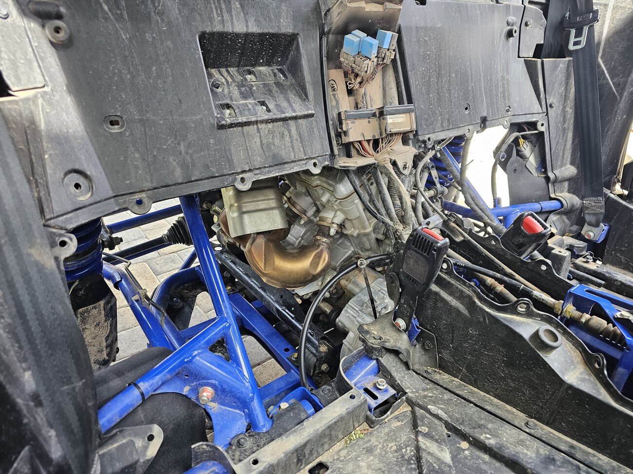

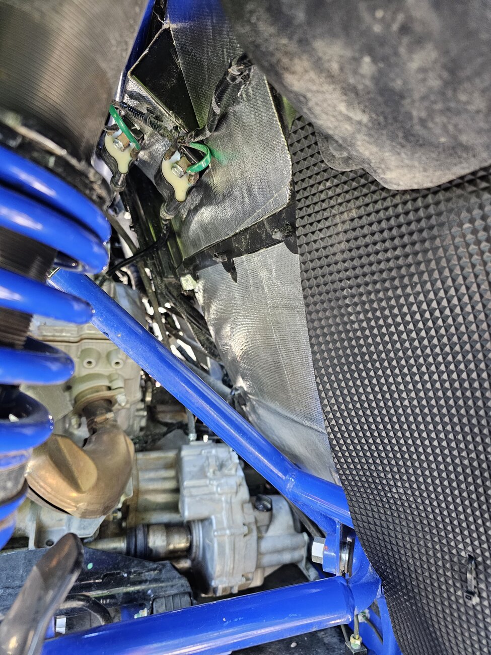

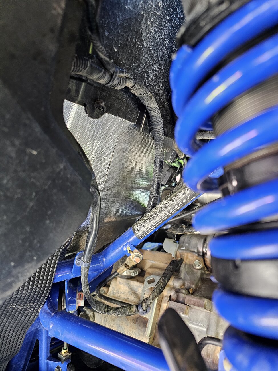

Ahhh, heat mitigation. Sticky back fiberglass shiny stuff. I pulled the lower piece from behind the seats and cut to fit all the way across. I was going to remove the top piece but that was way to involved. I managed to reach up and get some stuff on the passenger side. After dropping a seat bolt down in I removed part of the skid plate with no luck but did remove about 5# of dirt and rocks. So I removed the piece that's under the seat that goes to the floor. Kind of a PIA but not too bad. Found the screw.
Since I was that far in I pulled both sides of the center console off and lined them with insulation, along with the top and cup holders. Since I put the Kemimoto piece across the fire wall I used the old rubber piece to run up behind and under the passenger seat to hopefully cut down on dust.
Hopefully I'll get to test it out pretty soon and make sure the sticky continues to stick.
I've come to the conclusion that between 25 and 30% of the Talon's weight is plastic push pins.

Ground isolator will help but slightly reduces output. Making sure that no signal wiring crosses power wires will help as well. Placing them in loom and separating best you can if they do have to cross.
