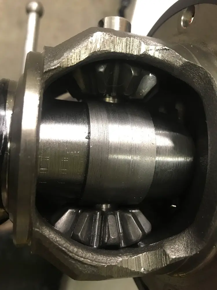

Hello everyone! I have machined a locking spool for P500. Just installed it for drivability and durability testing. It does NOT hop the wheels at all but I did notice the steering has a slightly heavier feel to it at very low speed tight turns. I should mention I do have power steering so this helps greatly. At higher speeds above 15km cant tell any difference at all. I am refining my 3rd proto type for testing/fitment and will bring it to market if all goes well... here is a few pics to check out.
View attachment 67631 View attachment 67632 View attachment 67633 View attachment 67634
I was just looking at your pics again and wanted to suggest that you make the section where the cross pin goes through as big a diameter that will fit to reduce the possibility of bending/twisting/breaking the pin (that would really suck)
Hey JWB . I will have a look at that tonight when I get to my shop. they way it has to fit in space wise is pretty limited. it slides in and has to turn sideways to fit. that's the reason for the ends being milled at 60deg .I will take a measurement for you and let you know opening size. I am pretty sure we wont have enough horsepower or wheel speed to break that pin. the pics don't do this any justice either. they use the same carrier in the 700 and if you think of the way it locks by using the right side axle to the carrier that means all the power would be transmitted straight through the spider gears and the pin would be holding all the torque. They are doing crazy wheel mods with those things and haven't heard of any breakage. I do get what your saying though. I might be able to make a spacer if or mabey the small gears themselves can take up the space.

907F14BD 1077 4F48 8099 5DB60F799A49
I have to figure out how to PM you cause I will have yours finished tonight ,will need your Email to exchange addresses..
Just checked it.
What do you think of this idea. I machined th OD down and you add the spider gears in as place holders.
That’s gota stiffened that pin up.
Much easier solution. NICE.
