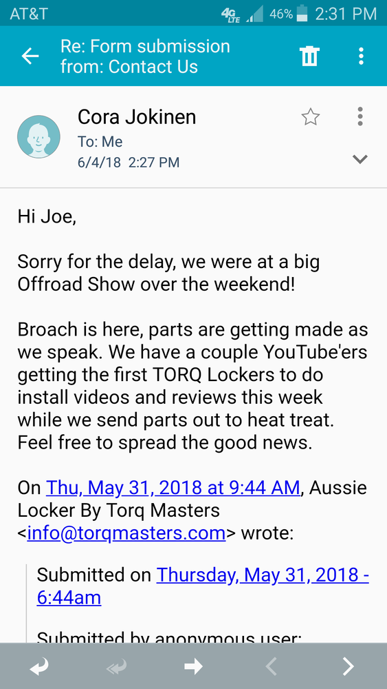

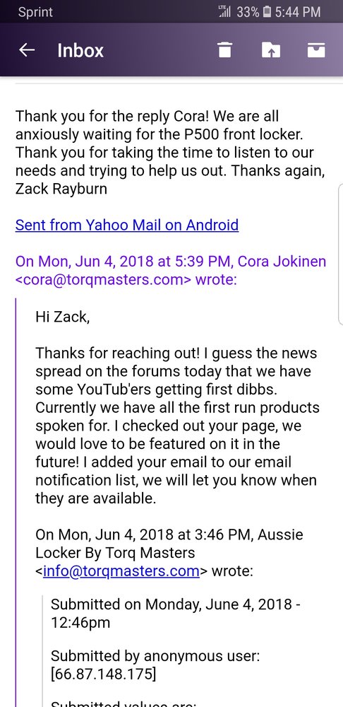

C
Chooglin
Good news
My email to her
Screenshot 2018 06 04 14 37 33
This is Cora's reply to my email !
Screenshot 2018 06 04 14 31 20
