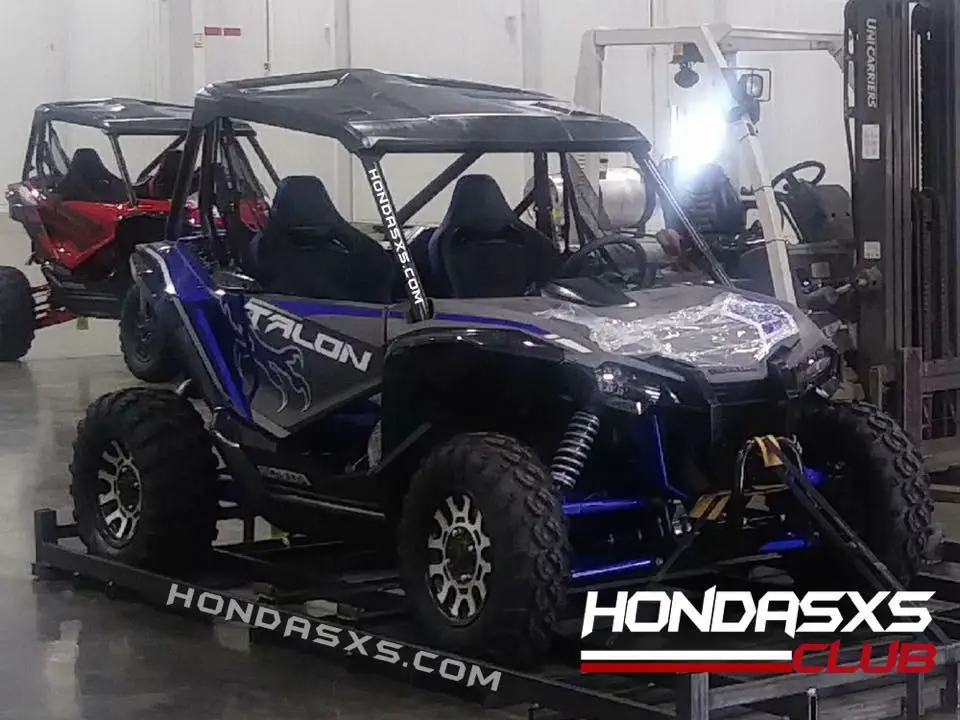

35481877 2094199140869129 5786604455738736640 n OK< maybe the locker is arriving exactly at the wrong time..

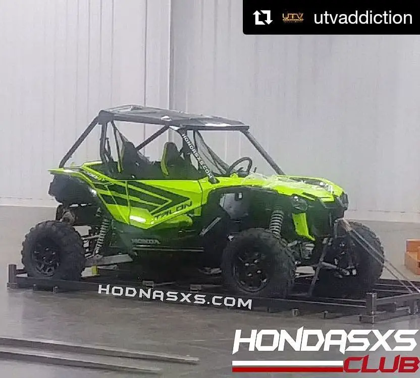

35544818 10204451776332189 4690859230813487104 n
JWB
JWB
837
2,098
California MD
View attachment 78917 OK< maybe the locker is arriving exactly at the wrong time..
I know a bunch of folks are gonna be excited about it, but if it aint 50" wide I'm not. I watched the big machines creeping, struggling, getting damaged, and unable to pass each other on the trails all day yesterday. Every time I think I want a go-fast/bigger machine, and then get on those mountain trails with my P-500, I always come home thinking I've got the best machine for the job. Those big machines wouldn't have a snowballs chance in hell keeping up with the P-500 on those trails, mostly because they barely fit. One mistake and the machine's wrecked. I saw three instances of that in just one day of riding!
But I hope the Talon kicks a**!!
and if they make a 50" version.....I think I'll be needing one...$$$:(

20,363
116,574
18,693
68,409
Hahaha go to the end of that thread and read, or just zoom in and read the HONDAsxs it’s spelled HODNAsxs Fake News! Lol.
It will be nice when and that’s a big when they finally get one out.
Proof its fake. Lol.
