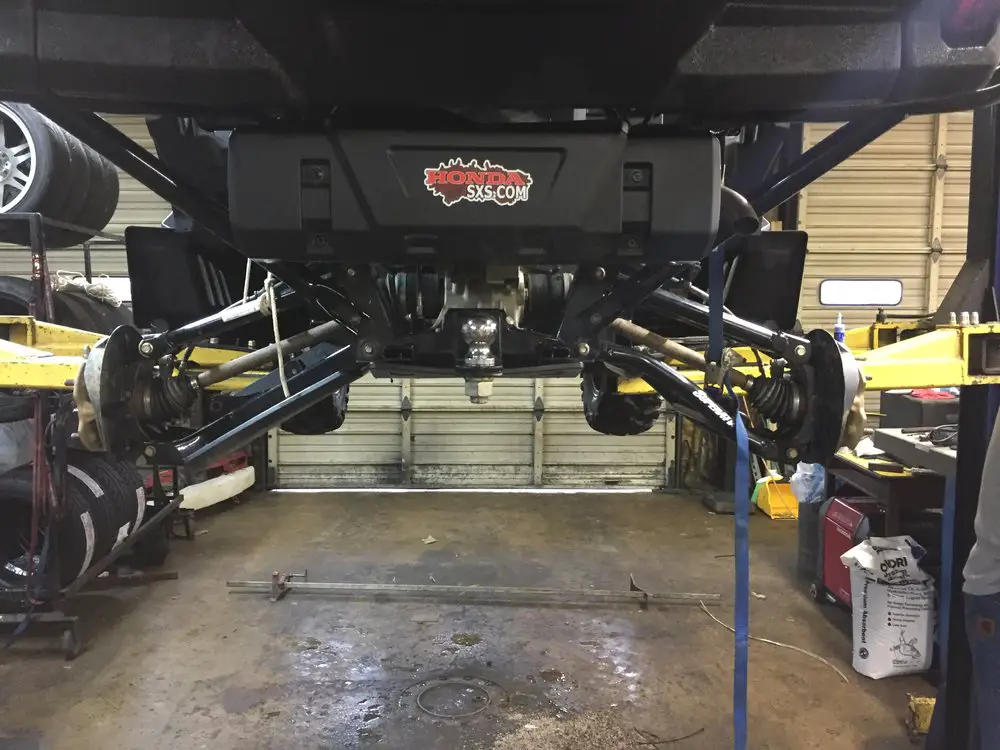

How about a picture of your adjustments with a tape measure for reference?
One thing I should have done is put an angle finder on the hub when stock at full droop and matched that with the new arms on to get the camber set with out having to put the wheels on and drop it and roll it, multiple times... Can put a straight edge on the hub before and after and measure to the frame in the same spot for the toe setting.

Thanks appreciate it! Your a good man! So how does it ride?
Been storming here really bad. So no test ride today. Its a two man job if you want to do it with speed. I got 3.5 hours in it. Really time consuming get caster and camber adjustments. Took 3 times and I'm still not happy yet. The directions they come with are ok. The 10mm starting number is really off when you running the lift. It did take out the camber problem associated with bracket lifts. My camber in at -1 degree and neural on caster right now. The numbers I listed is where I'm going next.
****You do not have to take out the axle nut to change the a-arms just use a racket strap to hold the a-arms up. I did lower first then upper. You may have to take a hammer to the frame brackets that hold the a-arm. One of the arms was about 1/16' out from lining up.
When you do adjustment you have to take the bottom shock bolt out and both lower a-arm bolts out. Lift the hub up and pull the lower a-arm out. The pivot block on has about 1.25' -1.5"' of threads.

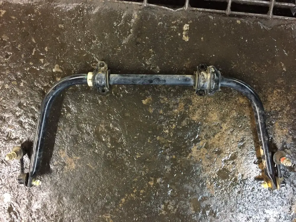

Sway bar removal was only 4 bolts and 4 nuts on the end links. I going to have to dial in some preload on the drivers side to compensate for the sway bar. The added weight of the battery on the set and the driver makes it droop on the drivers side.
My camber start was +6 at full droop with stock a-arms. 0 degrees at full droop with superatv arms.
