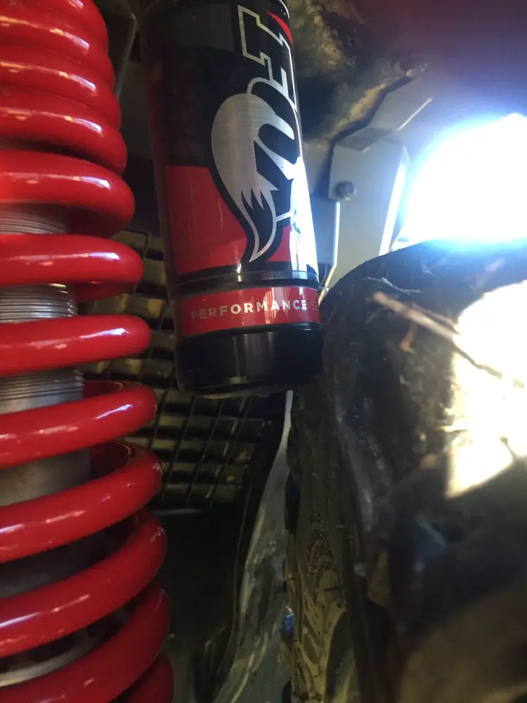

I has wrong @CumminsPusher need 1 1/2" after the camber was correctedThose are only 1"?
I've never seen that. Will you have to run 2"?I has wrong @CumminsPusher need 1 1/2" after the camber was corrected
Slasher makes 1 1/2"I've never seen that. Will you have to run 2"?
...? Don't understand question @CumminsPusherWhat's that leave for clearance?
Shock reservoir to tire- if Foxs mounted not reversed is 7/8"
@Windrock1000 , Is that with 5x3 offsetNo you're probably right. I was just thinking these low pressure tires move around a bit but that is probably sufficient.
Mine are 5x2 offset I believe. STI HD5 rims@Windrock1000 , Is that with 5x3 offset

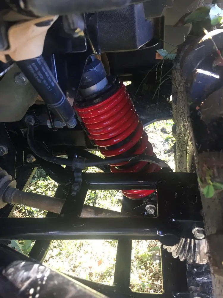

But I should be good with 4x3 @ full front compression Right?View attachment 37317 View attachment 37318 View attachment 37319 View attachment 37320 View attachment 37320 View attachment 37321 Testing with the swap bar off. Bad news for High Lifter bracket lift and fox shocks.
Front shock in the tire at full compression....
Good catch!View attachment 37317 View attachment 37318 View attachment 37319 View attachment 37320 View attachment 37320 View attachment 37321 Testing with the swap bar off. Bad news for High Lifter bracket lift and fox shocks.
If i'm not mistaking, it looks like you have the HL lift and A Arms? Now do you also have spacers on the rear to be able to mount the shocks that way??f
Bam!
pull the lift... you won't miss it when you go to 30" tires, which you can do now with the forward arms and inch of coil spring load... that's my plan.View attachment 37317 View attachment 37318 View attachment 37319 View attachment 37320 View attachment 37320 View attachment 37321 Testing with the swap bar off. Bad news for High Lifter bracket lift and fox shocks.
