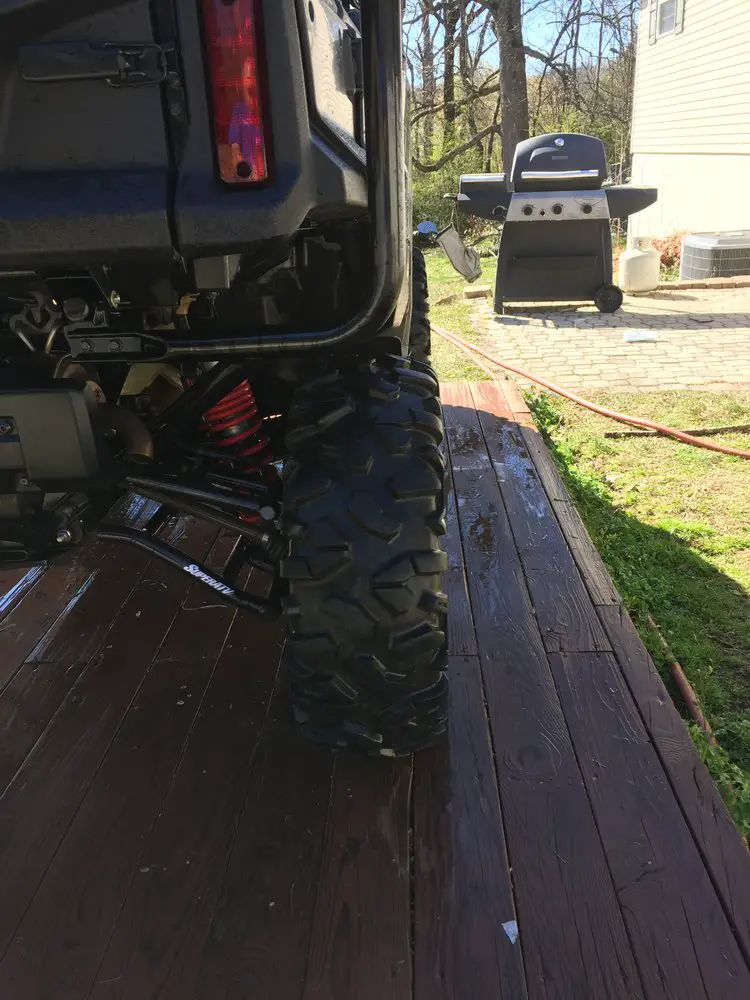

The HL lift + fox shocks require spacers to avoid the front shock hitting the tire during compression with a 5+2 or 5+3 offset rim. I'm running 1" spacers in the back with none in the front but running 4+3 offset. Still have to test to make sure it doesn't touch during compression. I have 28" right now but also run SuperATV rear a arms which moves everything back 1.5".

I've been proven incorrect! Once again! Mine rubs extremely bad without lift.
Whatcha mean by once again? You're not wrong very often I pay attention you save me work

Should have added a disclaimer on true tire size. I like 15# in my roctanes and the come in at 28.5". Evos (for which I don't own but like) run a little smaller as I have read. @JTW is running Trail Armor skids so it will rub if he runs a true 28" tire with out lift or forward arms. I had to trim a good 1" to stop most of the contact. So can be right and wrong at the same time. I know the a-arms take a lot of time to dial in. I'm betting I've got 8 hours changing setups. I love how she seats now. Each setup is different. Political Correctness now! Thank you for keeping me straight. Had more than one Margarita today!
