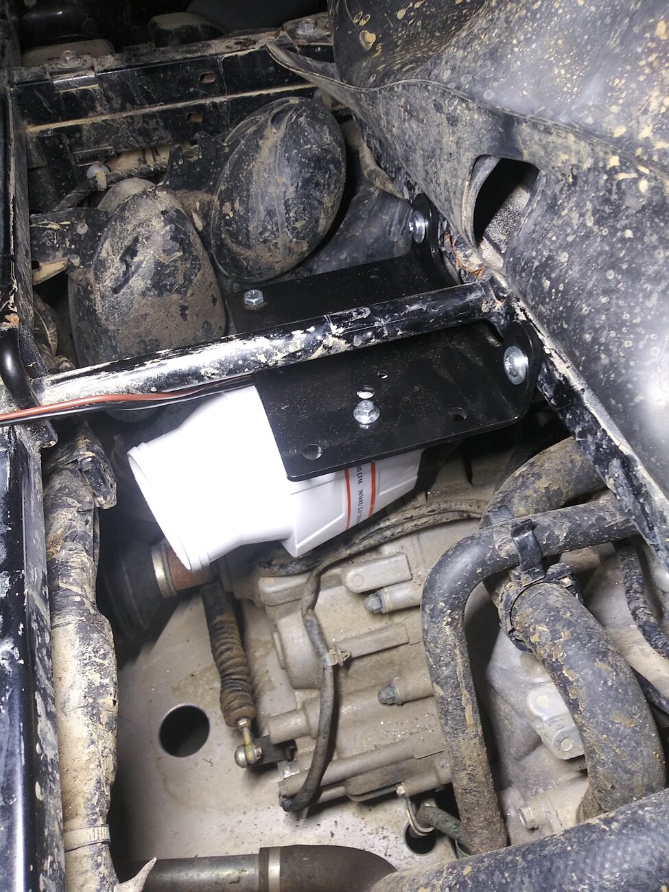

Lots of different ways to mount the under seat fan mod. I used a spare winch mount I had laying around. Fits perfect and aimed it straight at the headers, blows all the hot air out the rear passenger side wheel well 👍
That looks slick as well but these top covers on the '22 models won't allow for anything 1" or wider on either side of the round bar up top....I want the fan for the just in case scenario lol

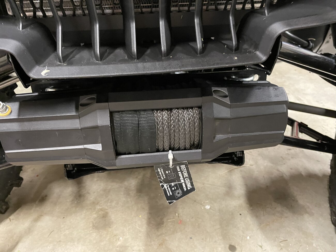

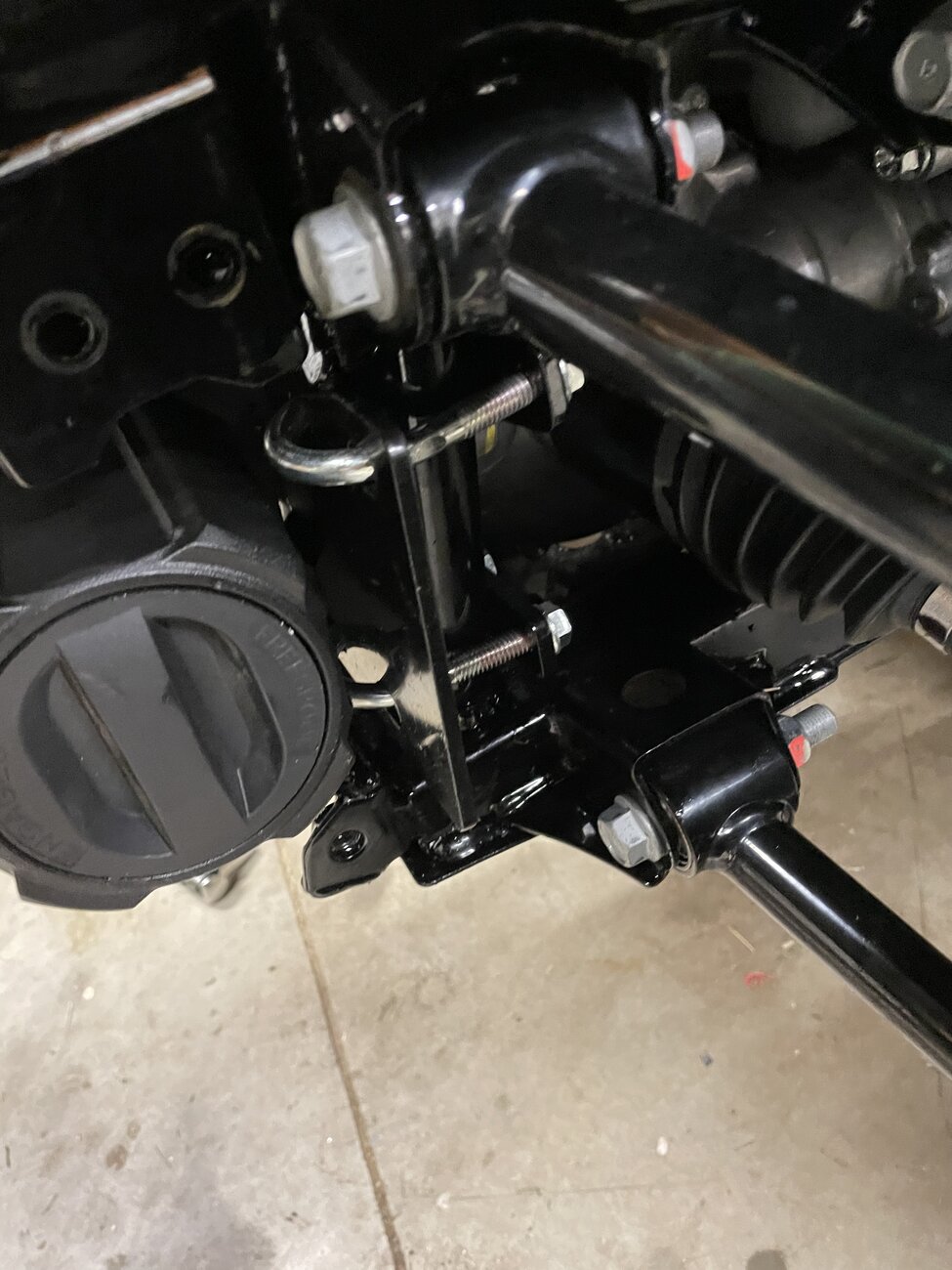

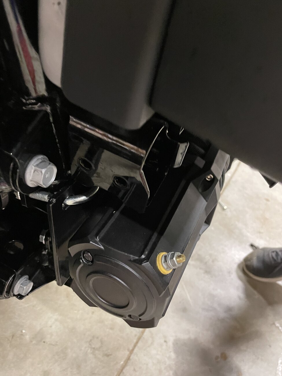

V2 Viper Winch 6000- awesome looking winch. It took some time to get nuts threaded on u-bolts by myself but it got done😤. Would have been much easier with another person to help. Even though I struggled a bit, this thing is awesome. No problems with fit. Looking at the Trail Model, the deluxe did not have the side plates (or mine didn’t 😜) that cover the winch. I had plenty of room, no fit issues. Just as @Hondasxs described in the earlier posts, you have to get the top of the mounting plate under the tab of the frame when installing.
I did not wire it at the time of mounting to the Pioneer. I did all my wiring at one time.
View attachment 336660 View attachment 336662 View attachment 336663 View attachment 336664
Just noticed your winch mounting. I realize that the front bumper on the ‘22’s may be different, but on my ‘18 they recommended flipping the winch over so that it winds in from the top. Much better angle on the rope.
Yeah that was what the instructions said but was for the elite. @Hondasxs recommended mounting it the way it is mounted.
18,690
68,377
When installed opposite, it does not clear the cross member. The cross member is not made to handle any pressure. It will snap into being cast aluminum.
