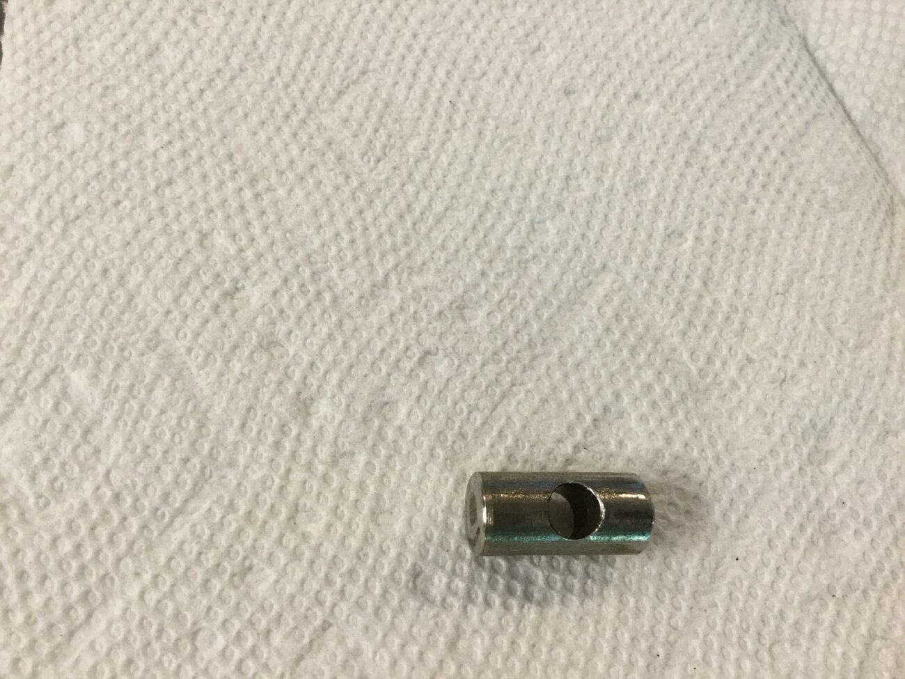

46EDB508 337A 445E 88E7 16B5467E4486
I ended up making a 3/8” spacer to add in to be able to adjust my 22. Been fine since.
