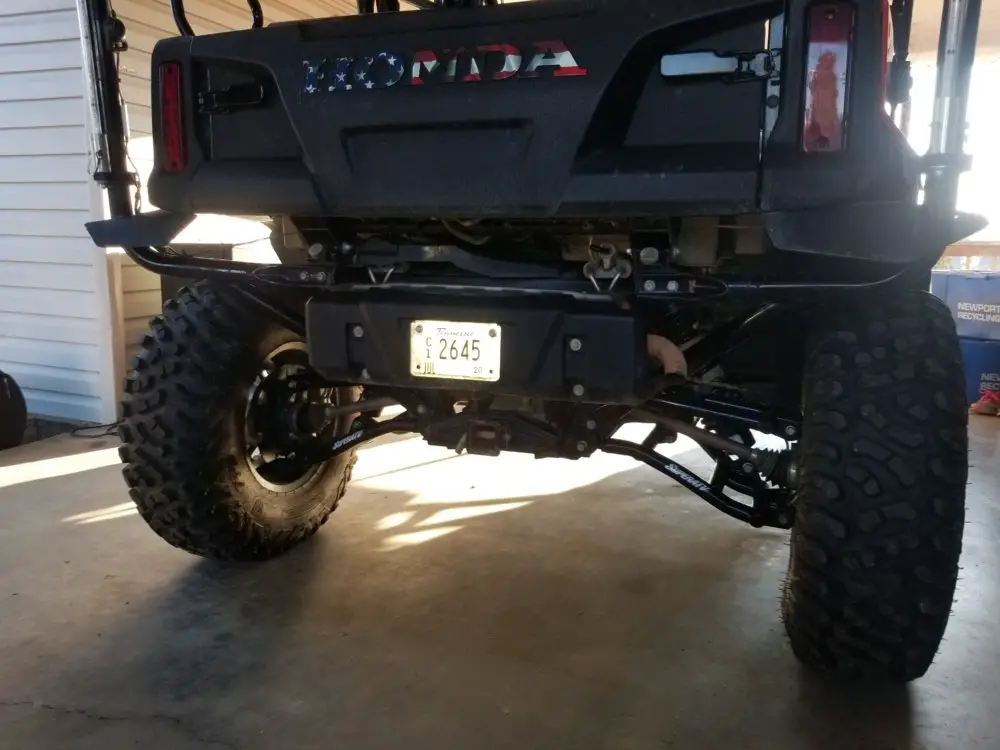

After doing the front arched A arms, I just had to do the rears as well. What a pain in the ass! The fronts went on so easy, but nothing lined up or fit in the rear. Had to use a hammer, pry bar and grinder to get them on, but they are on. Also decided to put the steering stops in, just be safe.

What part did you have to grind? Did you adjust the T parts at all? They say they are suppose to come pre adjusted for camber now so was not sure if maybe that part was out of wack.
Mine are tight where the outer hub goes into the ends of the A arms.
One of the shock mounts had a blob of metal in it big enough that the shock would not fit deep enough to get the bolt through, and one side on the lower A arm, where the hub mounts to the arm. It just would not fit. The hub was wider than the opening in the a arm. Most all the frame side mounting points needed some bending or hammering.
I PM'd super ATV about it, and they said the fronts are usually the easiest but sometimes the rears are a "bear" to install tolerance wise. Just my luck I would get that bear. :D
I had to enlarge one of the lower shock mount holes in mine.

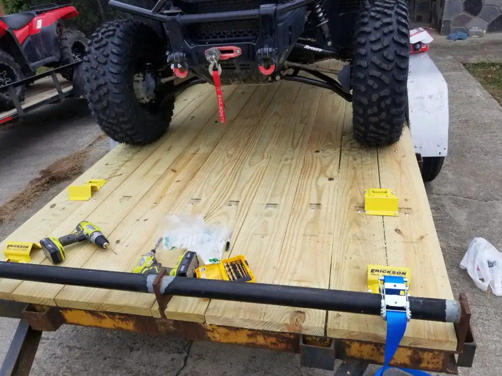

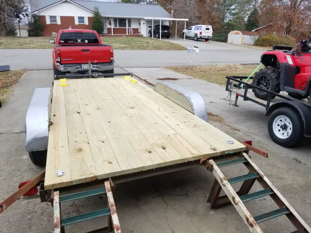

Finally got my trailer re decked and got the Erickson wheel chocks on as well a a few extra D rings.
View attachment 167654 View attachment 167655 View attachment 167656
The new deck looks great on the trailer. Can I make two suggestions from my experience. One, but heavier duty d-rings on, I had those on my trailer and when someone decide to lock up the breaks in front of me when a deer crossed the road, it ripped all 4 d-rings I had like that right out of the floor, it wasn’t pretty. The sxs would have been into the back of my truck had it not been for the electric trailer jack that saved my truck. Since then put heavier duty D-rings in. 2nd, I discovered a great way to preserve trailer decks from rot and to waterproof them better than Thompson water seal which just washes away, is used motor oil believe it or not. Yes it darkens the wood but there’s no better “oil” based wood protector the waste oil. It’s free, soaks right in, and helps keep the trailer deck from rotting. Reapply ever 2-3yrs or as needed. I use it on my 18ft utility trailer and my utility trailers I used behind the tractor, haven’t had to replace a board since. It just a thought, hate to see you have to replace good boards. Other than that, keep the thread going, your doing a great job and love the machine, it looks great.
