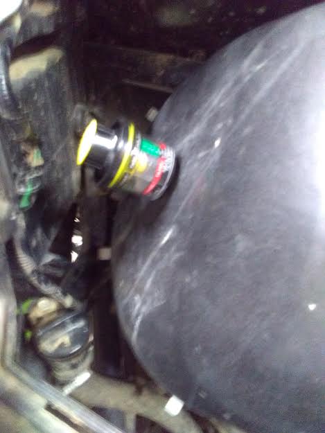

I had to look alot to find a minder that did not start at 8" h20 or higher. Found one at NAPA on line that 1st number was 3. Running the Talon with fresh Twin Air it barley moved the minder, maybe what would be 1" h20 if it had more numbers. I hope the filter works as good as Wigglysqiggly says. If it doesn't I will take it off and put a 250R Twin Air on it.

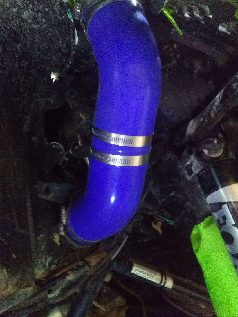

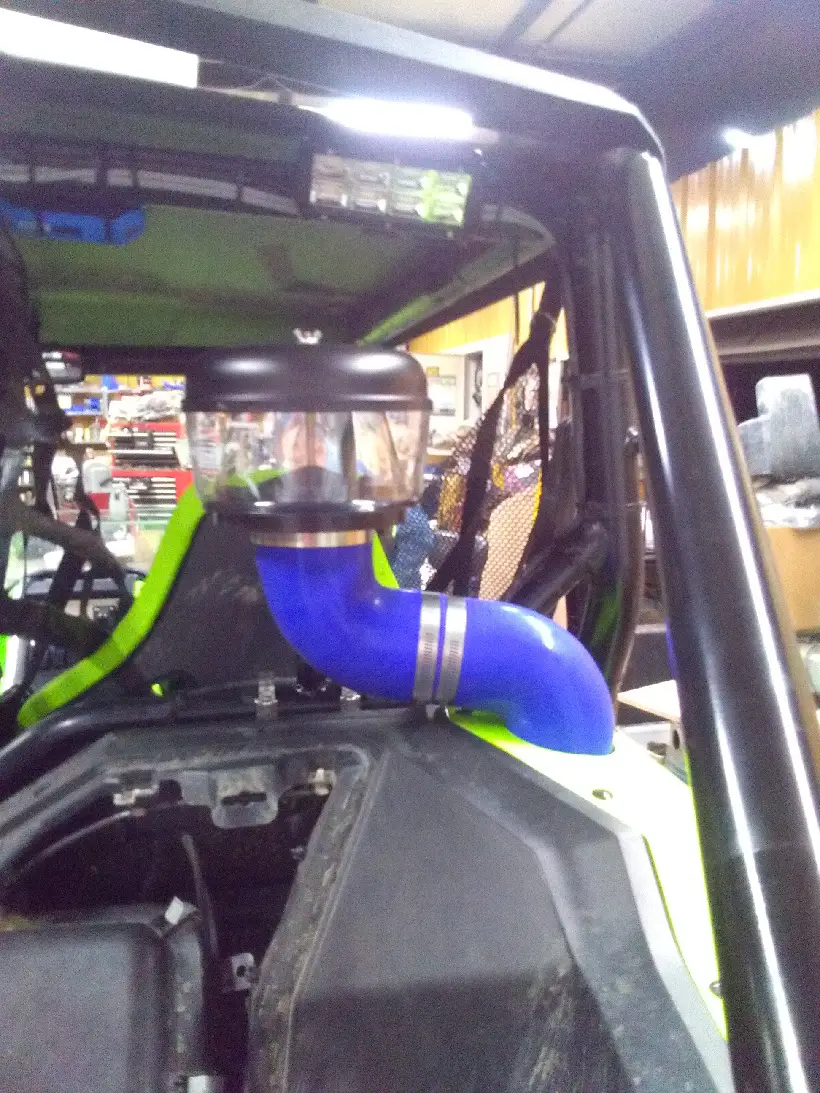

Got the Roto Pax mounted.

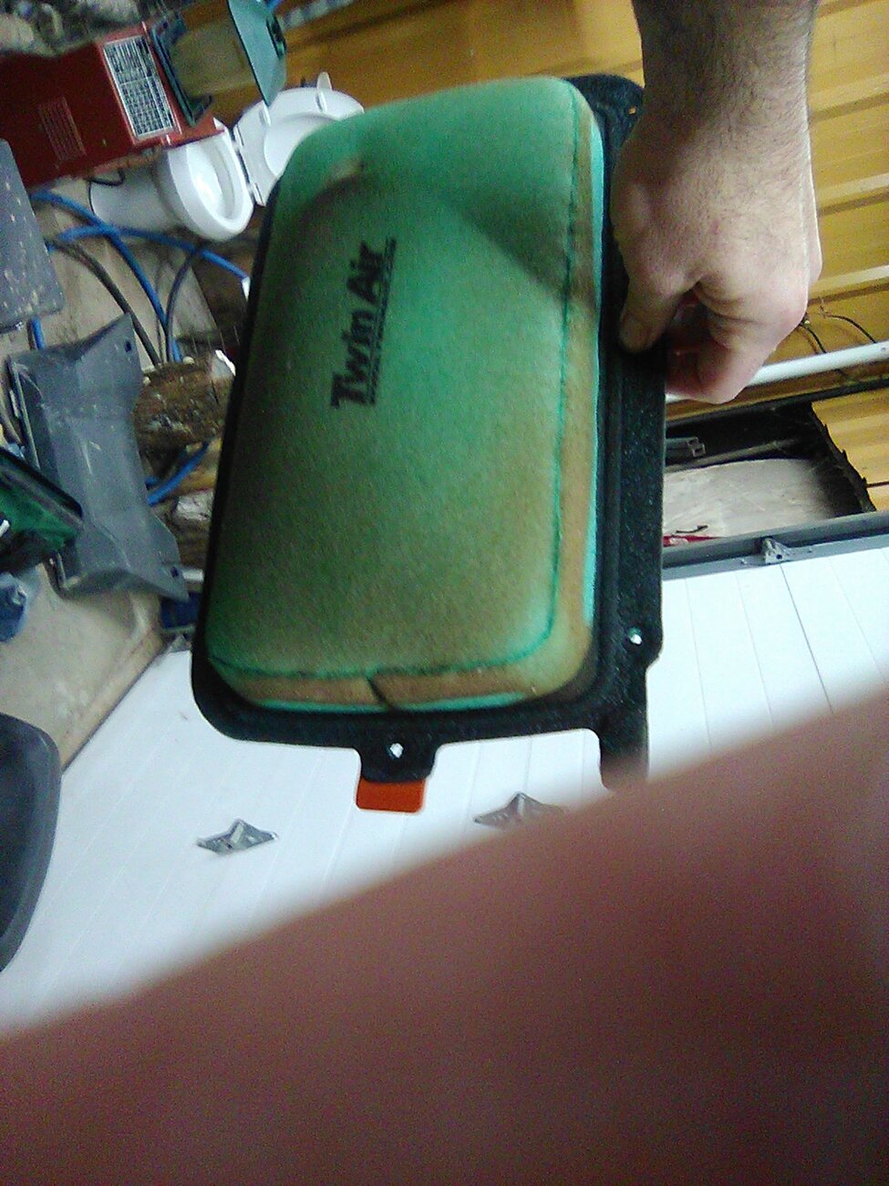

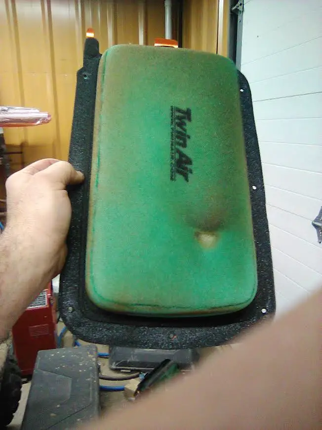

3 weeks ago now I got to go on a dusty ride. I rode tail and tried to avoid all the dust I could. Here is what came out of my cyclone prefilter.
F1
Not much bit we only rode about 38 miles. Bad part is my filter minder was showing 8 in/O. This is where I decide I would clean the filter as on my test rides with everything brand new it pulled 1 in/O. So I take the filter out to clean it and it still as green looking as it came out of the package. So I now have to rethink my filter minder. But good part is the cyclone prefilter keep the main air cleaner clean. @CumminsPusher

Yes so far could not be happier. But I want to get the filter minder figured out, so I do not have to remove the air box lid and take filter out just to check it.

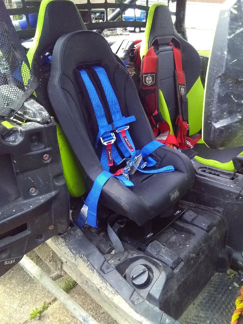

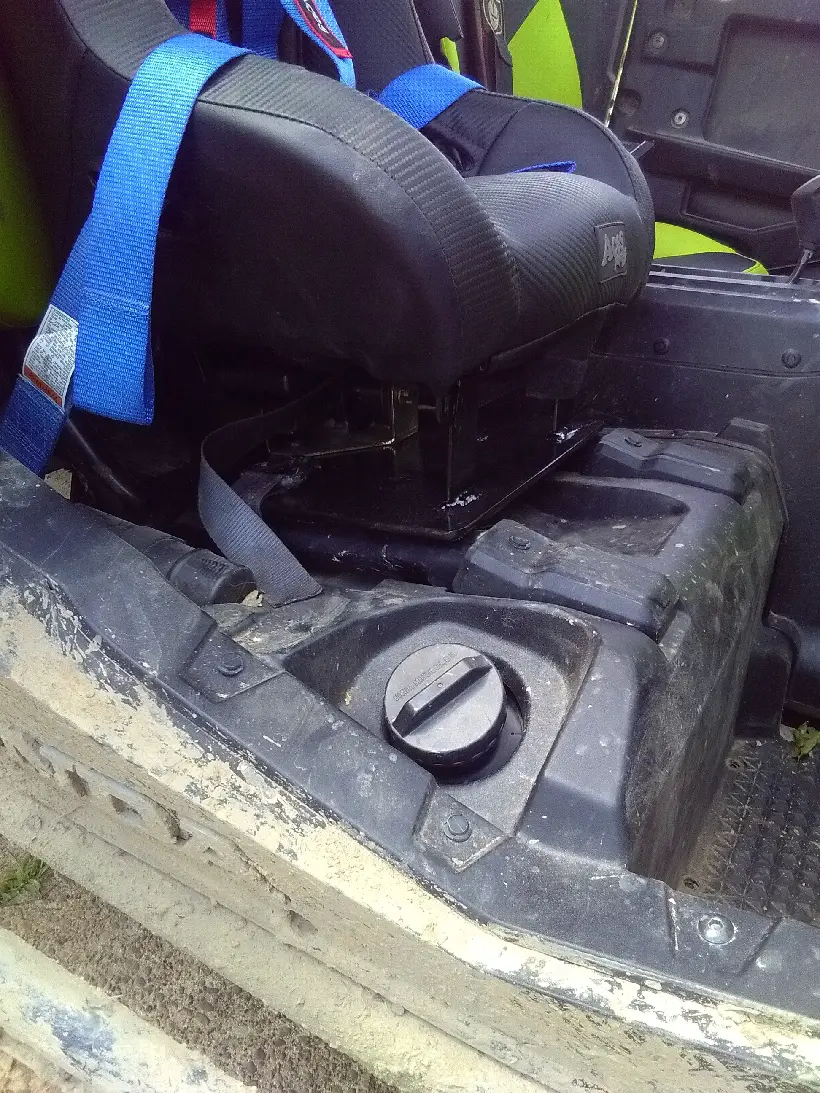

Bought a Ace's mini seat for my son. Did not like how it worked just using it as a seat insert. So into my Dad's shop then he and I built a seat base that fits into the the factory seat base so I can change back and forth from stock to my son's mini seat. My son is not crazy about riding in the Talon, he would rather ride his quad. But he does not like me taking the Talon out riding without him, so he tells me he will ride all day, but might take a nap. He usually falls asleep in 5min when we go back roading. We also modded the oh s*** handle to where it comes out longer so he can reach it. Plus with the mini seat mounted, H&M police can not call it a booster seat.

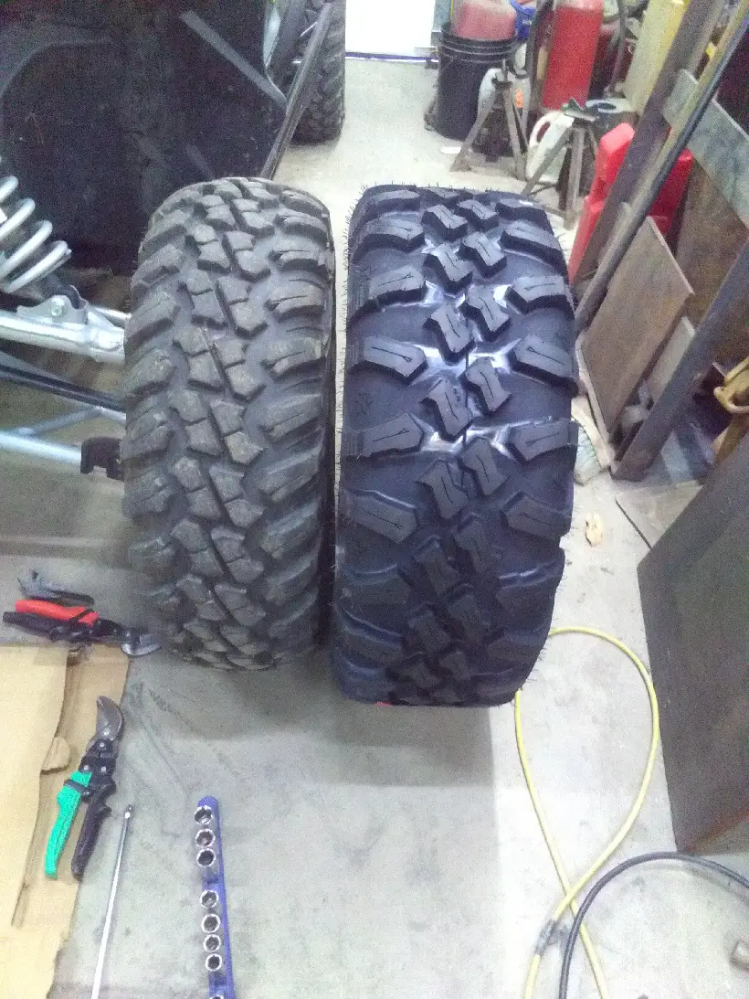

Also got a set of Tusk Mega bites 30x10x15, had the 28x10x14 Terrabites on my Maverick and worked well except in real wet conditions. Have them on the Talon right now. So thought I would try the Megabite. Have STI HDI 50mm off set rims coming today. Have 5 of each so I have a matching spare. Have RB3 wheel spacers coming to get the rear back out to width. Started on the removable spare tire mount yesterday, back to real job today so on hold till monday.

I had Terrabites on my 14 Maverick and at 1st on my Talon. I really like the Terrabites except for real soupy citations. Ran them 3 years with no flats and they wore good. So when I bought tires for the Talon I wanted something a little more aggressive for the soupy places. I have been to H&M, Wellsville Ohio, the old Rumble on the Ridge riding area, couple local places, and back roading with the Megabites. I really like them so far and will buy them again when this set wears out. I have around 1000 miles on them between back roads to muddy trails and they are working well. I have had to be on black top more than I want and they seem to be wearing really well. They are the same carcass/rubber compound as the Terrabite.
How'd you attach the seat to the base? Could you take a few pics of the underside? I'd like to do something similar to my kids Aces seat.
There was places in the seat base to bolt too. I will try and get you some pitures with the seat out of the machine in the next few days.
Ye I felt the same. Just touched up the one spot that isn't green in the picutre and going to run it another 500 mikes and check it again. No dirt what so ever in the intake tracks for the FI, so the filter is doing its job.
I don’t think I’d bother checking it again in just 500.
