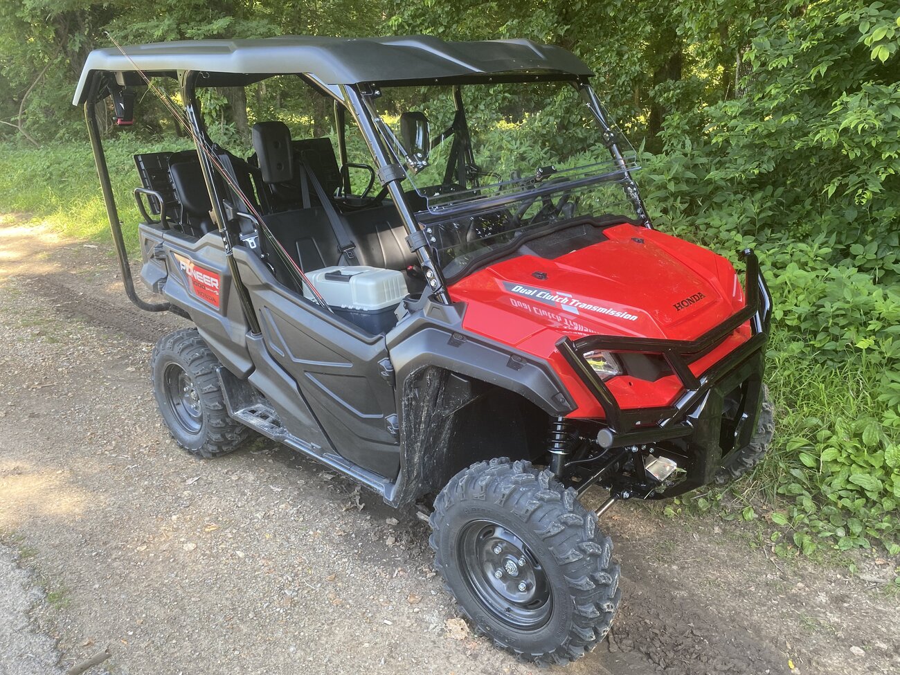

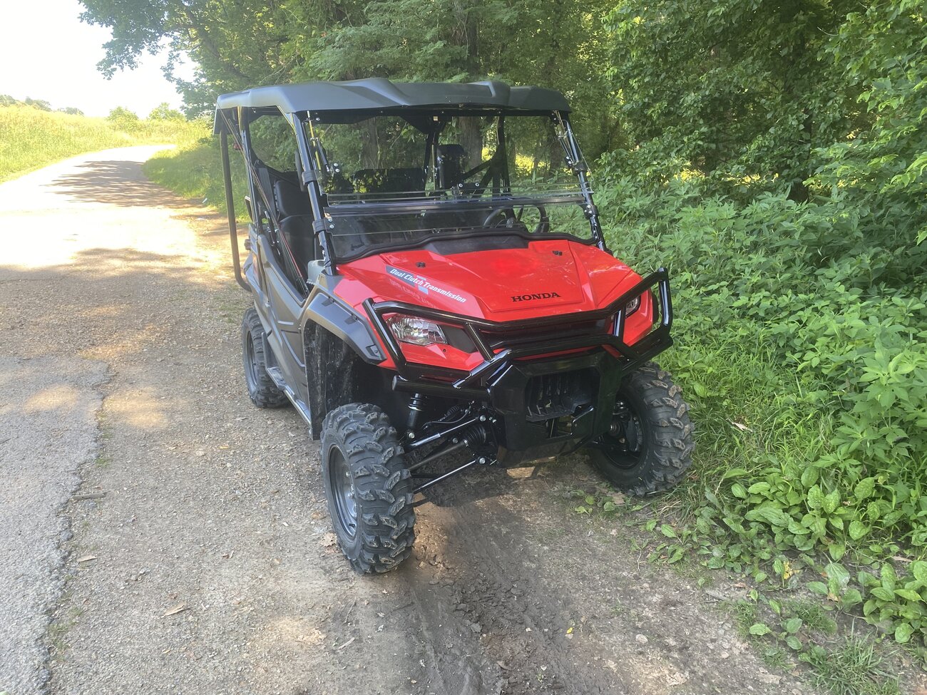

I just got my pioneer two days ago. Put on the roof, windshield and bumper. Put a hundred miles on it so far to break it in and I’ve had a few problems. First the fan never comes on and it’s overheated twice. Second it won’t go in any other mode but turf, two four and diff lock won’t work. I’m guessing that they just didn’t plug in the fan or hook up the cable to the transmission, but I’m wondering if anyone else has had these issues. Other than that I absolutely love this rig!

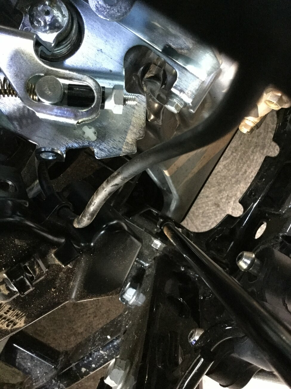

This is what the rear diff adjuster looks like. Its mounted right at the rear diff under a plastic cover. That should fix your drive problems. It sounds like the fan is either disconnected or maybe a fuse blown. If you don't have a service manual get one, it will help you learn all about your new machine. Nice lookin unit.
