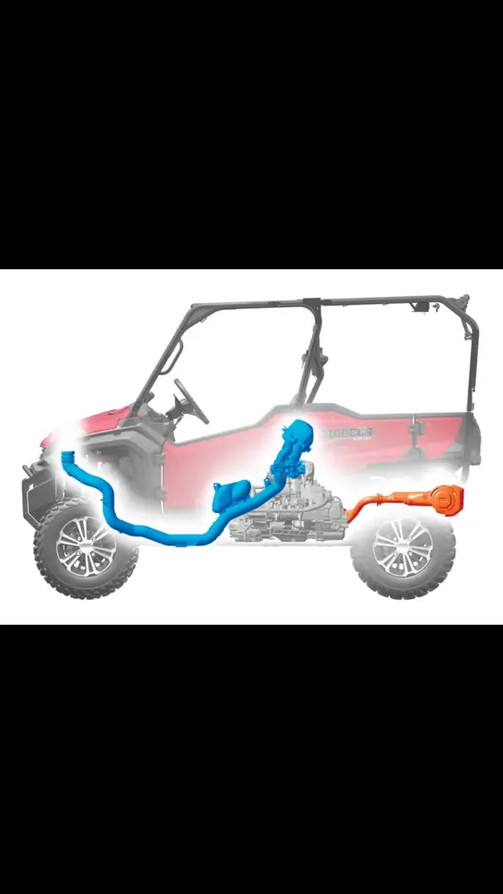

Seems we have some non-believers cumminsPusher, but so far your theory is the only one that holds water.
I know from my clearing my irrigation with a compressor that air and water in pipe under pressure can do some weird stuff. Just when I think the pipe is clear I get one more blast of water.
This factory snorkel with "trap" is real concern for me.

Here is a picture of the system. That lower section is the one I'm talking about. This is the same one that the Honda tech and I found.
Looking at this pic why not bypass the hood intake all together and snorkel right out of the airbox straight up behind the seat?
That would solve the water problem but there can be a lot of dust and debri floating around back there. But at least we know the filter will stop all that.
Reactions: CumminsPusher
39,130
Some people have done that, that is a very good option to have.
I think @Delton has that set up.
