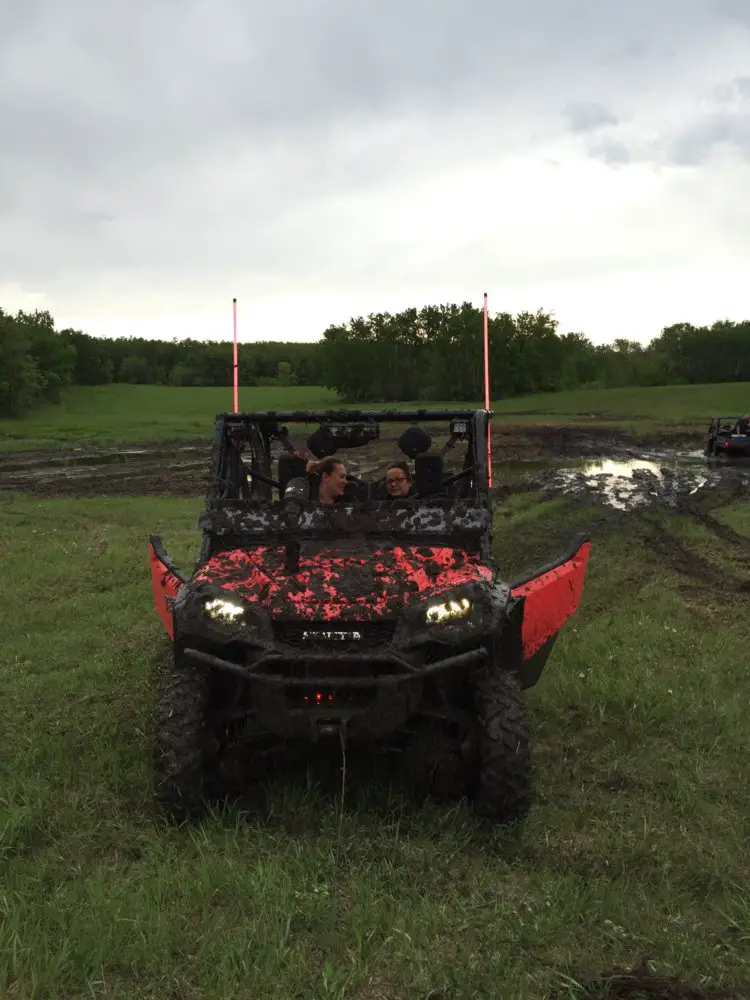

As many of you know My Pioneer inhaled some water last weekend from just a puddle that we had run through a bit too quickly and and came out dead. I brought it into the dealer on Tuesday they said they'd look at it as soon as they could they were backed up. Got the call yesterday that the dealer had been broken into and my rig was one of the two that was vandalized. Went in yesterday to help with the police report and found my main lightbar was stolen and wiring going into my front roll bars cut which is a lot. To add to this I received the phone call 30 minutes ago from the manager saying "catastrophic failure on motor and transmission". Warrentee will not cover it being water related. Rough day guys!

We were looking at it and I asked what if it takes on a little water here and there till it fills up and sucks up large amount into the intake that may explain how so much came in and sucked past the filter he agreed that may just be possible. Water could collect there over days even weeks because it would be slow to evaporate. That's all I've got
Yeah - when I first saw that snorkel pipe go back and down then back up to the airbox, I wondered how that could be great.
Your description reminds me of snorkeling at the beach with a leaky snorkel. I'd blow out the water, then it slowly accumulates and gurgles till it gets enough to block the passage of air - then all of a sudden I get a mouthful of salt water.

With the engine speed up there is a lot of pull at the inlet. Did it stall right away? I'm surprised the Wolverine didn't get water in the intake but the intake is way back and up much higher. It can't hurt for your dealer to ask for some good will warranty even if its just the parts and they can show Honda the video. Honda can't get any better testing for water crossing at speed and it wouldn't take much of a mod for an improved location on future models. From the tube it could be routed up and way back over the 2nd battery location and facing to the rear. Good luck with the repair.
Instantly. That would be a better spotJust hoping things go through.

Did a pressure test on mine yesterday. It would hold pressure as long as I wanted it too.
How did you do a pressure test ? Plug off I take under hood
Bayouownbeer
Bayouownbeer
Jun 3, 2014
798
1,123
Chauvin LA
Chocked it down. Found a pice of rubber sheet. Use that and placed over the intake tube under the hood. I was actually surprised how long it held.
Ok so you killed the engine with the rubber and left it hold a suction
18,683
68,346
Yes. And it held for more then minuet before I removed it.
Figured that showed it was fully closed air track. If there's was a decent leak it would not have held long.

Should be able to handle deep water with a snorkel just fine. There is either an issue with the stock intake or damage somewhere.
