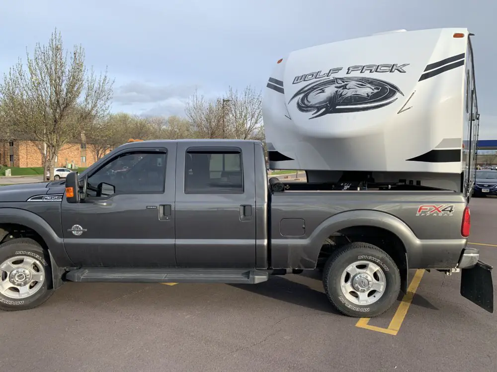

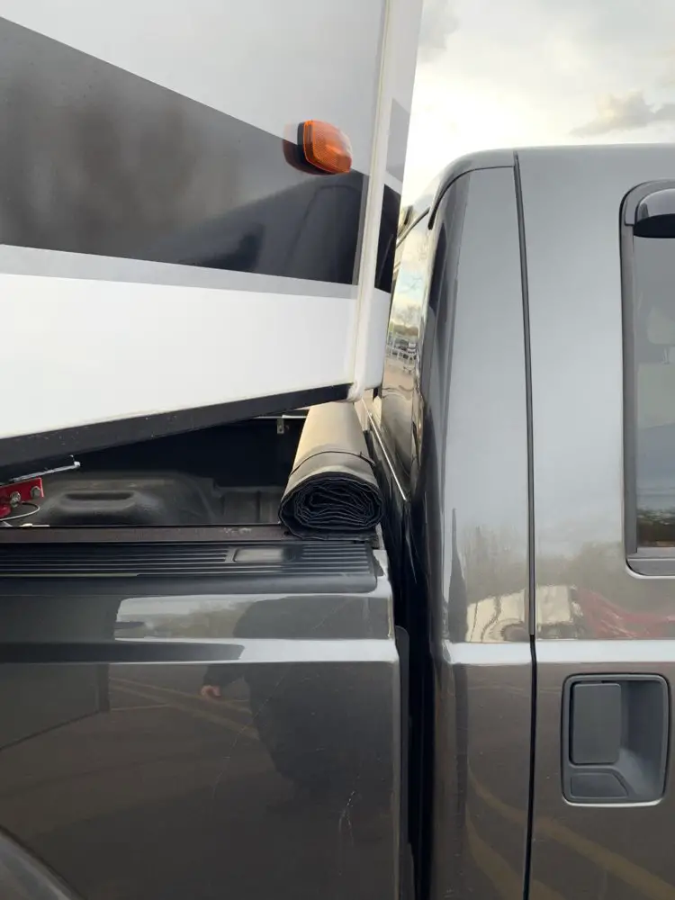

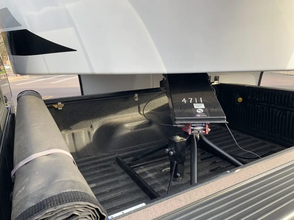

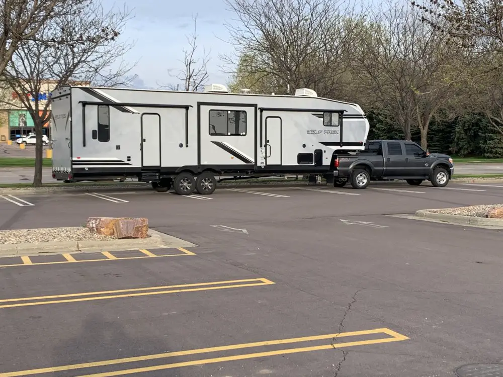

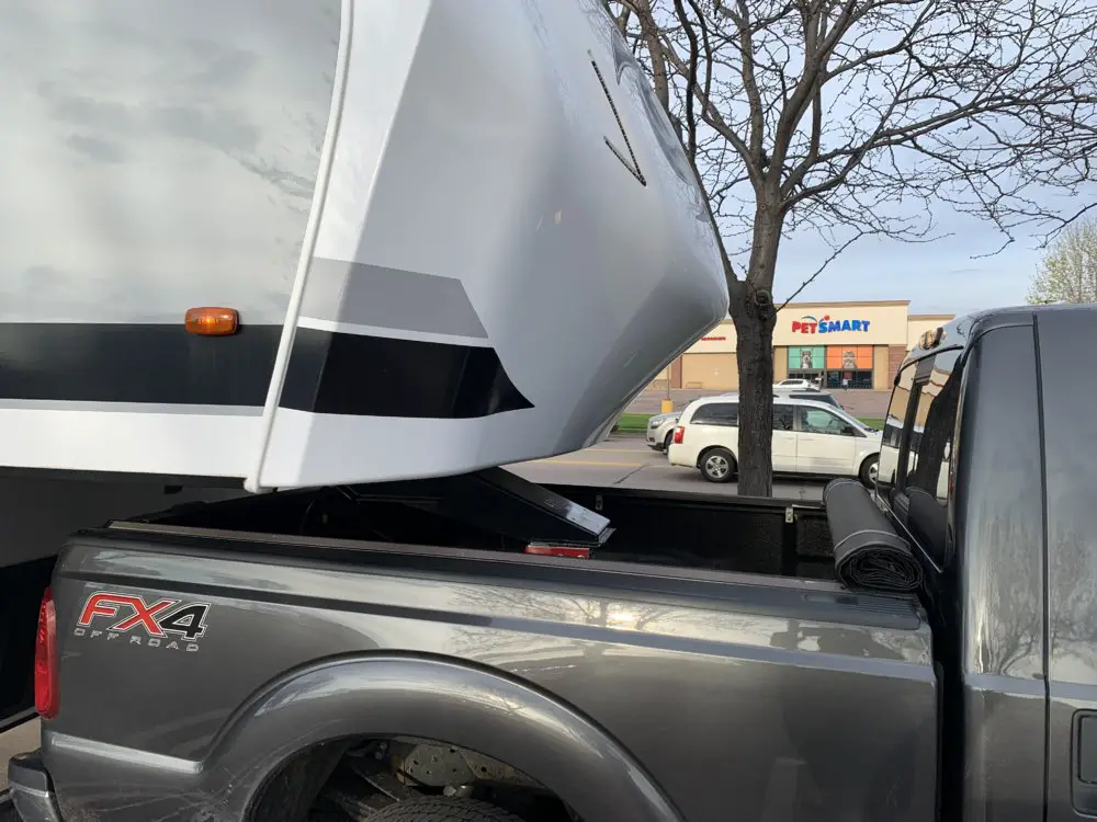

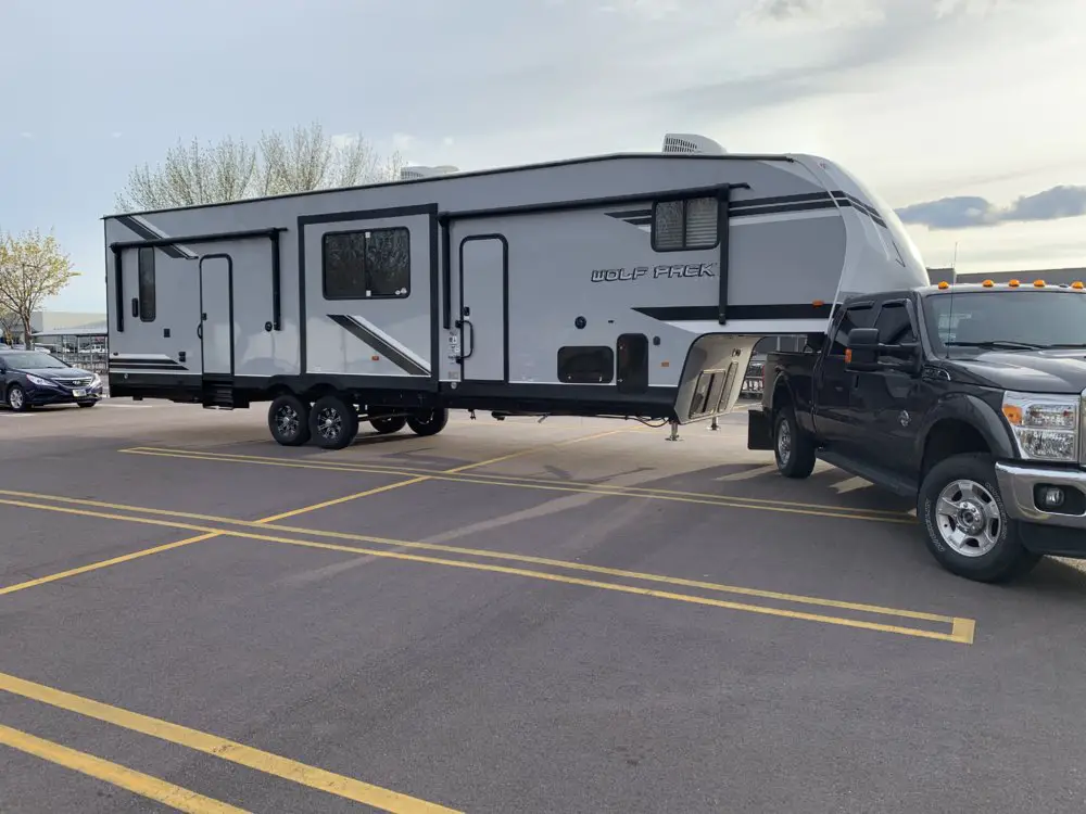

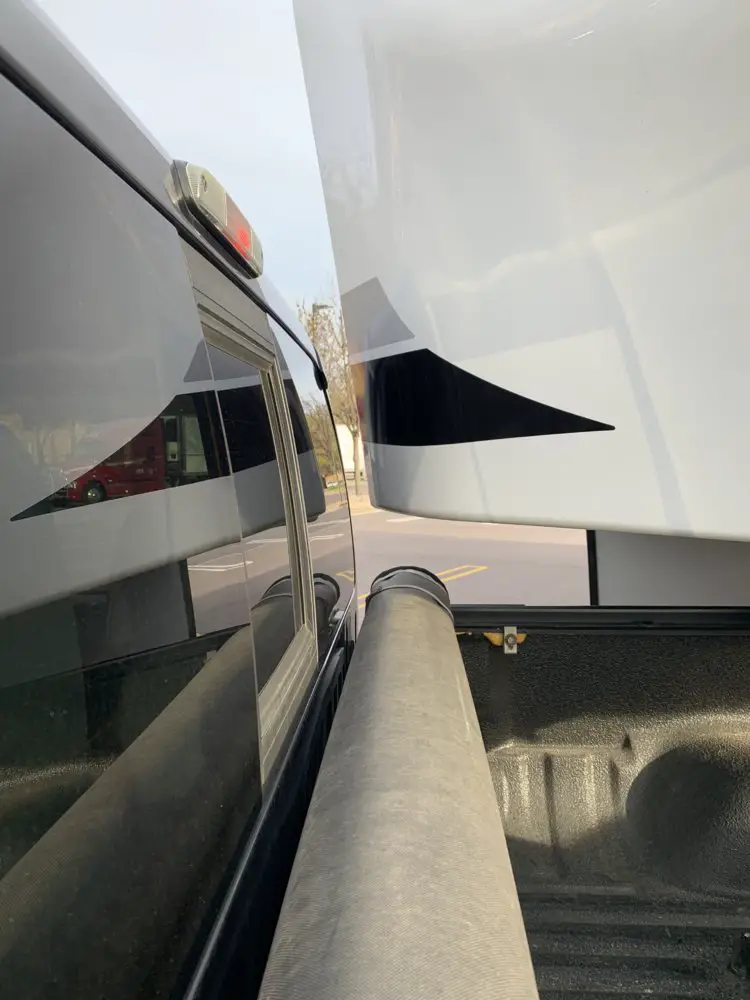

I was mistaken. With the Wolfpack at 102 wide, I can’t quite make 90 with the AUH over the standard gooseneck mount..it’s super close. My 2017 Crossroads could, but it wasn’t 102 wide either.

I’ll be putting back on my 5” offset gooseneck ball and sliding my AUH back just to be safe.

View attachment 128434 View attachment 128435 View attachment 128437 View attachment 128438 View attachment 128440 View attachment 128441
View attachment 128442 View attachment 128439
So, did you have to back up to get the truck and RV in that attitude??? Moving forward and all the way to lock, you could never get there, right?
That red apparatus connects to the king pin and then connects to a ball on the AUH??
And the AUH drops into the Ford Puck system??

Yes I had to back to this position. I’ve never been able to do this by simply going forward and turning in a circle.
Yes the red part clamps to king pin. This is the part that I mentioned could be moved in front of the king pin or to the rear. A cable operated detent pin keeps the red socket on the ball.
This AUH is a steel gooseneck Hitch. It clamps onto the gooseneck ball of the tow vehicle. It doesn’t drop into the ford pucks, it uses the gooseneck ball.

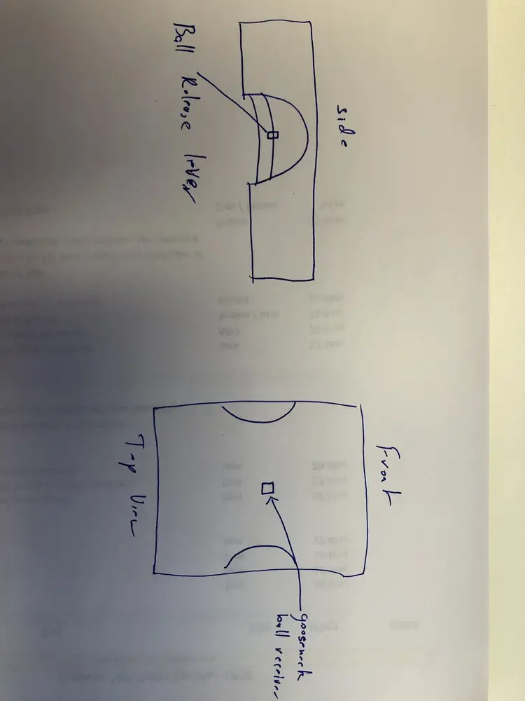

The turnover ball kit is B&W’s gooseneck system. It looks like this
7cdec4bc4ceda9662e7113360a402da8
The Companion is B&Ws high load, top of the line fifth wheel hitch. They make a version that attaches via the receiver for the turnover ball system (which will not work for you) and OEM pick system versions - one of which will work for you. It attaches to four of the five pucks in your bed.
