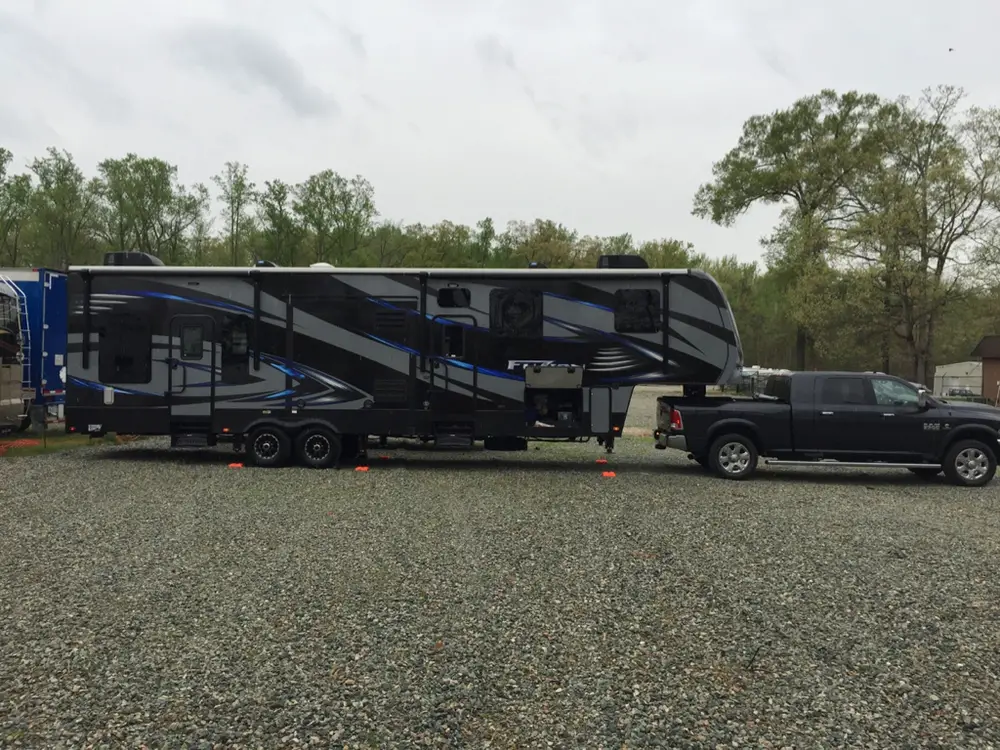

Not the best picture but can go to 90, although I’ve rarely had to. Reason I say I’d go with a long bed truck and a Hensley trailer saver hitch is if you tow a lot, the roads really put a pounding on your rig. I looked at air pinboxes, but they didn’t make an air cushioned sidewinder rated for 17k or higher
If you go with a sidewinder, you cannot go with a non puck b&w hitch as you could possibly have two points of rotation. Is also look at the updated pulleitw superglide. Reason I didn’t got with a superglide was at the time they didn’t make a puck version and you had to use a picture frame adapter which raised the hitch 2 inches....and the new trucks are already quite high
