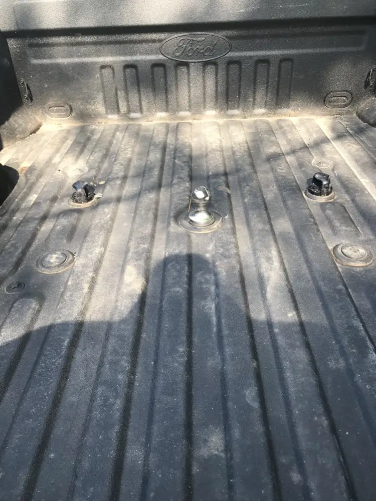

That may work provided the measurements plus 10” will still rotate inside your truck bed.
You mean the pin box hitting the tailgate and bed rails???

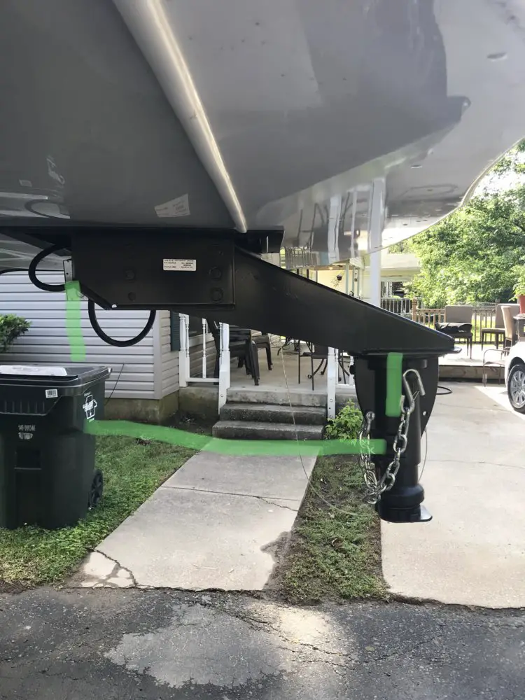

Actually I’m hoping they have a 5” offset inner tube which I believe will be sufficient. Honestly what I’m trying to achieve is the ability to turn lock to lock when going forward, whatever that would translate to, probably 70*-75*????
That measurement is 32”....
So......it looks like that gets me to 80*-85* as things are without hitting bed rails, which I believe would be lock to lock on steering. But would be reduced drastically with that 10” offset inner tube for the gooseneck.......defeating the purpose.

The ONLY gooseneck adapter allowed by Lippert is the Reesegoose box.
All the others have been well documented to tear up fifth wheel trailers and should be avoided at all costs.
Been there done that. Plz learn from my experience. 5th wheels are not constructed like traditional gooseneck trailers. The pin box cannot handle the moment placed on it by these adapters and will crack the frame without serious modifications and reinforcement of the pin box mounting flanges and frame.
A simple google search for Ranch Hitch Failures will yield many pages of pictures of the destruction.
I had a Ranch Hitch on a 2008 Fleetwood fiver. It was the most chucking worthless pos ever made. You could see the flex in the camper as you went down the road.
Never ever again.
I have a Goosebox on my 40' Columbus and love it. Very few gooseneck hitches offer an airbag on them. It makes a big difference in the ride. Most manufacturers will not warranty the coach if you have installed an aftermarket gooseneck assembly on your 5er. You'll notice on a true gooseneck equipped trailer, there's additional gussets welded to the frame for the added stress. Bolting a gooseneck hitch to your fifth wheel hitch is not enough.
