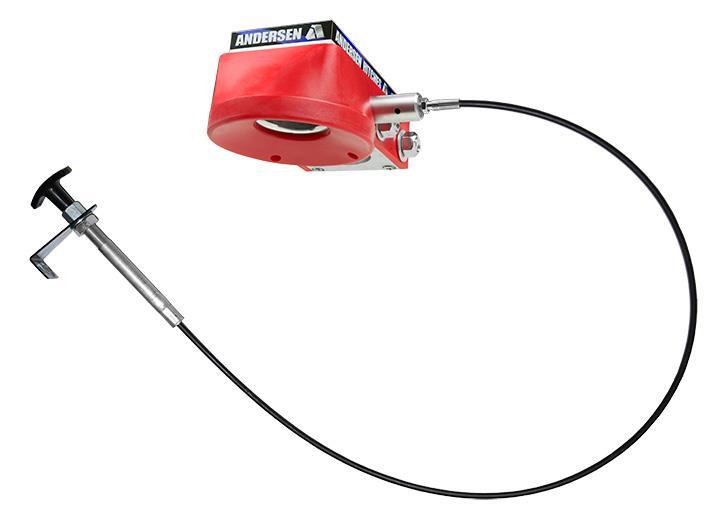

I have a 07 Dodge 2500 Cummins with the 8' bed with a big tool box in the front. The Andersen hitch has the ability to turn the hitch coupler to gain a little more room. But in the directions it talks more about changing this so the pin box doesn't hit the bed rails or tail gate. My only complaint is that it takes a little longer to hook and unhook because you have to lift the trailer up completely off the ball, vs just taking the weight off. I sure hope you find something that will work and glad you are staying away from the gooseneck adapter. Here is a pic of the hitch coupler for reference. It can be in front or behind the king pin.
