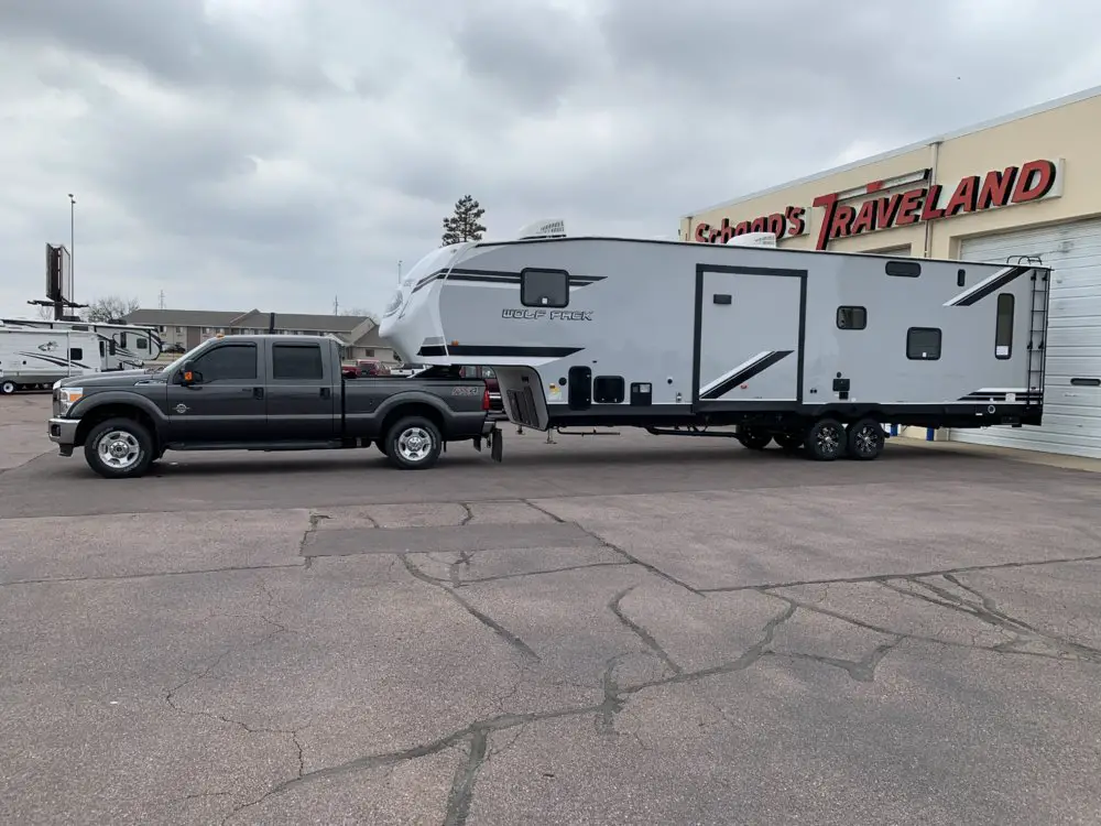

In the pic below the camper is resting on the steel AUH with the 5” offset to the rear.
This rig is a 325pack13.

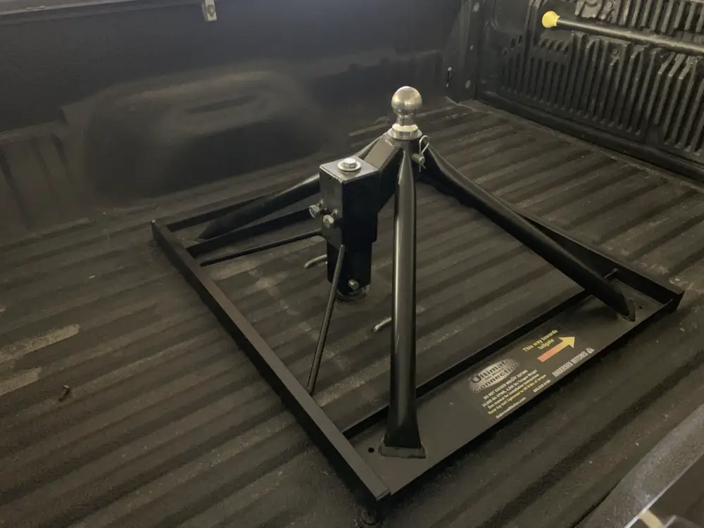

Here is the hitch installed with out my 5” offset. I’m still working on the right setup. You can see the dirt shadow of where the hitch sits with the offset.
Is this your preferred recommendation?

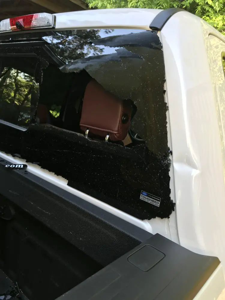

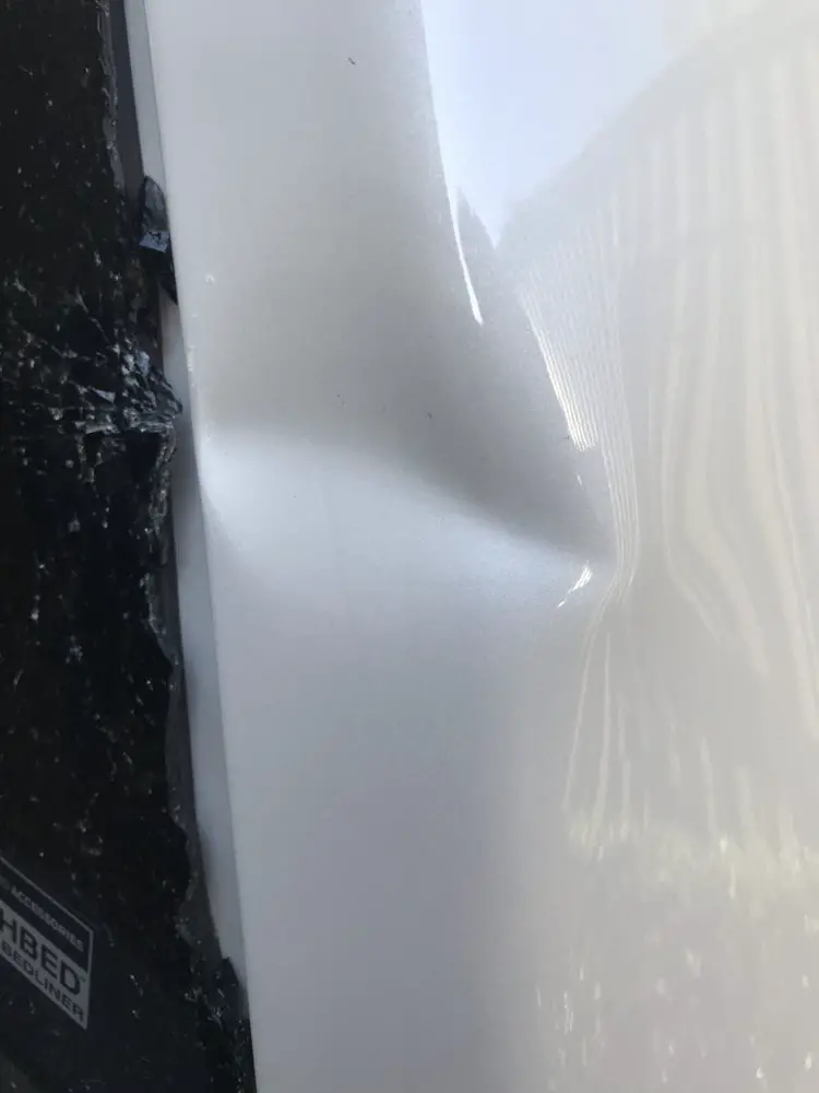

Hay @Montecresto sorry that happened to you. One of the reasons I only buy an 8’ bed when I’m pulling my 5er. The other reason is the short bed bucking, better with bags in the back but still did it. I always had 8’ Bed trucks and one time I let my wife pick out the truck and it was a short bed. Delt with it for about 3 years and I’ll never do it again. I know you can’t change that now.
I had the drop in Reese slider for my short bed superduty. Heavy but took some worry away. I transferred it to my 15’ (8’ bed) it’s a nice hutch and I just keep the slider locked in. I use a chain hoist in my barn to get it in and out of the truck. Easy in and out. For what it’s worth, my buddy has horses and has horse trailers. He did the goose neck with an expensive adapter with his 5er for a while He liked it but complained about no forgiveness unlike the horse trailer and sometime later you could see in the bed where it was tearing some of the bed apart. I hope all goes well with your repair.
Yes or the Reese goose box.
