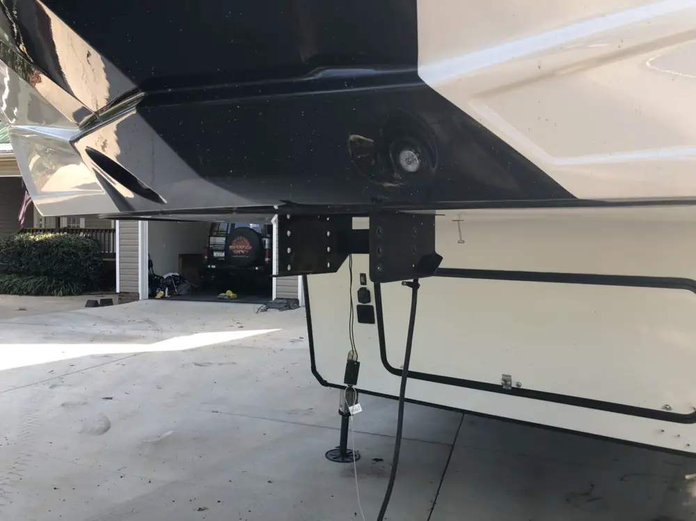

Height adjustable, yes.
Pushes back a little yes. If you have the pick system you don’t have a choice of an offset ball like I do . This adds another 4” offset
70b030f9ad0280e3c9b61b320c39a958
I have to get to about 85 degrees to back into my driveway and I am close but OK

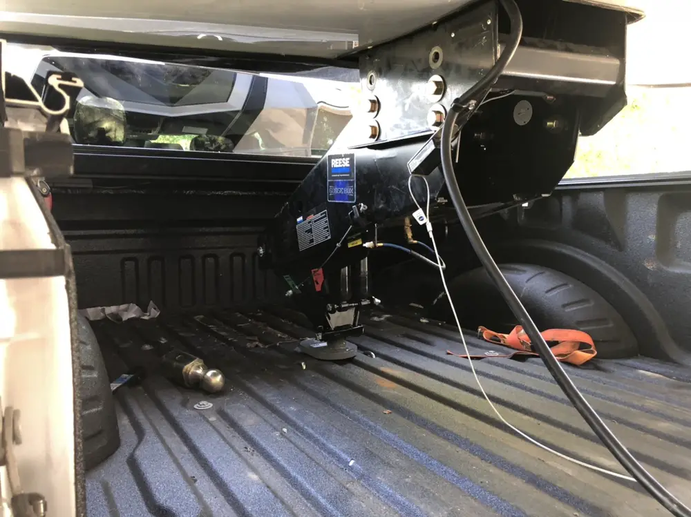

That is the same offset adapter I used on my AUH with my old camper. The pic I placed earlier is without it and how I towed my camper to the dealer this past Saturday. When I pick it up I will try full 90 turns and report back with measurements.
I don’t have the ford puck system. I have a modified Drawtite hide a goose system. Similar to B&W.
The offset adapter may make the difference. The only way to tell is to re hook your rig and have a buddy help you in a parking lot. See where you are at and then see what moving the pin back with a tape would look like.
When you crushed your cab, were you in a situation where the truck and trailer were in a V shape (front truck and trailer tires higher than rear truck tires)? This is something to watch for as well.
