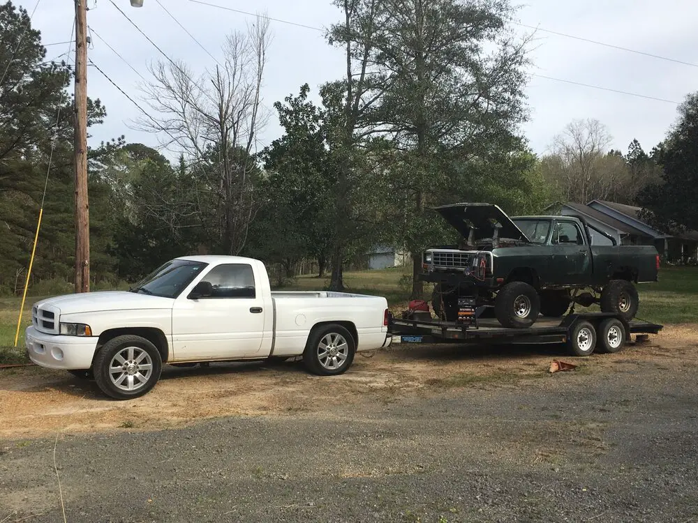

My youngest son came over this weekend and he said he had a Quadzilla Adrenaline tuner on his Cummins. He can download different fuel maps and he has an app on his phone that shows a gauge cluster with all the pertinent info. When it looks at the pyrometer it will defuel if the temps get up to your setting. He also has a 3 gauge cluster on his A pillar. He has a 24 valve short bed 6 speed and added a set of 200 or 225 hp injectors. It's a white sport model now! It has the Air Dog fuel supply.
IMG 1442
That is a sharp looking truck!
