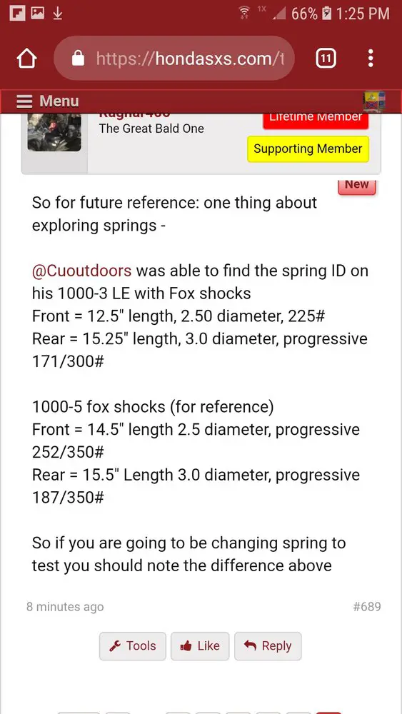

Screenshot 20190426 132503 Chrome
That's a screen shot I saved a couple of years ago. Take that info and try to figure out what you want to do to improve it. Most of the guys on here that have done the spring change don't post anymore. I know that I used a 300 lb spring in the rear from summit racing. It was only 14 inches long instead of 15.5 inches.

I put 14” 2.5” diameter 250lb springs on front and 14” 3.0 diameter 300lb springs on the rear, ride is great. I bought springs from summit racing, cheapest I could find that they had. I set preload at around 1.5“ for both.

Thanks, this is the starting point I was really looking for. I think I burned up 2 calculators on spring rate math. I'm trying to build a trail shock. In winter plowing season I will put the factory back on. My main goal is comfort and flex.
