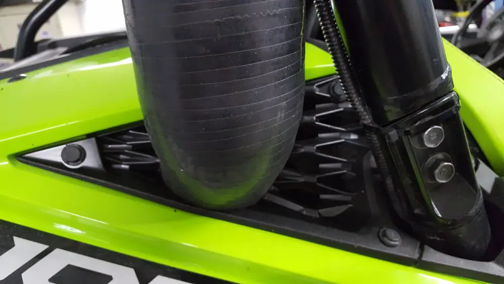

Just messaged s&b about the tube and bezel for the vent outlet. They must’ve caught wind of using it for homemade snorkels, told me they won’t sell the parts separately anymore. 🤦🏼‍♂️ So looks like I’m gonna be trying to fab up a vent outlet piece something like their setup. We’ll see how this turns out. 😂🤞🏻
Well that sucks. Really the only piece that made it all look oem is part #4, the side cover. Someone with a 3D printer needs to market those.
Even just the triangle with a small section of tube on both sides would work and just attach the tubes with the silicone bands. Now just to find someone that would do that lol.

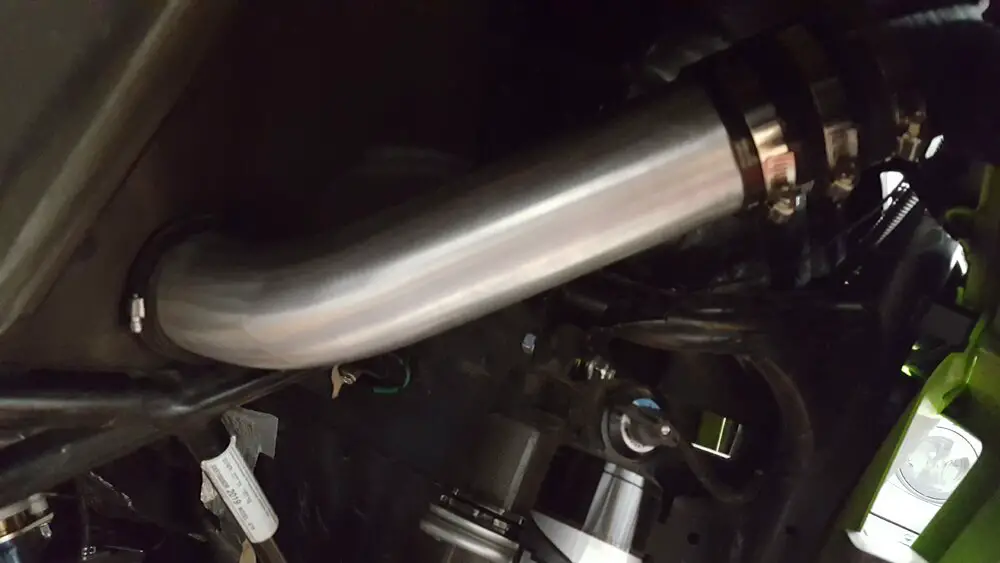

Just use a hole saw in the stock vent. Something like this...
20191109 233052
Then joint to the airbox with a 45 degree 3" aluminum tube like this...
20191109 233059

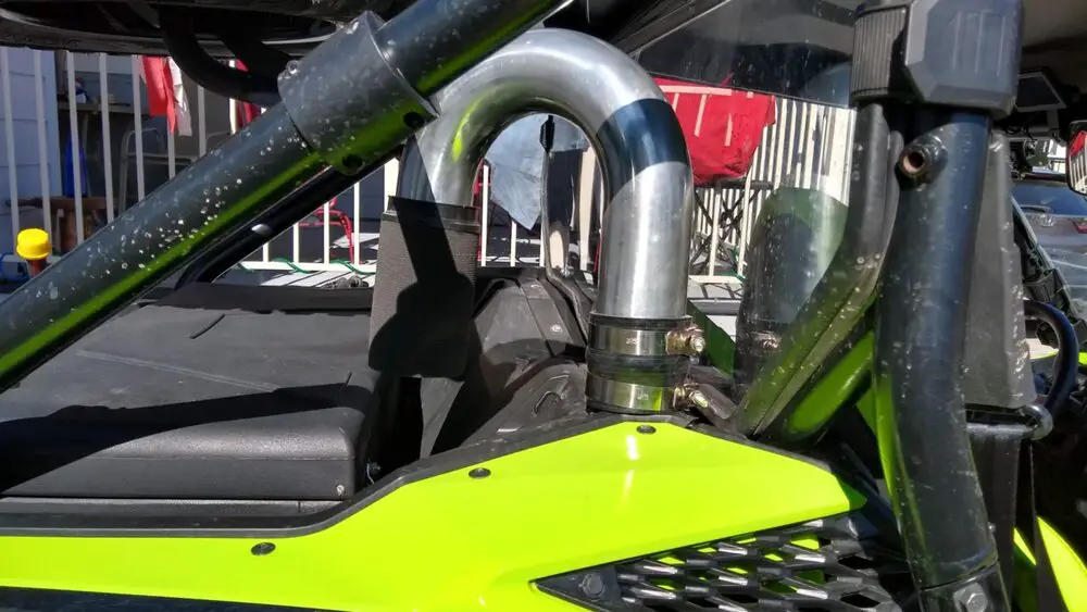

I did keep the stock intake chamber, copying HondaBob's snorkel idea but not running up to the roof, quit behind the passenger seat (details in the thread linked in my sig).

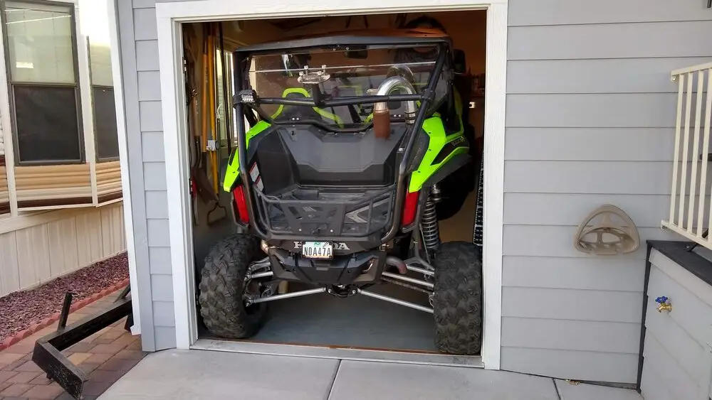

I've been away from my Talon for over a month now. But my wife and I don't recall hearing intake noise at all. If there was any, it was drowned out by all the other machine noises. I have a rear windshield which probably helps. I didn't remove the existing intake system. I just extended it out behind the passenger seat.

View attachment 274721View attachment 274722
Damn.. that's a tight fit in the garage !
Doogle
Doogle
Nov 30, 2020
216
312
Surprise,Az Cincinnati,OH
Too tight. I had to leave it outside for the summer. I thought I could lift the front enough to get it inside. No go because the rear angled out as I raised it. Next year I'll try lifting the rear from inside and hope it fits.
