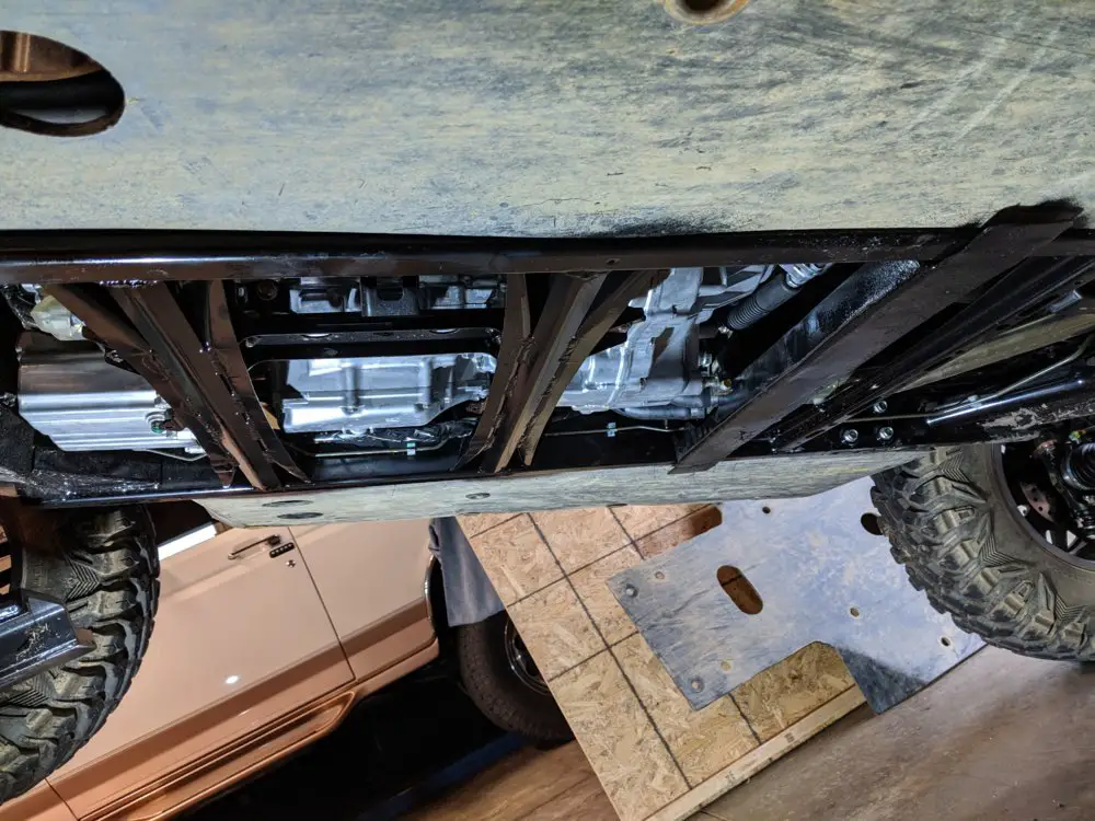

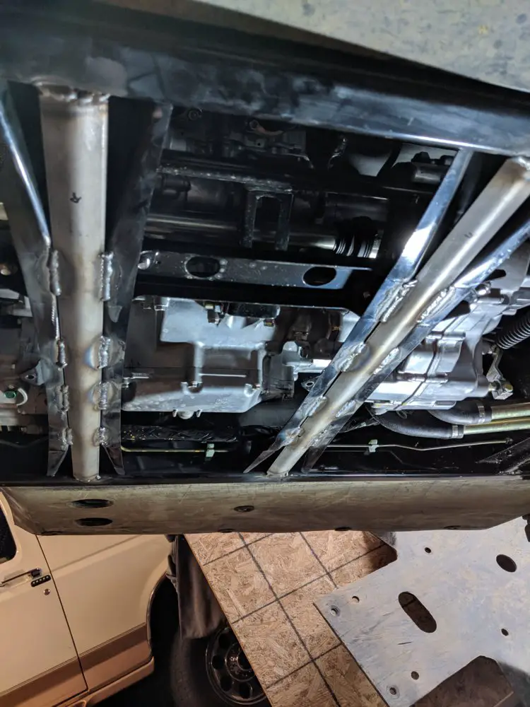

Straightening out the crossmembers...gonna have to reinforce them soon...too many irons in the fire right now though..
View attachment 133427 View attachment 133428
I used the same kind of steel as Joey I think its "1080" or also referred to as cold rolled..... I think Joey used 3/4" square and it worked well. I went to my local welding shop and all they had was some 7/8" solid round. I lucked out and It fits perfectly in the groove and sits flush with the frame.
